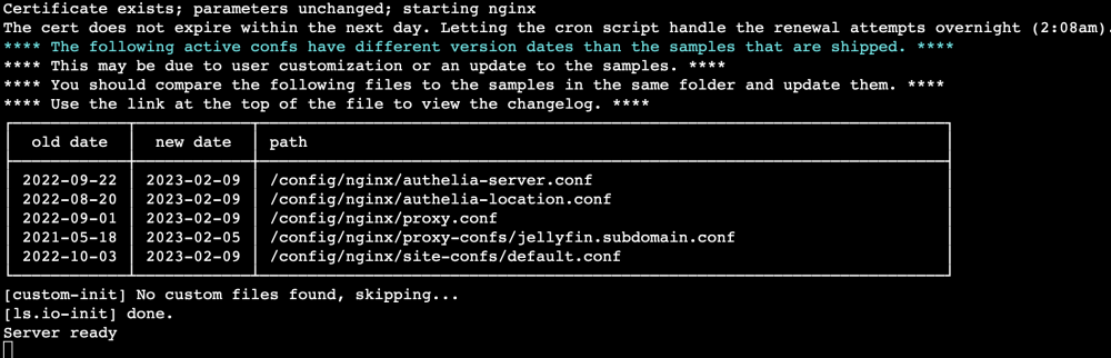

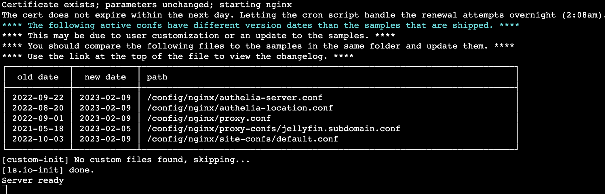

Any idea why each swag update breaks my remote jellyfin? Out of the 5 files mentioned in the screenshot, only one I edited was jellyfin.subdomain.conf
I have 2 servers and both died so I tried this. On the first one I replaced all files with new ones starting from the bottom and it was dead until all 5 were replaced with samples and old ones renamed to old. On the second one I started from the top and as soon as I replaced first two authelia server was back online. On that 2nd server I still have warning about /config/nginx/proxy.conf, /config/nginx/proxy-confs/jellyfin.subdomain.conf and /config/nginx/site-confs/default.conf but jellyfin works just fine.
Is there something I need to do so swag update doesnt mess it up each time?
