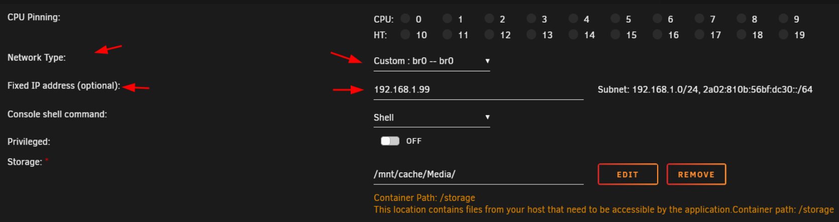

But this is to set up "internal" docker IP, isn't it? What I'm missing is how to assign additional docker host IPs, and how to steer containers to bind only to particular host IP (from those additional ones). Or am I mixing it all completely?
4 hours ago, alturismo said:
also, this is not swag docker related, rather post or search in the general part/s.
I know, and apologise. I wanted to start new general topic in Docker Containers forum, but there is no way to post there. Please move my questions to whatever place it fit best.
Also - many thanks for helping me :).
nope, this is what you would like todo, let the docker run on its own network stack on a sep ip in your LAN enviroment ...

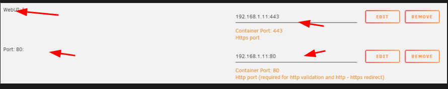

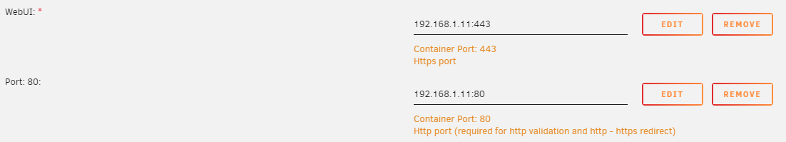

OK, I figured it out...
First I needed to add additional 192.168.1.11/24 IP to default br0. Currently I'm doing in using sh commands, but looking for a way to make this change permanent, in a proper Unraid way - asked a question here.
Then, in SWAG settings (or any other container) I defined the following port mappings:
and voila - I have SWAG listening on 80/443 native ports, on dedicated IP.
tcp        0      0 192.168.1.11:443         0.0.0.0:*               LISTEN      8444/docker-proxy
tcp        0      0 192.168.1.11:80          0.0.0.0:*               LISTEN      8456/docker-proxy
Easy enough, all works like a charm :).
Any disadvantages of this solution I should consider?

Previously it was listening in 192.168.1.10 ports 180/1443. Now it listens on 192.168.1.11 ports 80/443, as I wanted it to... How it is not affecting it anyhow? I must be missing something...
as mentioned ... THIS is what your container makes it listening on .11 (just different ip there, here its listening on .99 while Unraid ist on .2)
port mappings down under are useless as obsolete ... but lets quit this now as it is not swag related at all, basic docker setup ...

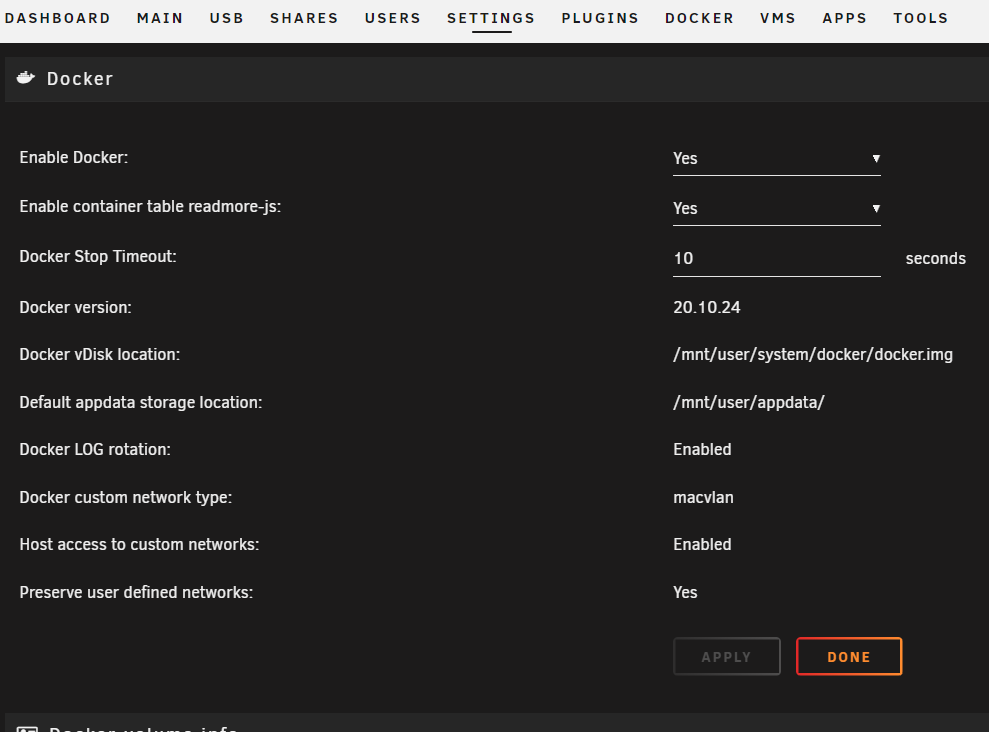

can you ping the other dockers from swag console ?
is host access still enabled in docker settings ?
may restart docker service in terms you had a reboot between too ... known issue .... with enabled host access.
dug a bit deeper on it and seems like its unraid networking related to the vlan bridge I have on an interface not routing properly. Disregard please (sorry I deleted the question before I saw a response).
and yep... cycling the docker service did the trick :)
