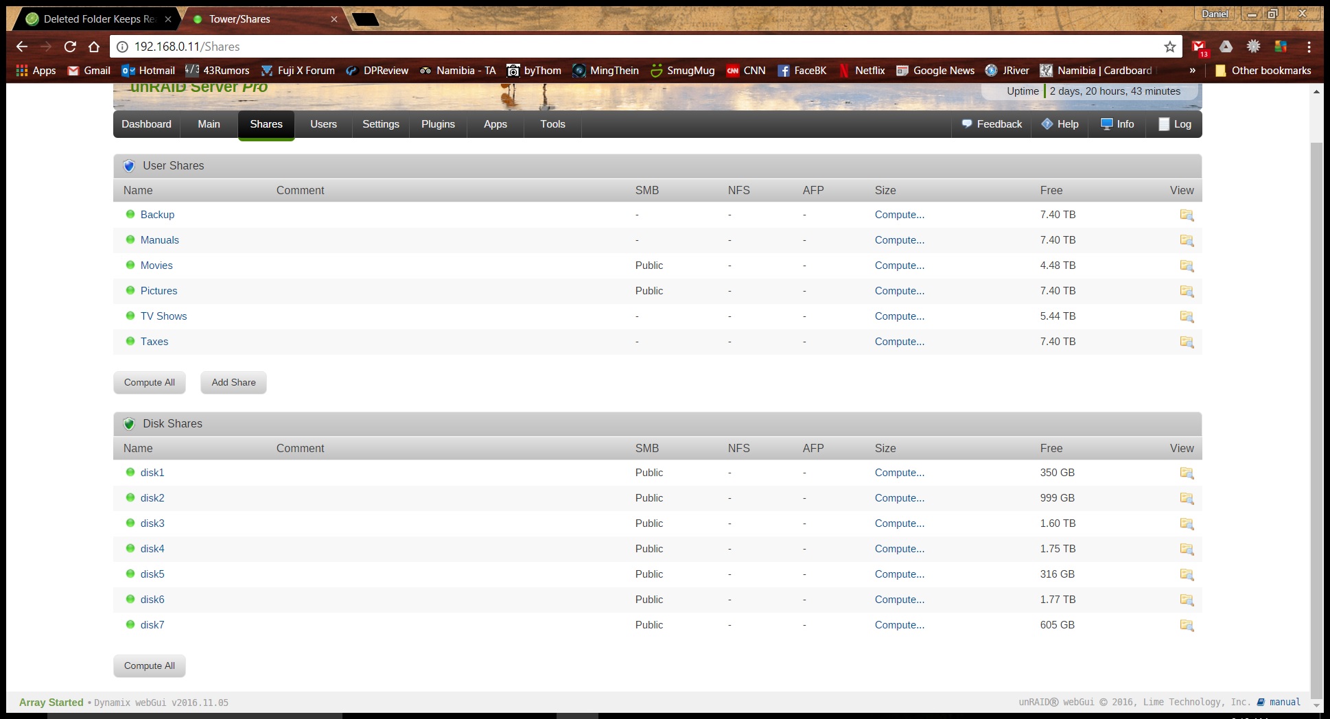

As far as I know I have user and disk shared.  It's not like I actually did anything.  Attached is what I see when I go to the Shares tab.
I'm assuming the disk shares are there by default.
For ex, my new disk 7.  After adding it to the array, it just shows up under disk shares.  Which I assume is normal.  Then I created a folder on it via my Windows PC and called it Movies.  Then I started copying files from disk 6 that had a share/folder called Movies to disk 7 Movies folder/share.
That's pretty much how I did all my folders. If I'm doing something wrong or have screwed something up, please let me know.

If I do that, if I browse to disk 6 via my PC, would I then see a folder/share called disk 6?  I'm assuming I can then just copy files to that share/folder?  Now if I end up deleting all the files that reside on the disk 6 share Movies, then go to the Webgui and for the share remove disk 6 so it only includes disk 7, the Movie share will be gone from disk 6.  Is that correct?
Disks are not shared by default. In Global Share Settings, you can enable disk shares, but they are disabled by default to prevent users from accidentally encountering the User Share Copy Bug mentioned.
You should use the webUI to create and configure user shares, but if you create a folder at the top level of cache or any array disk, it is automatically considered a user share with default settings, and those default settings may not be what you want.
If you create a user share in the webUI, a top level folder will be created on cache or array disk as needed and in accordance with that user share's settings.
Any user shares that you have already "accidentally" created by creating a top level folder on cache or array disk do not need to be created again, but you may want to make settings for those shares if you don't want the default settings.
And any changes you make to a user share's settings only applies to future writes to that share. If you set it to not include disk6 for example, that just means it won't write files for that share to disk6 anymore. It will have no effect on folders or files that are already on disk6.
And you absolutely must avoid mixing user and disk shares when copying or moving files (unless you really understand what the user shares are doing that causes the "bug" and know exactly what to specifically to avoid).
After you are done rearranging things it would be best to go to Global Share Settings and disable disk shares. I never use disk shares and I completely understand the User Share Copy bug. If I want to move things from disk to disk I never do it over the network but instead go to the command line (actually Midnight Commander).
