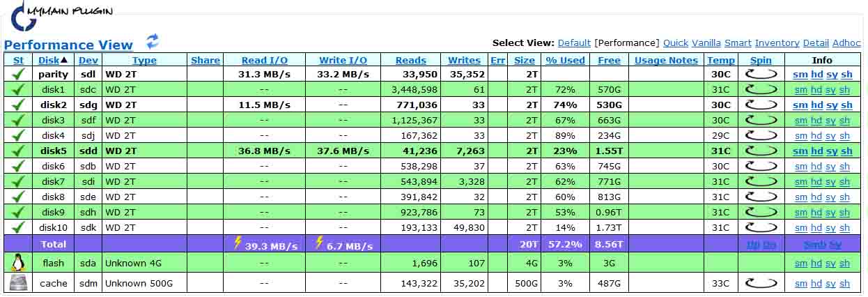

ls -l /boot/unmenu/images
(we expect the "images" directory to have been created and in it a "stock" sub-directory with most of the image files.  The image directory is new with the new release of the myMain plugin.
root@Tower:~# ls -l /boot/unmenu/images
total 160
-rwx------ 1 root root 120047 Dec  6 10:45 MyServer.jpg*
-rwx------ 1 root root  33072 Dec  6 10:45 MySlots.jpg*
drwx------ 2 root root   4096 Dec  6 10:45 stock/
The older unmenu_install program had no concept of dealing with sub-directories.  For that reason a new version had to be developed.  To see if you have the new version, type:

As I said in my earlier post, the images sub-directory needs to be linked to the /var/log directory for the image server to find them  That "link" is only made once when you first invoke the myMain
plugin.  To force the "link" to be created you can type:
rm  /tmp/mymain_seq.txt
and then refresh the myMain web-page.  (much simpler than rebooting the entire unRAID server)

OK.. so the issue may be where the stock folder is then.. as mine is under the "images" folder e.g. /boot/unmenu/images/stock
ls -l /boot/unmenu/stock returns:
root@Tower:~# ls -l /boot/unmenu/stock
/bin/ls: cannot access /boot/unmenu/stock: No such file or directory
I'm going to assume this may be a typo and you missed the images folder out of the command and continue with the other tests:
I did this, and refreshed the mymain page, and unfortunately still no images!  I must be doing something simple wrong, i'm sure of it!!
The output shows that the /var/log/images directory is linked to /boot/unmenu/images.  That is correct.
I don't see anything wrong you've done...  not so far anyway.
What do you see when you type:
ls -l  /var/log/images/stock
Also.  what browser are you using?  (probably has absolutely nothing to do with anything, but just figured I'd ask)
Joe L.

Hi Joe, thanks for continuing to help!  Heres the output of that command:
root@Tower:~# ls -l  /var/log/images/stock
total 588
-rwx------ 1 root root   1640 Dec  6 10:45 Hitachi.png*
-rwx------ 1 root root   2914 Dec  6 10:45 Kingston.png*
-rwx------ 1 root root   5803 Dec  6 10:45 Maxtor.png*
-rwx------ 1 root root 120047 Dec  6 10:45 MyServer_sample.jpg*
-rwx------ 1 root root  33072 Dec  6 10:45 MySlots_sample.jpg*
-rwx------ 1 root root  71228 Dec  6 10:45 Samsung.png*
-rwx------ 1 root root  10141 Dec  6 10:45 Seagate.png*
-rwx------ 1 root root   2831 Dec  6 10:45 WD.png*
-rwx------ 1 root root   2673 Dec  6 10:45 bolt.png*
-rwx------ 1 root root   1522 Dec  6 10:45 down.png*
-rwx------ 1 root root  11077 Dec  6 10:45 myMainLogo.jpg*
-rwx------ 1 root root  24936 Dec  6 10:45 refresh.png*
-rwx------ 1 root root  11917 Dec  6 10:45 refreshall.png*
-rwx------ 1 root root   1102 Dec  6 10:45 spinning.gif*
-rwx------ 1 root root  19845 Dec  6 10:45 status_bt.gif*
-rwx------ 1 root root   9225 Dec  6 10:45 status_cache.png*
-rwx------ 1 root root  18677 Dec  6 10:45 status_dsbl.png*
-rwx------ 1 root root   3227 Dec  6 10:45 status_dsbl_new.png*
-rwx------ 1 root root  18677 Dec  6 10:45 status_dsbl_np.png*
-rwx------ 1 root root   2577 Dec  6 10:45 status_invalid.png*
-rwx------ 1 root root   2219 Dec  6 10:45 status_mt.gif*
-rwx------ 1 root root   3391 Dec  6 10:45 status_new.gif*
-rwx------ 1 root root  80213 Dec  6 10:45 status_np.png*
-rwx------ 1 root root  80213 Dec  6 10:45 status_np_missing.png*
-rwx------ 1 root root   3418 Dec  6 10:45 status_ok.png*
-rwx------ 1 root root   3391 Dec  6 10:45 status_raw.gif*
-rwx------ 1 root root   3254 Dec  6 10:45 status_wrong.png*
-rwx------ 1 root root   1433 Dec  6 10:45 up.png*
root@Tower:~#
I'm using Firefox, but have also tried IE8.
What version of unRAID are you running?
I see that the permissions on the files in your images/stock directory make the images readable only by root on your server, and on mine they are readable by anybody.
Is the /boot/unmenu folder on your flash drive?
Something about your server is making the permissions on the downloaded files in the images directory different.  Perhaps you'll be able to describe what might be different?
In any case, it is easy to see why you do not see the images on the web-browser.  The unMENU image-server is being run as user "nobody" and therefore would not have permission to read the image files on your server.  (they are currently only readable by user "root")
The solution is to make your image files readable by all (and the directories search-able by all too).
Type the following commands and odds are good you'll see the images.
chmod og+rx /var/log/images
chmod +rx /var/log/images/stock
chmod +r  /var/log/images/*
chmod +r /var/log/images/stock/*
Joe L.

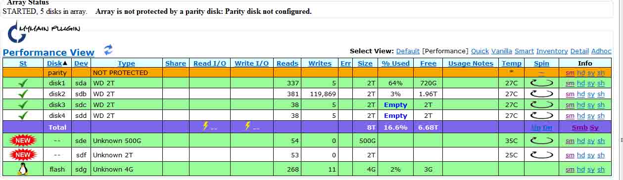

i have just setup a new box with the latest 4.6 and unmenu and for some reason on the performance section of the "MyMain" screen there is no send/receive I/O transfer rates displayed. what would cause this?
thanks
James
Are you currently transferring any files? It will only display when the disks are being accessed.
yep, i have 2TB going right now and all i see id the writes column increasing with the reads column barely increasing.
Reads are often handled from the buffer memory cache.  You might not see it go to the disk at all unless it is not in memory.
Joe L.
i just tried with a small 20mg file and my main box(nas-screenshot) shows both read and send with bold text but the new box (tower-screenshot) does show anything in bold..
did you install bwm-ng on the new box?  It is what unMENU's myMain screen uses to report on i/o activity.
Joe L.
Joe L.
that was it, thanks for the help...
