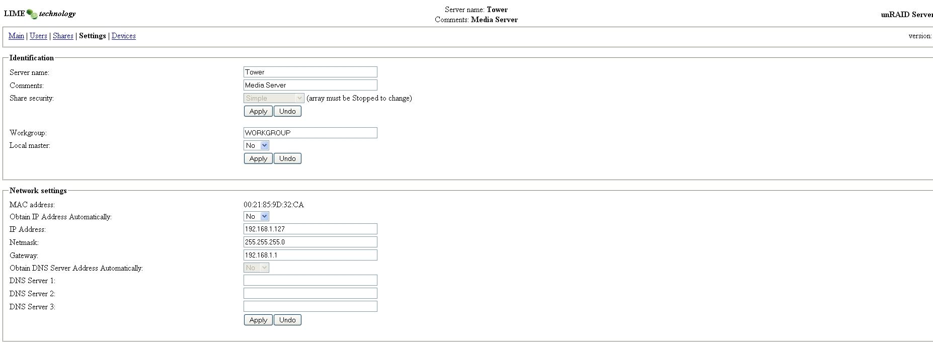

I had Unmenu 1.1 - and tried to upgrade tonight :-\ :-\
I started off by deleting the /boot/unmenu folder using XP and then rebooting the tower from the tower web page.
Then putty in Logged in and made  mkdir /boot/unmenu
Then downloaded unmenu_install1371.zip on my XP machine unzipped it on the xp machine and then copied the unmenu_install file to the unmenu folder using XP through the network.
with Putty running i ran cd /boot/unmenu
which takes me to the unmenu dir , then i ran command unmenu_install -i -d /boot/unmenu and it thinks for a second and returns the message below:
Unable to connect to googlecode.com from your server.
You must have a DNS Nameserver and Gateway defined in your unRAID setup before you can continue..
For most people, these are both set to the IP address of your router.
root@Tower:/boot/unmenu#
I keep getting this message either through putty or hooked up direct to the server!
any ideas?
Aj
You must have, as it says, the DNS server set in the settings page, and the nameserver set.
Typically, both should be set to the IP address of your router. Both are on the "Settings" page in the unRAID management interface.
It indicates that if you were to type
net lookup googlecode.com
it would not return an IP address.
What version of unRAID are you running?
4.6 Pro  - Just tried net lookup googlecode.com and it returns nothing, Is that correct i don't want my server on the net
4.6 Pro
The two fields you need to fill in are on the "Settings" page.
Joe that means the server will be on the Net right? I could temp edit what i need too download the files from google code and then set it back...?
you must have, as it says, the DNS server set in the settings page, and the nameserver set. The name is tower do i just put in my router ip of 192.168.1.1 on the dns server 1 tab?  see the picture.....
Aj
Correct, but you'll need net connectivity to use the package-manager more easily although it provides download links for the packages if you do not have net connectivity.    You also need net connectivity to use the check/install updates feature in 1.3 unMENU.  It can keep itself updated if you click on the buttons on the user-scripts page.
Aj
Yes, just put the router IP.
Your server will not be "on" the net, (nobody on the net can get to it unless you open it up for direct access in your router)
Instead, with the DNS server field set, the unRAID server will be able to access the net.  It can then use it to get to the NIST time servers to keep your system clock set accurately, and to googlecode.com for unMENU updates, and to all the slackware package sites to download add-on packages through the new package manager.
