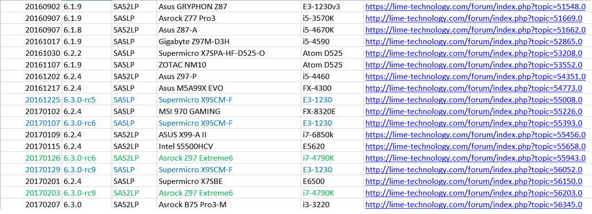

I'm trying to find why it only affects a few users, but it's difficult because they happen on very different hardware, these are the ones I've compiled in the last few months (entries in color represent same user with multiple instance running different unRAID release).
I think the issue is relates to extra hardware... for me it started after adding drive cages.. maybe the saslp cards output less power or are more borderline in reading the sata signal..
