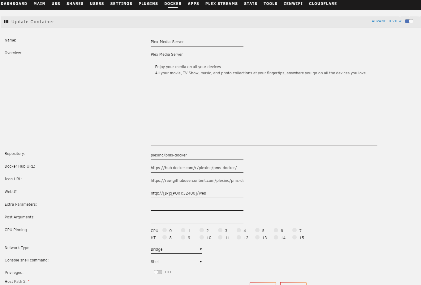

You are the best. I appreciate the response and just know I've been trying.  I have little time to play with this so am just getting to it.
I did everything you suggested perfectly. I understand it all but I cannot get what you are telling me should be there to show up. I'm sure it's something really silly.
I cannot get the network type or fixed IP address fields to show up in any of the app templates.
Thanks so much!

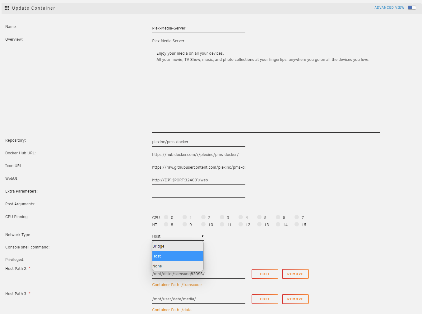

You need to switch the network type from Bridge to be BR0

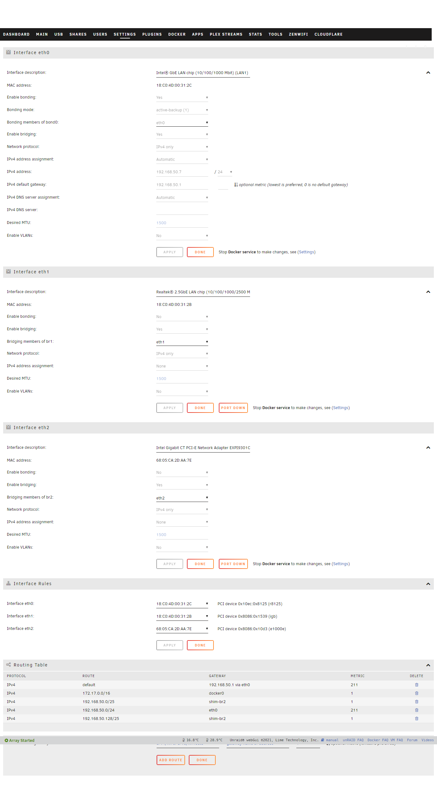

In the docker container? These are my options:
Here are my network settings.
screencapture-192-168-50-7-Settings-NetworkSettings-2021-10-14-11_31_14.thumb.png.52bb1c5023ff1f3ef36c63241246d640.png
