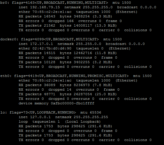

When I try to run the command in the OP, i get the following error:
Error response from daemon: network dm-ba57b5a60b33 is already using parent interface br0
I attached my network settings and also an ifconfig readout with docker enabled, but all dockers turned off. Not sure if I have things set up right.
I have 2 NIC's (both Intel onboard), but i have the second NIC detatched from unRAID and available to a VM using append vfio-pci.ids=etc.

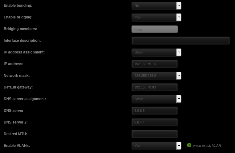

I tried creating this with -o parent=br0.1 and it created it. But when I assign an IP to a docker it is not reachable.
root@Tower:/mnt/user/appdata/pihole# docker inspect pihole | grep IPAddress
            "SecondaryIPAddresses": null,
            "IPAddress": "",
                    "IPAddress": "192.168.79.128",
root@Tower:/mnt/user/appdata/pihole# docker exec pihole ping www.google.com
ping: bad address 'www.google.com'
i also can't reach the webui of the docker either.
Can you post your /boot/config/network.cfg file (or the diagnostics)
the output of "docker network inspect homenet"
the output of "ip addr" and "ip link"
Thanks @ken-ji
network.cfg attached,

    link/ether 70:85:c2:2e:e1:ac brd ff:ff:ff:ff:ff:ff
"ip link":
1: lo: <LOOPBACK,UP,LOWER_UP> mtu 65536 qdisc noqueue state UNKNOWN mode DEFAULT group default qlen 1
    link/loopback 00:00:00:00:00:00 brd 00:00:00:00:00:00
2: tunl0@NONE: <NOARP> mtu 1480 qdisc noop state DOWN mode DEFAULT group default qlen 1
    link/ipip 0.0.0.0 brd 0.0.0.0
3: gre0@NONE: <NOARP> mtu 1476 qdisc noop state DOWN mode DEFAULT group default qlen 1
    link/gre 0.0.0.0 brd 0.0.0.0
4: gretap0@NONE: <BROADCAST,MULTICAST> mtu 1462 qdisc noop state DOWN mode DEFAULT group default qlen 1000
    link/ether 00:00:00:00:00:00 brd ff:ff:ff:ff:ff:ff
5: ip_vti0@NONE: <NOARP> mtu 1364 qdisc noop state DOWN mode DEFAULT group default qlen 1
6: eth0: <BROADCAST,MULTICAST,PROMISC,UP,LOWER_UP> mtu 1500 qdisc mq master br0 state UP mode DEFAULT group default qlen 1000
37: br0: <BROADCAST,MULTICAST,UP,LOWER_UP> mtu 1500 qdisc noqueue state UP mode DEFAULT group default qlen 1000
38: docker0: <BROADCAST,MULTICAST,UP,LOWER_UP> mtu 1500 qdisc noqueue state UP mode DEFAULT group default
    link/ether 02:42:7b:d0:d6:90 brd ff:ff:ff:ff:ff:ff
68: vethcffe18d@if67: <BROADCAST,MULTICAST,UP,LOWER_UP> mtu 1500 qdisc noqueue master docker0 state UP mode DEFAULT group default
    link/ether 6a:b9:83:53:9e:9e brd ff:ff:ff:ff:ff:ff link-netnsid 0
70: vethf36d2cb@if69: <BROADCAST,MULTICAST,UP,LOWER_UP> mtu 1500 qdisc noqueue master docker0 state UP mode DEFAULT group default
    link/ether c2:c0:45:06:69:a0 brd ff:ff:ff:ff:ff:ff link-netnsid 1
72: veth85c2f81@if71: <BROADCAST,MULTICAST,UP,LOWER_UP> mtu 1500 qdisc noqueue master docker0 state UP mode DEFAULT group default
    link/ether b2:fb:fe:40:09:f9 brd ff:ff:ff:ff:ff:ff link-netnsid 2
74: veth8841ad0@if73: <BROADCAST,MULTICAST,UP,LOWER_UP> mtu 1500 qdisc noqueue master docker0 state UP mode DEFAULT group default
    link/ether 2e:f3:d0:ca:18:04 brd ff:ff:ff:ff:ff:ff link-netnsid 3
76: veth43be249@if75: <BROADCAST,MULTICAST,UP,LOWER_UP> mtu 1500 qdisc noqueue master docker0 state UP mode DEFAULT group default
    link/ether 3a:e7:11:e4:3a:f0 brd ff:ff:ff:ff:ff:ff link-netnsid 4
78: vethb23822a@if77: <BROADCAST,MULTICAST,UP,LOWER_UP> mtu 1500 qdisc noqueue master docker0 state UP mode DEFAULT group default
    link/ether 5e:15:4e:4f:e8:27 brd ff:ff:ff:ff:ff:ff link-netnsid 5
84: veth8ea80ff@if83: <BROADCAST,MULTICAST,UP,LOWER_UP> mtu 1500 qdisc noqueue master docker0 state UP mode DEFAULT group default
    link/ether a6:b5:c8:54:17:43 brd ff:ff:ff:ff:ff:ff link-netnsid 8
86: veth00d62c7@if85: <BROADCAST,MULTICAST,UP,LOWER_UP> mtu 1500 qdisc noqueue master docker0 state UP mode DEFAULT group default
    link/ether 36:f6:b3:2f:15:7a brd ff:ff:ff:ff:ff:ff link-netnsid 9
88: veth6cf8a31@if87: <BROADCAST,MULTICAST,UP,LOWER_UP> mtu 1500 qdisc noqueue master docker0 state UP mode DEFAULT group default
    link/ether 86:34:77:55:ad:f1 brd ff:ff:ff:ff:ff:ff link-netnsid 11
90: veth1cfac99@if89: <BROADCAST,MULTICAST,UP,LOWER_UP> mtu 1500 qdisc noqueue master docker0 state UP mode DEFAULT group default
    link/ether da:8f:52:a8:1f:25 brd ff:ff:ff:ff:ff:ff link-netnsid 12
92: veth8e022a0@if91: <BROADCAST,MULTICAST,UP,LOWER_UP> mtu 1500 qdisc noqueue master docker0 state UP mode DEFAULT group default
    link/ether 02:47:3d:0a:27:07 brd ff:ff:ff:ff:ff:ff link-netnsid 13
94: veth16c6eaa@if93: <BROADCAST,MULTICAST,UP,LOWER_UP> mtu 1500 qdisc noqueue master docker0 state UP mode DEFAULT group default
    link/ether 4a:a5:da:63:12:00 brd ff:ff:ff:ff:ff:ff link-netnsid 14
96: vethff638b9@if95: <BROADCAST,MULTICAST,UP,LOWER_UP> mtu 1500 qdisc noqueue master docker0 state UP mode DEFAULT group default
    link/ether da:6b:d2:56:31:75 brd ff:ff:ff:ff:ff:ff link-netnsid 15
100: virbr0: <NO-CARRIER,BROADCAST,MULTICAST,UP> mtu 1500 qdisc noqueue state DOWN mode DEFAULT group default qlen 1000
    link/ether 52:54:00:35:e4:53 brd ff:ff:ff:ff:ff:ff
101: virbr0-nic: <BROADCAST,MULTICAST> mtu 1500 qdisc pfifo_fast master virbr0 state DOWN mode DEFAULT group default qlen 1000
102: vnet0: <BROADCAST,MULTICAST,UP,LOWER_UP> mtu 1500 qdisc pfifo_fast master br0 state UNKNOWN mode DEFAULT group default qlen 1000
    link/ether fe:54:00:44:b4:34 brd ff:ff:ff:ff:ff:ff
104: veth8e6e43c@if103: <BROADCAST,MULTICAST,UP,LOWER_UP> mtu 1500 qdisc noqueue master docker0 state UP mode DEFAULT group default
    link/ether ae:b8:63:19:65:4a brd ff:ff:ff:ff:ff:ff link-netnsid 10
106: vethe9ce18e@if105: <BROADCAST,MULTICAST,UP,LOWER_UP> mtu 1500 qdisc noqueue master docker0 state UP mode DEFAULT group default
    link/ether 6a:b6:eb:40:23:1b brd ff:ff:ff:ff:ff:ff link-netnsid 16
110: br0.1@br0: <BROADCAST,MULTICAST,UP,LOWER_UP> mtu 1500 qdisc noqueue state UP mode DEFAULT group default
network.cfg
ok. Your dockers are on a macvlan subinterface br0.1, which seems to be a VLAN id 1 under br0.
By design, macvlan subinterfaces cannot talk to the host on the parent interface. Also, as you are trying to use VLAN id 1, does your switch have VLAN support?
I ask because VLANs can't see each other unless you have a L3 router (or some VLAN bridge) in your network.
In a nutshell, Packets on a VLAN subinterface (br0.x) get tagged when they exit the host (br0), the tag is standardized (802.11q) but makes the packet look like garbage to devices without VLAN support.
This is the reason my samples gave the simple case of using br0 and br1 directly. When you use a subinterface, this assumes VLAN support and therefore some understanding of what you are trying to achieve.
EDIT: Upon re-checking, your not using VLANs. Since your dockers cannot access the main network, can you run "ip -d link show"? I need a little more detail to understand why its not working.
also "docker inspect pi_hole"

and the docker inspect for pihole is attached.
BTW, the Vlan i enabled after i posted while troubleshooting. I should disable it but forgot to. But i was having the issues before i enabled it.
pihole inspect.txt
Then my answer stands.
* you can't use VLANs unless you have a VLAN supported switch.
* with only a single NIC, dockers with dedicated IPs can not talk to the host and vice versa.
This is in your original post:
"With only a single NIC, and no VLAN support on your network, it is impossible for the host unRAID to talk to the containers and vice versa; the macvlan driver specifically prohibits this. This situation prevents a reverse proxy docker from proxying unRAID, but will work with all other containers on the new docker network. "
I thought that latter part of that paragraph was that it'd still work as long as i wasn't trying to have the container talk to unRaid. Shouldn't that still mean the container can talk to the outside world? or did I misunderstand what you're saying?
In what cases does your single NIC example work? Is it not feasible if you don't have a VLAN supported network? I do have a second NIC and can try your 2 NIC reco, but i was hoping to isolate the second NIC specifically for a VM running PFSense (which i haven't started yet).
Edited by Kewjoe
Something is wrong with your setup right now...
How did you create the br0.1 interface? The one in your ip commands is created as a VLAN subinterface.
You can reconfigure the pihole container back, delete the homenet docker network with "docker network rm homenet", and stop the array and disable the VLAN network. Then try again.
