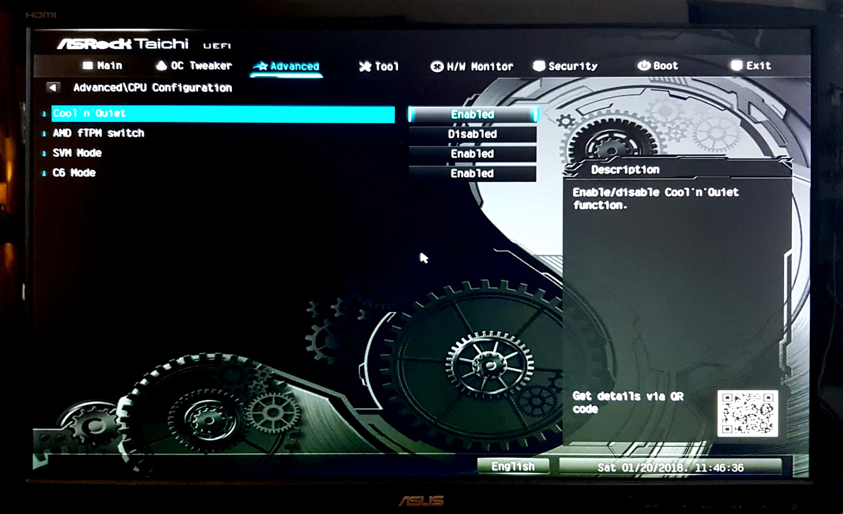

Did you disable C6 or "global C states" in bios?  The hang typically happens when everything goes idle.
These are enabled.
The only leg work i did in unraid was the XML within the VM to pass thro the nvidia gfx card.
The system is 24/7 on so will see tomorrow and report back.
Edited by Greygoose
5 minutes ago, Greygoose said:
These are enabled.

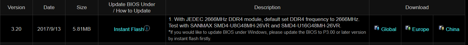

AMD claims to be rolling out bios updates for this issue, what is the date on your bios?
I have the most latest from the Asrock website 3.20
I have had the VM running and working within the VM so the system hasnt been idle.
I have shutdown the VM and will leave idle tonight.

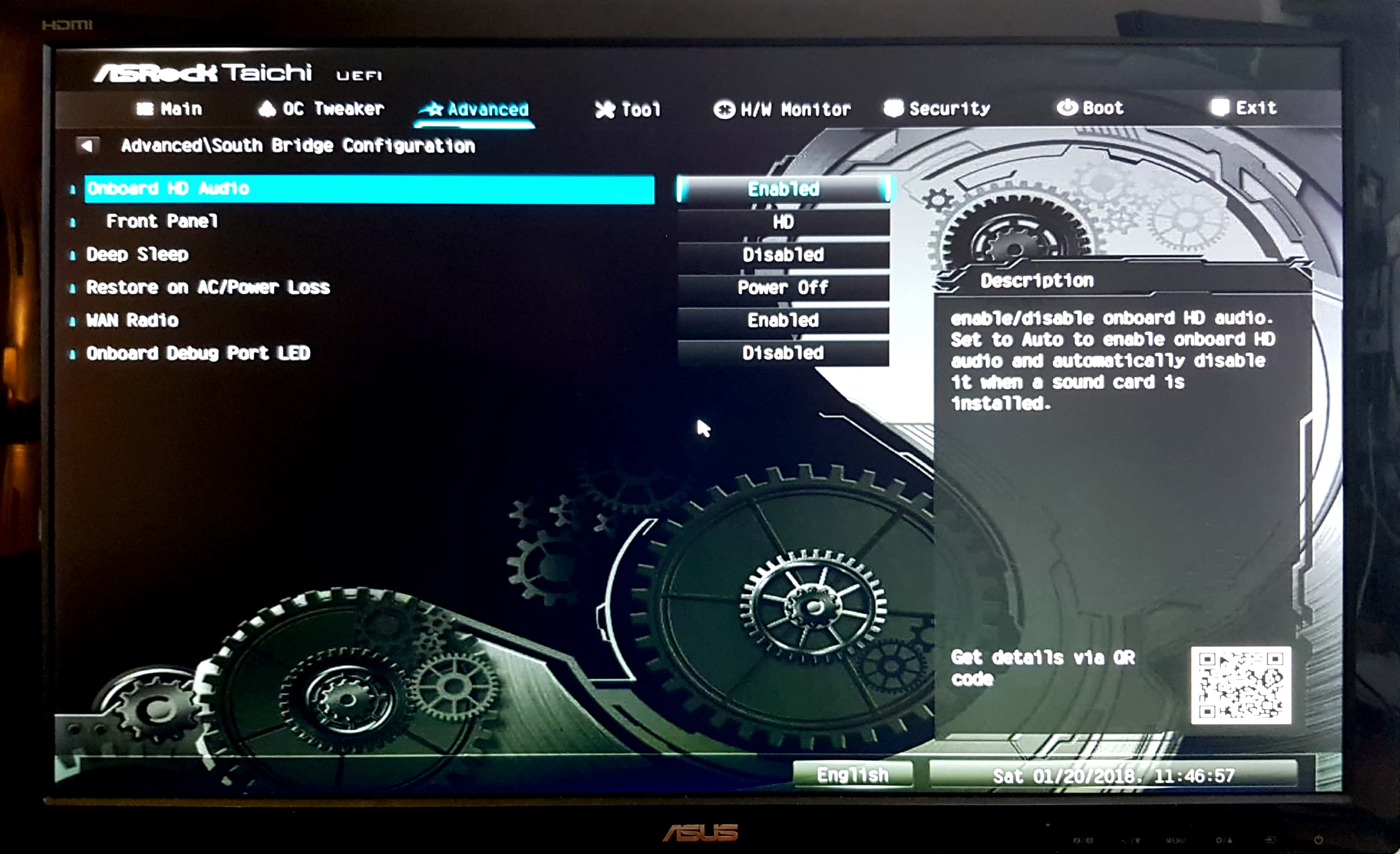

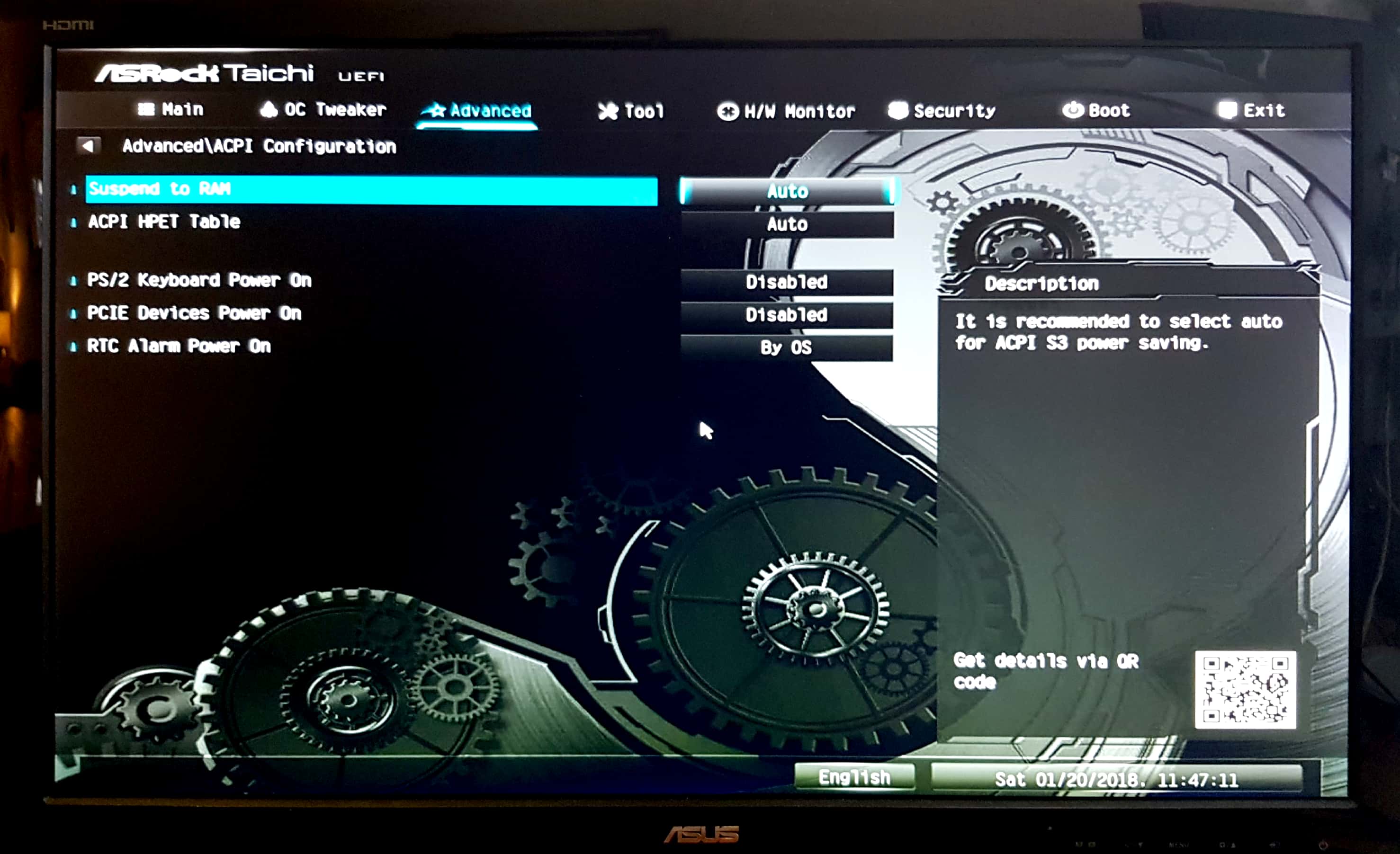

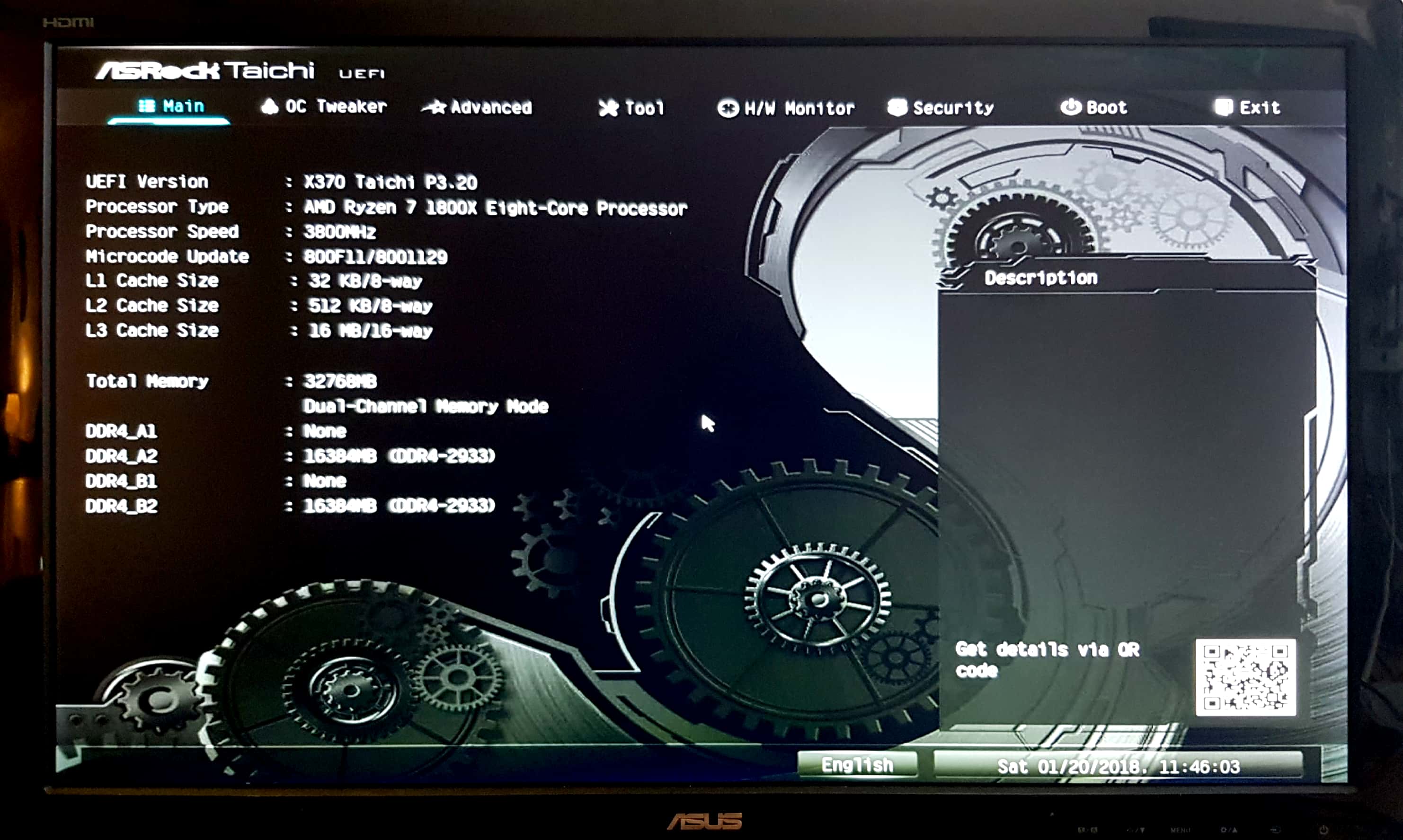

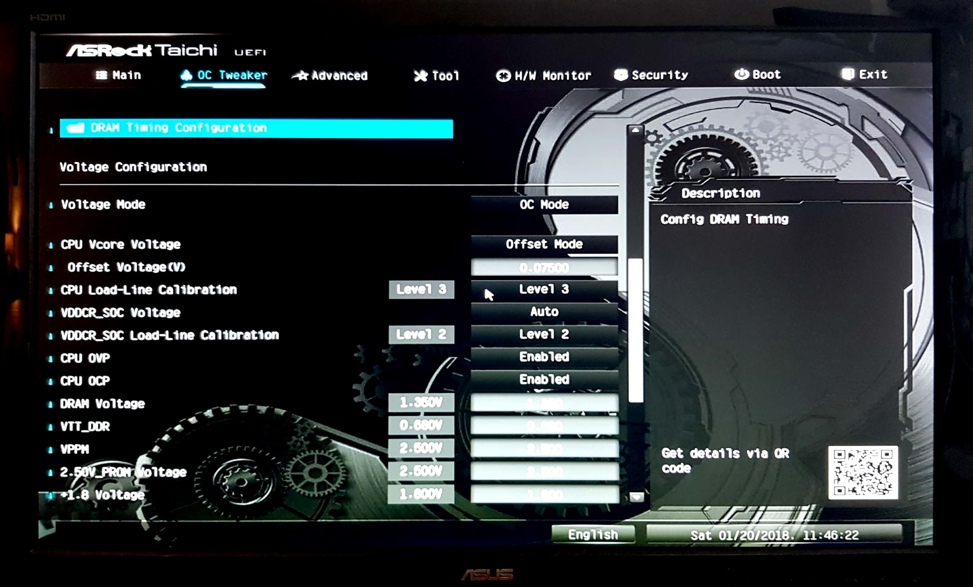

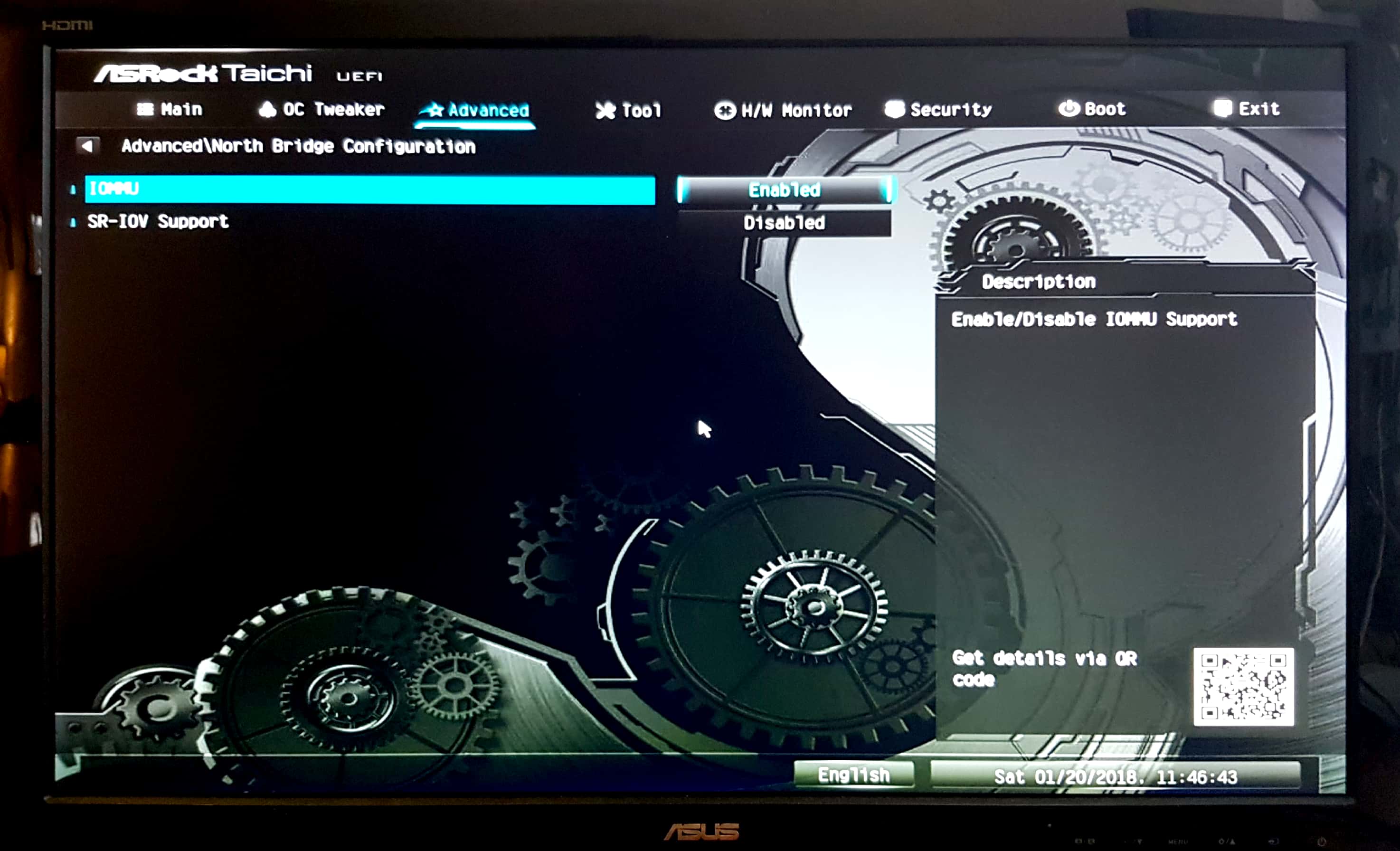

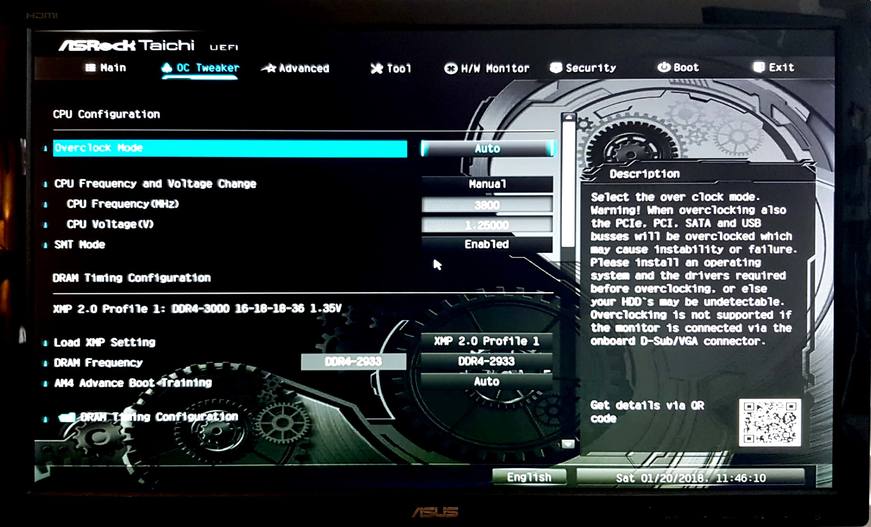

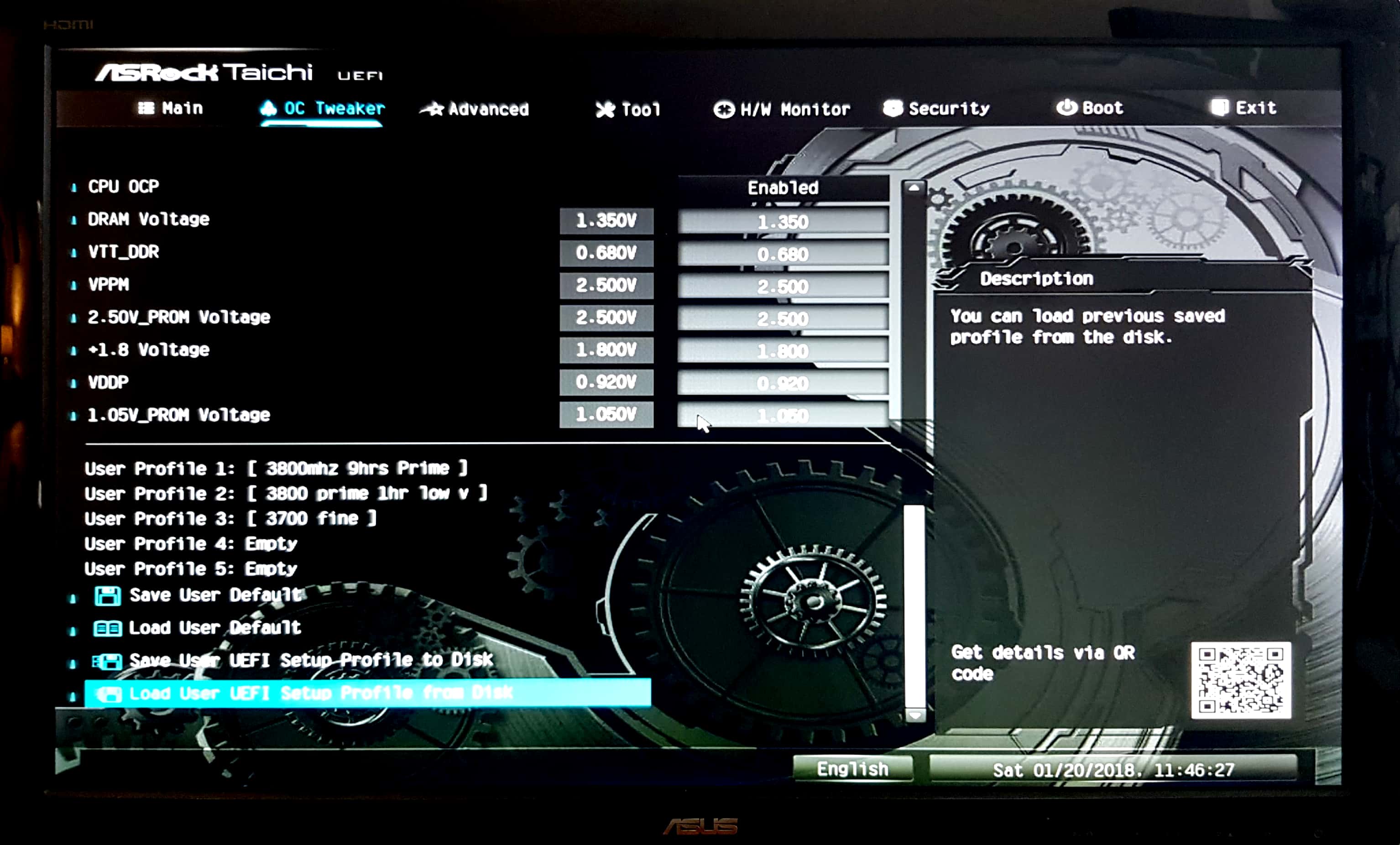

Here is my bios setting.
I started a fresh USB unraid today to be sure it was not my old config from my other system..  It was fine for 4 hours idle, no issues.
