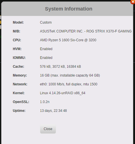

My Ryzen machine runs two VMs at any given time — Windows 10 and Ubuntu. If I let the computer idle while nothing is running in Windows, the entire system locks up and all you can do is a hard reset. But if I keep Blender open in Windows, the system is rock solid with zero problems. Windows power management settings are all switched off.
Did you update your BIOS to the newest version and it persists?
Maybe try adding the RCU_NOCBS kernel parameter
Are you using zenstates option for unRAIDs boot loader?
Sounds like a C6 sleep issue.

Has anyone tried the new unRAID 6.5.0 on Ryzen systems and can give me feedback?
Because mine would not even boot at all (and yeah i did run the make_bootable script)
No problems so far...
Is Ryzen or Threadripper able to run unraid WITHOUT disabling C6 yet?
It works fine for me, but beware that the mainboard, the bios and the CPU/APU plays a role in it too.
But if you want to go for ultra low wattage on standby, you wont get the same results as Intel does.
