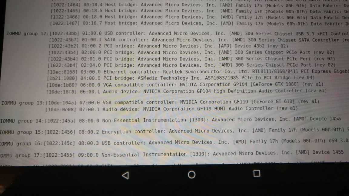

@killeriq
Would you be so kind to share your iommu groups with 2 gpus in slots?
Im got really weird iommu groups on the ASUS Prime B350 Plus with dual gpus, which i explained here: https://lime-technology.com/forums/topic/69986-problems-on-ryzen-5-with-asus-prime-b350-plus/
Basically they prevent me from using a dual gpu setup with unraid, which is what i want :'(

1 hour ago, jammsen said:
@killeriq
Did you use ACS Override?
If not, do.
If that is not enough, search my post back in the thread, where I explain how to setup the "multifunction" into unRaid startup. This helped me a lot to split the groups insanely (like really every device having its own group).
Motherboard: GIGABYTE X399 Designare EX
Installed a GeForce GTX 960 into PCIe slot #1 and a el-cheapo GeForce GT 610 into PCIe slot #4 and configured BIOS to use the 610 as the primary - though setting it to primary only worked with the 610 in slot 4.
IOMMU group 0:	[1022:1452] 00:01.0 Host bridge: Advanced Micro Devices, Inc. [AMD] Family 17h (Models 00h-0fh) PCIe Dummy Host Bridge

	[1022:43b4] 02:02.0 PCI bridge: Advanced Micro Devices, Inc. [AMD] 300 Series Chipset PCIe Port (rev 02)
	[1022:43b4] 02:03.0 PCI bridge: Advanced Micro Devices, Inc. [AMD] 300 Series Chipset PCIe Port (rev 02)
	[1022:43b4] 02:04.0 PCI bridge: Advanced Micro Devices, Inc. [AMD] 300 Series Chipset PCIe Port (rev 02)
	[8086:1539] 04:00.0 Ethernet controller: Intel Corporation I211 Gigabit Network Connection (rev 03)
	[8086:24fd] 05:00.0 Network controller: Intel Corporation Wireless 8265 / 8275 (rev 78)
	[8086:1539] 06:00.0 Ethernet controller: Intel Corporation I211 Gigabit Network Connection (rev 03)
IOMMU group 12:	[10de:104a] 08:00.0 VGA compatible controller: NVIDIA Corporation GF119 [GeForce GT 610] (rev a1)
	[10de:0e08] 08:00.1 Audio device: NVIDIA Corporation GF119 HDMI Audio Controller (rev a1)
IOMMU group 13:	[1022:1452] 40:01.0 Host bridge: Advanced Micro Devices, Inc. [AMD] Family 17h (Models 00h-0fh) PCIe Dummy Host Bridge
IOMMU group 14:	[1022:1452] 40:02.0 Host bridge: Advanced Micro Devices, Inc. [AMD] Family 17h (Models 00h-0fh) PCIe Dummy Host Bridge
IOMMU group 15:	[1022:1452] 40:03.0 Host bridge: Advanced Micro Devices, Inc. [AMD] Family 17h (Models 00h-0fh) PCIe Dummy Host Bridge
IOMMU group 16:	[1022:1453] 40:03.1 PCI bridge: Advanced Micro Devices, Inc. [AMD] Family 17h (Models 00h-0fh) PCIe GPP Bridge
IOMMU group 17:	[1022:1452] 40:04.0 Host bridge: Advanced Micro Devices, Inc. [AMD] Family 17h (Models 00h-0fh) PCIe Dummy Host Bridge
IOMMU group 18:	[1022:1452] 40:07.0 Host bridge: Advanced Micro Devices, Inc. [AMD] Family 17h (Models 00h-0fh) PCIe Dummy Host Bridge
	[1022:1454] 40:07.1 PCI bridge: Advanced Micro Devices, Inc. [AMD] Family 17h (Models 00h-0fh) Internal PCIe GPP Bridge 0 to Bus B
	[1022:145a] 42:00.0 Non-Essential Instrumentation [1300]: Advanced Micro Devices, Inc. [AMD] Device 145a
	[1022:1456] 42:00.2 Encryption controller: Advanced Micro Devices, Inc. [AMD] Family 17h (Models 00h-0fh) Platform Security Processor
	[1022:145c] 42:00.3 USB controller: Advanced Micro Devices, Inc. [AMD] Family 17h (Models 00h-0fh) USB 3.0 Host Controller
IOMMU group 19:	[1022:1452] 40:08.0 Host bridge: Advanced Micro Devices, Inc. [AMD] Family 17h (Models 00h-0fh) PCIe Dummy Host Bridge
	[1022:1454] 40:08.1 PCI bridge: Advanced Micro Devices, Inc. [AMD] Family 17h (Models 00h-0fh) Internal PCIe GPP Bridge 0 to Bus B
	[1022:1455] 43:00.0 Non-Essential Instrumentation [1300]: Advanced Micro Devices, Inc. [AMD] Device 1455
	[1022:7901] 43:00.2 SATA controller: Advanced Micro Devices, Inc. [AMD] FCH SATA Controller [AHCI mode] (rev 51)
IOMMU group 20:	[10de:1401] 41:00.0 VGA compatible controller: NVIDIA Corporation GM206 [GeForce GTX 960] (rev a1)
	[10de:0fba] 41:00.1 Audio device: NVIDIA Corporation Device 0fba (rev a1)
USB Devices
Bus 001 Device 001:	ID 1d6b:0002 Linux Foundation 2.0 root hub
Bus 001 Device 002:	ID 8087:0a2b Intel Corp.
Bus 001 Device 003:	ID 048d:8295 Integrated Technology Express, Inc.
Bus 002 Device 001:	ID 1d6b:0003 Linux Foundation 3.0 root hub
Bus 003 Device 001:	ID 1d6b:0002 Linux Foundation 2.0 root hub
Bus 003 Device 002:	ID 154b:007a PNY Classic Attache Flash Drive
Bus 004 Device 001:	ID 1d6b:0003 Linux Foundation 3.0 root hub
Bus 005 Device 001:	ID 1d6b:0002 Linux Foundation 2.0 root hub
Bus 005 Device 002:	ID 045e:0745 Microsoft Corp. Nano Transceiver v1.0 for Bluetooth
Bus 006 Device 001:	ID 1d6b:0003 Linux Foundation 3.0 root hub
CPU Pairings
Pair 1:	cpu 0 / cpu 16
Pair 2:	cpu 1 / cpu 17
Pair 3:	cpu 2 / cpu 18
Pair 4:	cpu 3 / cpu 19
Pair 5:	cpu 4 / cpu 20
Pair 6:	cpu 5 / cpu 21
Pair 7:	cpu 6 / cpu 22
Pair 8:	cpu 7 / cpu 23
Pair 9:	cpu 8 / cpu 24
Pair 10: cpu 9 / cpu 25
Pair 11: cpu 10 / cpu 26
Pair 12: cpu 11 / cpu 27
Pair 13: cpu 12 / cpu 28
Pair 14: cpu 13 / cpu 29
Pair 15: cpu 14 / cpu 30
Pair 16: cpu 15 / cpu 31
