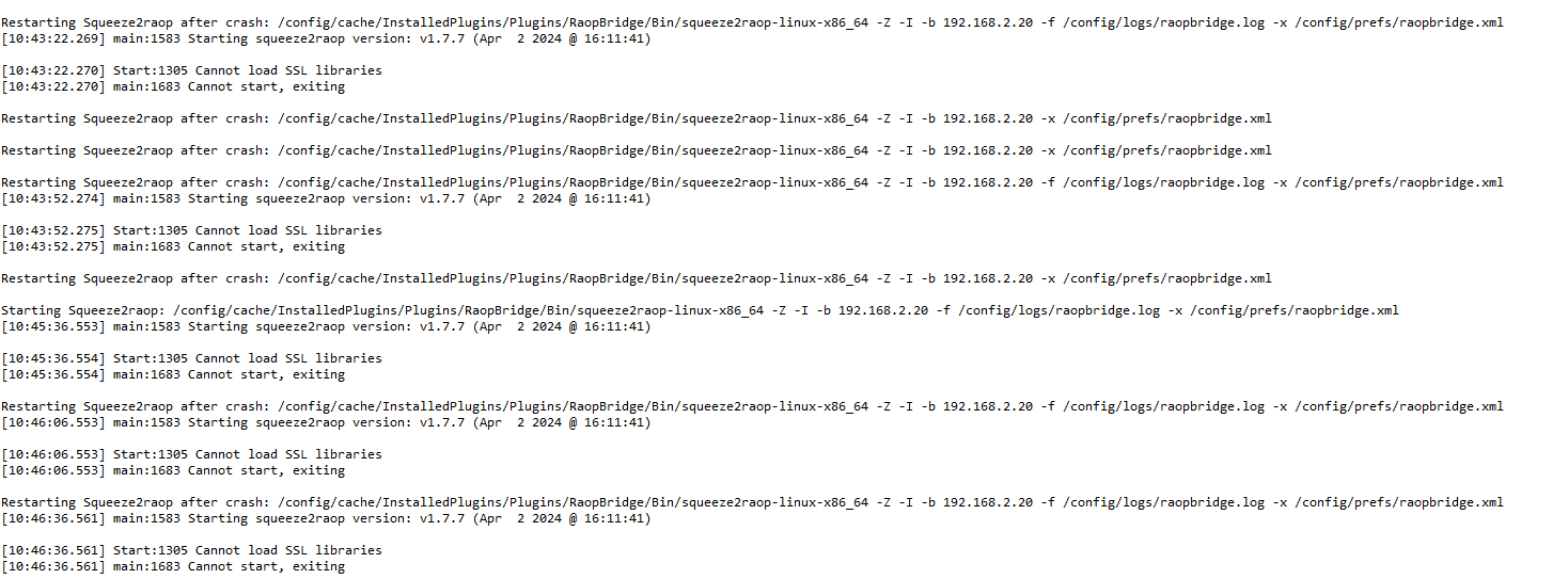

First of all, a happy new year 2025 🙂 I am completely new to unraid as well as docker. Currently i am running the test license of unraid and tried to run the LMS docker with the airplay bridge extension.
The problem i am facing is, that the airplay bridge wont start successfully, because it cant load some ssl libraries (pls see logfile).
So i guess, something is missing from the docker container ? Is there a chance to get this running ? Which additional information would be needed ? The plugin is of version 1.7.7, the LMS docker reports that it is up to date, LMS is 9.0.0
Lyrion Music Server Version: 9.0.0 - 1732822968 @ Fri Nov 29 12:08:17 UTC 2024
I am currently running the airplay bridge from my raspberry, but it would be nice if it would work from unraid.
Thanks and best regards,
Andreas

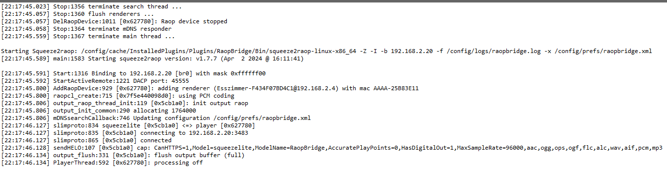

Update the container.  I added a missing library.
Hello Sir,
Thank you for your quick reply, i will do so and report back 🙂
All the best,
Andreas
I managed to test immediately, error is now gone, startup not crashing anymore and airplay device is now detected  (and fortunately no subsequent error) 🙂
Thank you again for your outstanding support!
Best regards, Andreas
