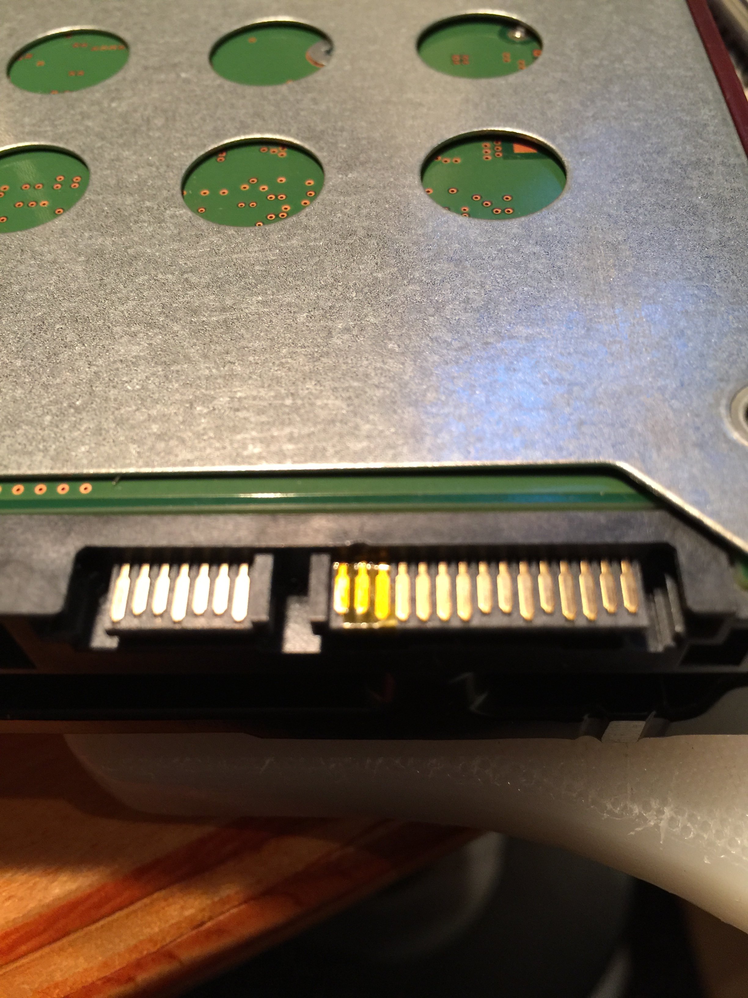

Just got a WD80EMAZ, unshucked without breaking tabs.  Plugged it into my Norco 4220, it's not recognized :/
You need to cover pin 3 of the SATA power connector on the drive so the drive will power up. Kapton tape is the best option. You can overlap pin 2 and 1 also if you can't cut a piece precisely enough to only insulate pin 3.
Worked like a charm, thanks!

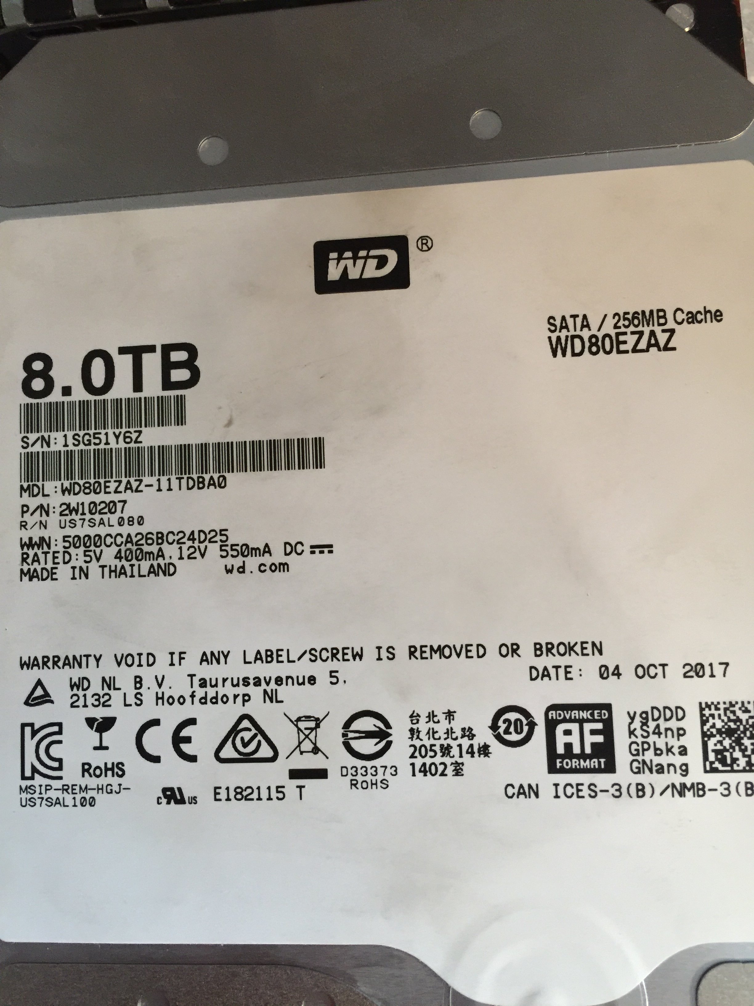

I bought a WD My Book 8TB USB 3.0 Desktop Hard Drive WDBBGB0080HBK-NESN Black (https://www.newegg.com/Product/Product.aspx?Item=N82E16822235160).
I tested it in the enclosure, worked fine.  Shucked the drive and put it in my server, server booted as normal, but disk did not spin up.
I assumed I had the 3.3V issue, so I covered pins 1,2,3 with kypton tape as suggested.
Now I see the drive light come on, so the disk is spinning up, BUT my system locks up at the BIOS splash screen.  I remove the disk for the server and it boots as normal.
Any suggestion on a next step???
Update BIOS?
