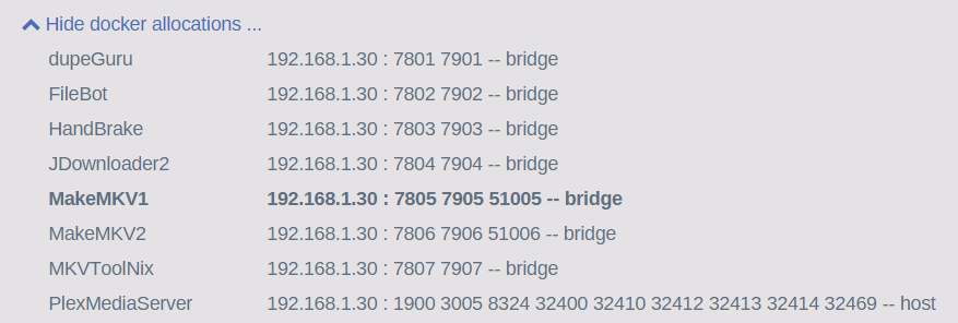

Only thing is I needed to remap some ports, so I just ended up remapping them all a bit cleaner, at least in my eyes:
Outside of that, dual ripping worked fine.

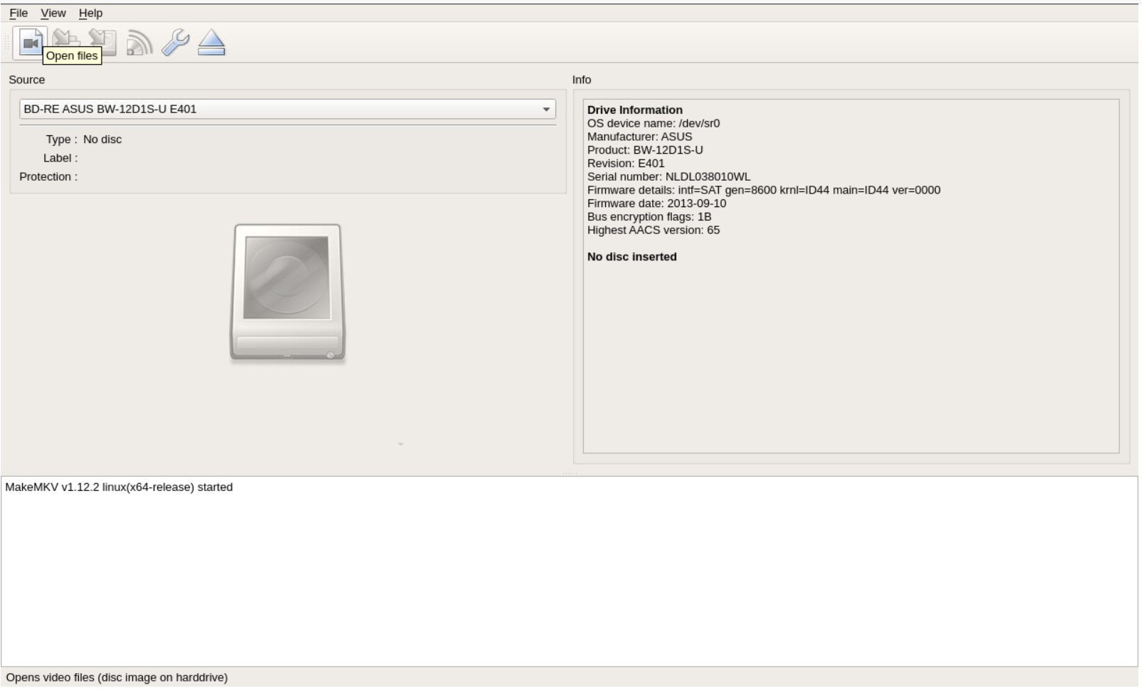

@cybrnook, can you try image with tag "v1.9.0-rc1"?  To enable parallel ripping, add the "AUTO_DISC_RIPPER_PARALLEL_RIP" variable with a value of "1".
Seems to come down with the handbrake logo:
Added the variable:
But docker shows only one drive at a time. Not sure what I should be looking for, but I would have expected two drive selects in one window, I guess?
Edited by cybrnook
