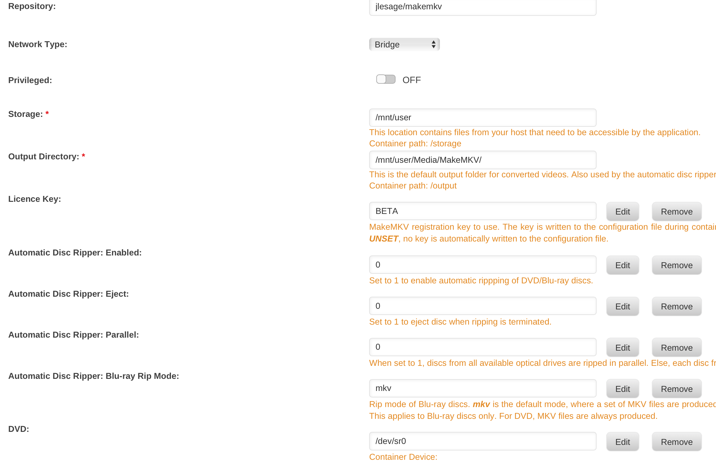

11 hours ago, Balpaugh said:
Thank you Djoss. I probably looked at it a hundred times and didn't notice that the output was defaulting to /storage and not /output. as soon as i changed it, it appears to work. Now the question is why does the output file location default to /storage and not /output?
It should default to /output.  Did you had the issue after a fresh install?

yes, a couple of fresh installs. Each time in defaults back to storage.

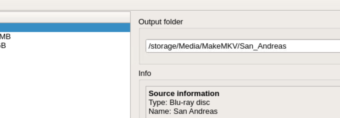

What are your MakeMKV settings under the General tab?

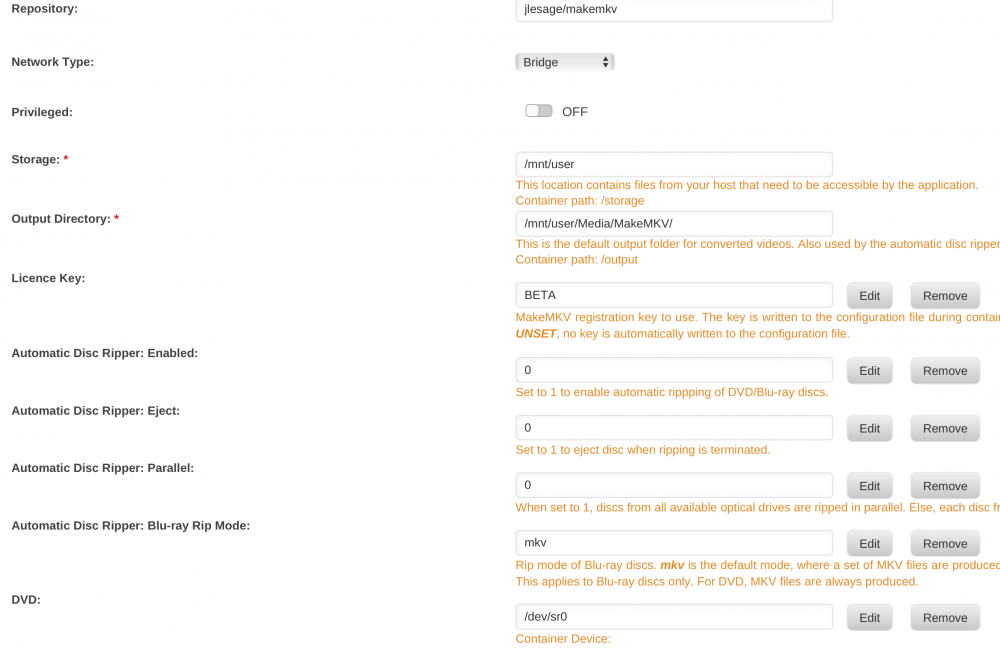

Here is my MakeMKV settings. The output folder appears to be set correctly, however it continually defaults to the storage directly forcing me to manually change it to the output.
Sorry I meant the settings of MakeMKV itself (inside the UI), not the settings of the container.
