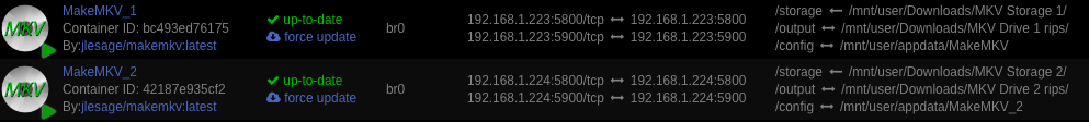

what settings do in need to change so that i can have 2x movies ripping at the same time with the 2x different drives i have? also thank you for making the docker it is working great with the 1 drive all set up :)
cd/dvd PIONEER BD-RW BDR-XD05 3.01 /dev/sr1
cd/dvd PIONEER BD-RW BDR-XD05 3.10 /dev/sr0

Do you mean that you want to rip 2 movies simultaneously or you want the container to be able to rip movies from both of your drives?
With a single container, you cannot rip two movies at the same time.  If both drives are accessible to the container, movies will be ripped one after the other.
Maybe you can try to create 2 containers (with different appdata and ports) and assign them a different drive...
this is how i have them set up just with each container having a dedicated drive, ip address and 2x of the container with different appdata folders. as seen in the pic and thank you for the fast reply @Djoss
5ab2baa4a489b_ScreenShot2018-03-21at4_03_11PM.png.7fc818b9b4398dfb890850f26312413c.png
So this setup is working?
