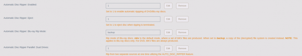

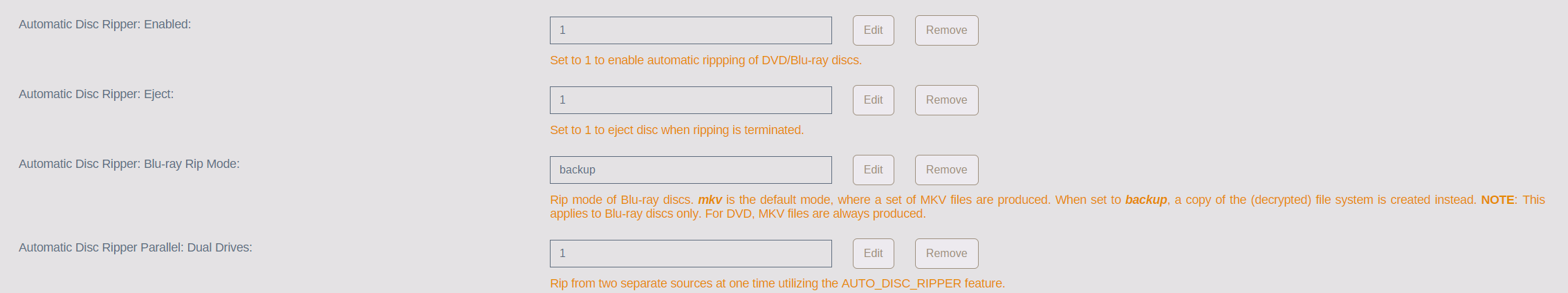

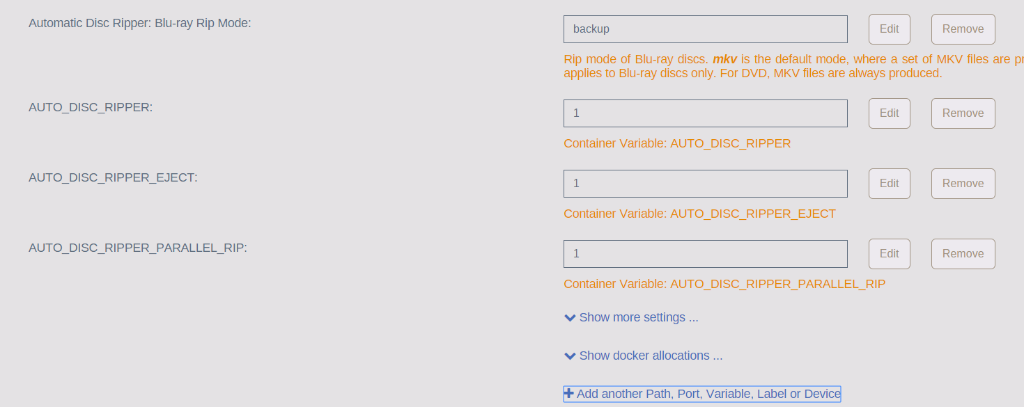

It's only ripping one of the two discs that were inserted.
image.png.5f3684ce148d9555d2ef0c0a100bf2
Edited by cybrnook
3 minutes ago, cybrnook said:
Getting close ?, let's go eject and push them back in :
Looks like parallel rip is not enabled...
Where can I pull that from? The view next to the container only shows what was active since the time I opened it.
docker logs MakeMKV

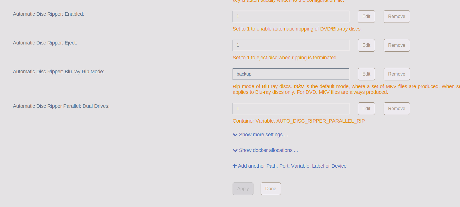

23 minutes ago, cybrnook said:
Redo (delete/recreate) the AUTO_DISC_RIPPER_PARALLEL_RIP variable parameter.  Looks like there is a byte order mark unicode character in the name:
AUTO_DISC_RIPPE<feff>R_PARALLEL_RIP
Will try again
It's working ? sorry for the noob copy/paste windows formatting error:

If set to "mkv" any way to have it pick the "movie" itself out of the BS on the disc? And you should call this out in the MakeMKV default template:

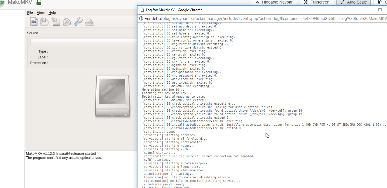

Hello,
So I have a bluray and dvd drive hooked up looking to do parrallel ripping.
I did the following but nothing worked
--device /dev/sr0 --device /dev/sr1
I then did the following and drives showed up but no auto ripping was working
--device /dev/sg6 --device /dev/sg5
I then read you had to put both
--device /dev/sr0 --device /dev/sg5 --device /dev/sr1 --device /dev/sg6
However no drives appear in the gui now.
This is the output of
[cont-init.d] 90-makemkv.sh: exited 0.
[cont-init.d] 95-check-optical-drive.sh: executing...
[cont-init.d] 95-check-optical-drive.sh: looking for usable optical drives...
[cont-init.d] 95-check-optical-drive.sh: found optical drive [/dev/sr0, /dev/sg5], group 19.
[cont-init.d] 95-check-optical-drive.sh: found optical drive [/dev/sr1, /dev/sg6], but it is not usable because:
[cont-init.d] 95-check-optical-drive.sh: --> the host device /dev/sr1 is not exposed to the container.
[cont-init.d] 95-check-optical-drive.sh: --> the host device /dev/sg6 is not exposed to the container.
[cont-init.d] 95-check-optical-drive.sh: exited 0.
[cont-init.d] 96-install-autodiscripper-srv.sh: executing...
[cont-init.d] 96-install-autodiscripper-srv.sh: installing automatic disc ripper for drive 0 (HD-DVD-ROM HL-DT-ST BDDVDRW GGC-H20L 1.02)...
[cont-init.d] 96-install-autodiscripper-srv.sh: exited 0.
[cont-init.d] done.
Edited by MaxHayman
1 hour ago, MaxHayman said:
Hello,
[cont-init.d] done.

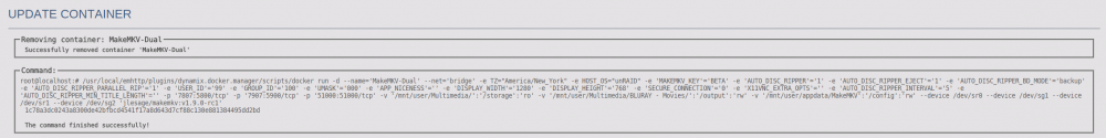

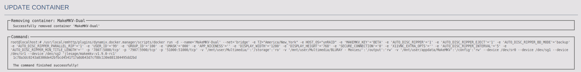

What do you have in the log with:
Hi Djoss,
Here it is. The blu ray is in the drive when it starts up.
On 7/21/2018 at 5:11 PM, MaxHayman said:
Hi Djoss,
Could you provide the output of the following commands (while the container is running):
docker exec MakeMKV /opt/makemkv/bin/makemkvcon -r --cache=1 info disc:9999
docker exec MakeMKV lsscsi -g -k
docker exec MakeMKV ls -l /dev/
docker inspect MakeMKV
