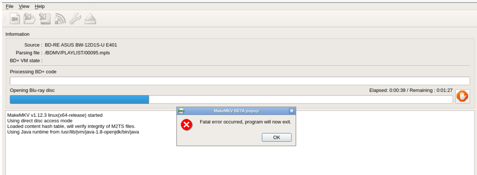

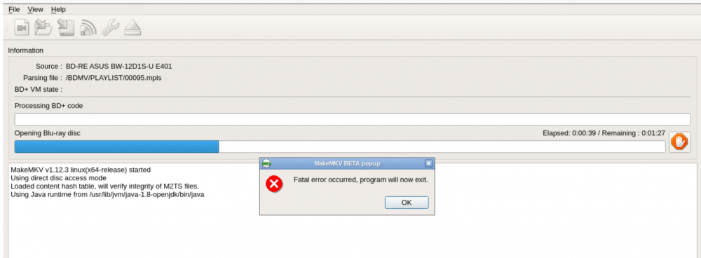

Upgraded docker to the 1.12.3 and receiving this error today.   Any ideas?
kernel: makemkvcon[4276]: segfault at 8 ip 000000000060c65d sp 000014cf32b8beb0 error 4 in makemkvcon[400000+5db000]
Edited by luisv
How did you get this error?

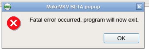

After the upgrade, I inserted a disk to rip and after 20 seconds or so, it errors out.  I ripped a disk successfully last week or so.
Edited by luisv
You were able to rip a disk last week, but not the same one as today, correct?
Are you able to rip other disks?
Do you remember which Docker image version you had before upgrading?
As luck would have it, it seems to be related to the new disk.  I grabbed a bunch of others that were succesful and they are working just fine.  Wierd, I've never had an issue like this before, so I assumed it was due to the upgrade.  Is there a way to run a previous version of the container?  Sorry, but I don't recall what version I was previously running.

Also seeing the java segfault:
Other users seem to relate this to the JAVA version:
https://www.makemkv.com/forum/viewtopic.php?f=3&t=17268
I know unrelated, but there is a broken symlink in /usr/bin as well:
appletviewer -> ../lib/jvm/default-jvm/bin/appletviewer
Maybe this helps, perhaps a compile error? (https://github.com/docker-library/openjdk/issues/77):
/usr/bin # ldd java
        /lib/ld-musl-x86_64.so.1 (0x1483185c6000)
Error loading shared library libjli.so: No such file or directory (needed by java)
        libc.musl-x86_64.so.1 => /lib/ld-musl-x86_64.so.1 (0x1483185c6000)
Error relocating java: JLI_Launch: symbol not found
/usr/bin # whoami
root
CONFIRMED: This fixed the backup issue, and ripping works again - no segfault:
/usr/bin # cp -p /usr/lib/jvm/java-1.8-openjdk/jre/lib/amd64/jli/libjli.so /lib
/usr/bin # ldd java
        /lib/ld-musl-x86_64.so.1 (0x1479396b8000)
        libjli.so => /lib/libjli.so (0x1479392a8000)
        libc.musl-x86_64.so.1 => /lib/ld-musl-x86_64.so.1 (0x1479396b8000)
        libz.so.1 => /lib/libz.so.1 (0x147939091000)
However, the more permanent fix I think is to add the proper path variables as suggested by "echa" in the link above.

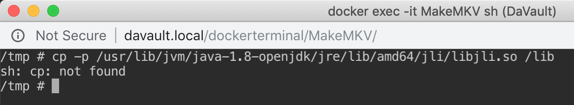

Now this error:
sh: cp : not found
Edited by luisv

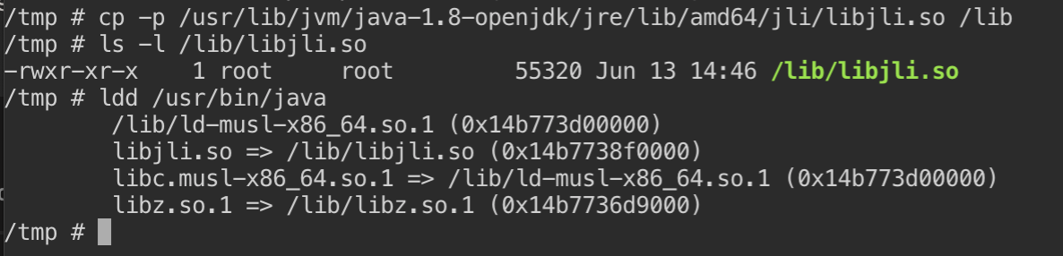

You have to be doing something wrong, your command shouldn't be interpreted as "sh" (I suspect your are trying to copy/paste the command?).....
/tmp # which cp
/bin/cp
/tmp # cp -p /usr/lib/jvm/java-1.8-openjdk/jre/lib/amd64/jli/libjli.so /lib
/tmp # ls -l /lib/libjli.so
-rwxr-xr-x    1 root     root         55320 Jun 13 14:46 /lib/libjli.so
/tmp # ldd /usr/bin/java
        /lib/ld-musl-x86_64.so.1 (0x149e9e174000)
        libjli.so => /lib/libjli.so (0x149e9dd64000)
        libc.musl-x86_64.so.1 => /lib/ld-musl-x86_64.so.1 (0x149e9e174000)
        libz.so.1 => /lib/libz.so.1 (0x149e9db4d000)
/tmp #
And YES, the change does retain after a container restart 🙂

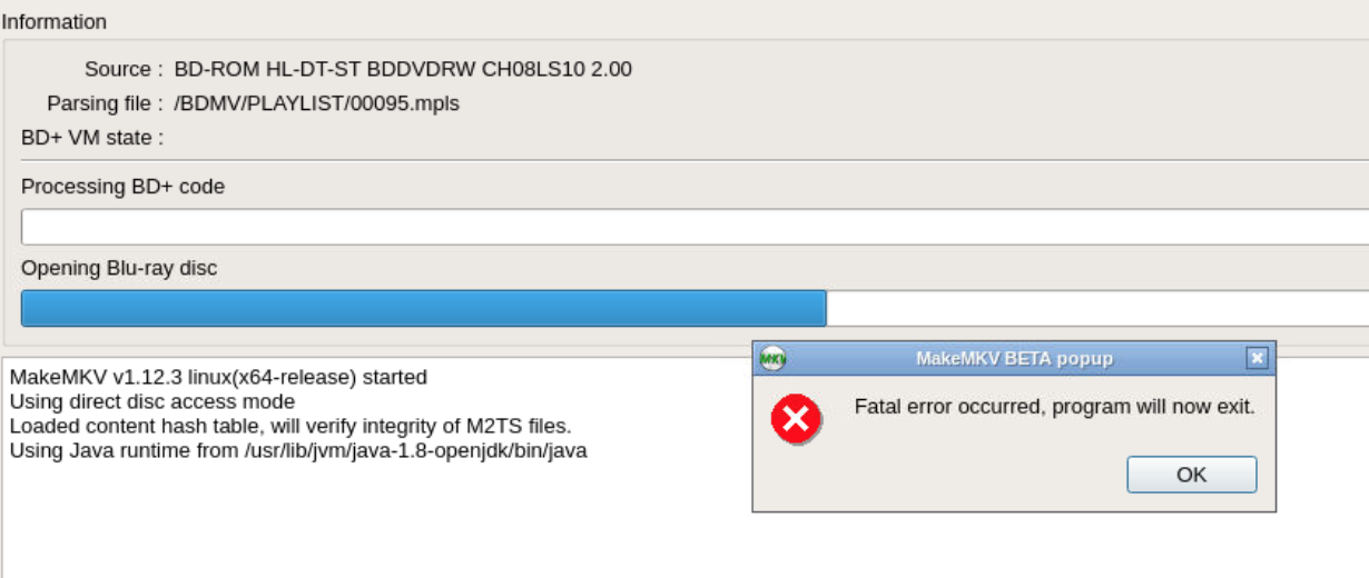

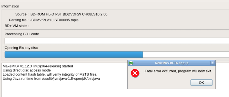

Here are the results now; however, I still get the error when trying to rip the disc.
186185945_ScreenShot2018-10-06at9_21_57AM.thumb.png.2d5c2d67318a4b07bf10a16c2de95734.png
1470153322_ScreenShot2018-10-06at9_25_07AM.thumb.png.a3aa8c6bb6baed5b4c06c62d5578a8b5.png
Edited by luisv
Looking at the playlist file you are parsing 00095.mpls, is it Sicario? I ran it last night, and it went fine after the change.
Your errors almost look like a firewall type issue between your unraid server and elsewhere.
Edited by cybrnook
Yes, Day of the Soldado.
Strange, I still see the same failure if I use MakeMKV to convert to mkv format. HOWEVER, that's not what I did last night. I use MakeMKV to "Backup" my disc's (whole disc, removing encryption), and then I use HandBrake to convert for me since it generates an equal quality video at a fraction of the size.
Try "Backup", and see if that works now. If it does, use Handbrake to then encode it to mp4. (Chapter 354 I believe)
Edited by cybrnook
Backing up is working!  What Handbrake settings are you using as I prefer to preserve all surround sound formats.  Since this question is out of the MakeMKV docker realm, feel free to PM me about Handbrake.
