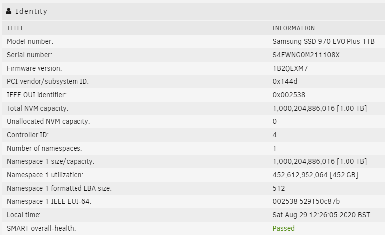

I have 2 NVME Drives both capable of 3000 mb/s write speed
Samsung 970 EVO Plus 1TB
Sabrent 1TB Rocket NVMe PCIe 1TB
I could write to both of those individually at 1000 mb/s using my fibre connection from my Desktop
Together as a BTRFS cache pool I am only getting 230 mb/s
I have installed the latest beta, removed and reinstalled both nvme drives as a cache pool and reformatted to the MBR: 1MiB-aligned
I have attached my diagnostics in case anyone can help please?
unraid1-diagnostics-20200827-0900.zip
Can anyone advise if I can safely change to an xfs pool please as BTRFS is too slow

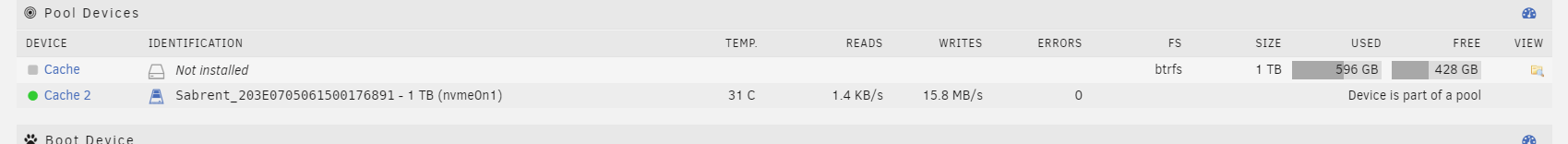

OK, I can only presume it is because of the mix of Sabrent and Samsung If the below looks ok to you I will purchase another Sabrent to see if it makes a difference.
image.thumb.png.c1ce6a599be71a789d6c49423bdc56eb.pngimage.png.ed2c571acb6e774abf5ff13df52e3654.png

I have removed the Samsung from the cache pool leaving a sole Sabrent Rocket but I am still only getting 230mb/s could this be due to the partition alignement? I can get 1000mb/s from this drive as an unassigned device or because unraid still thinks it is a pool rather than a single drive?
is this prooving that the sabrent rocket is the problem here?
No, this just means the pool itself wasn't the reason for the performance issues.
