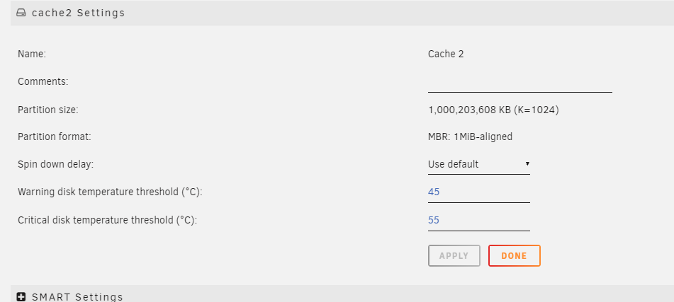

  • Running the latest beta 6.9.0-beta25 Formatted my SSD's to the new partition alignment.   Massive boost in speed on my Samsung 860Evo and Qvo drives! And not locking up when I do a

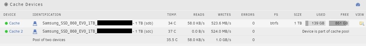

I'm using two Samsung 860 EVO 1TB drives in my cache pool in Raid1 and the server is NOT locking up for me when I transfer large files.  I already bought the drives before I saw this thread, but can still return them.  I like tweaking and tuning stuff so I was trying to reproduce the issues others are seeing in this thread before making the decision to possibly return the drives.  I can copy a 50GB file to the cache pool and don't see any issues.

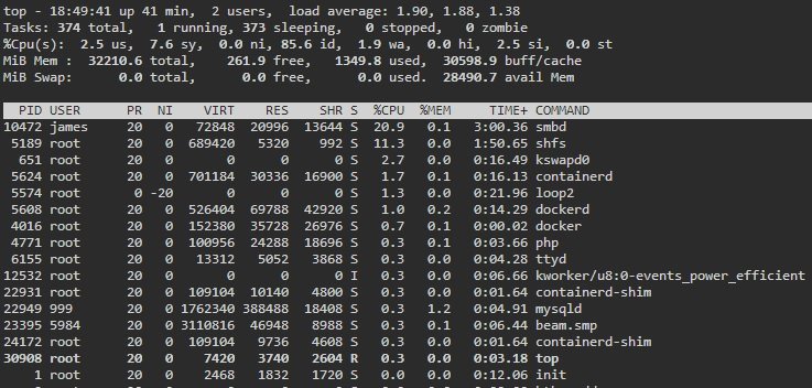

My main Unraid server is still running 5.0.  I recently upgraded my backup server from 5.0rc11 to 6.8.  Also, I swapped the case from a 4U Norco 4020 to a silent mid tower because I'm relocating the server to a different location (noise is an issue) and added the SSDs.
I installed a bunch of docker containers and a couple of VMs.  Tonight when I shutdown the server to add the second cache drive, after restart my VMs are no longer visible in the GUI.  Don't know why, started another thread on that issue here:
My Hardware Components:
CPU: Intel Xeon E3-1220 Sandy Bridge
Motherboard: Supermicro X9SCM-IIF-O
RAM: 32GB - 4x Super Talent DDR3-1333 8GB ECC Micron
Controllers: 1x IBM M1015.  Flashed in IT mode.
Case: Antec P101 Silent
Power Supply: CORSAIR HX750
Flash: 4GB Cruzer Micro
Parity Drive: 1x4TB Seagate ST4000DM000 5900RPM 64MB 4x1000GB CC43
Data Drives:  5x4TB Seagate ST4000DM000 5900RPM 64MB 4x1000GB CC43
Cache Drives: 2x1TB Samsung SSD 860 EVO 1TB
Hard drives are connected to the M1015.  SSDs are connected to SATA3 ports on the motherboard.

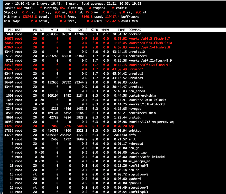

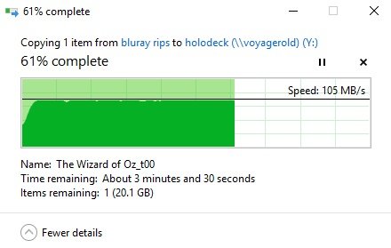

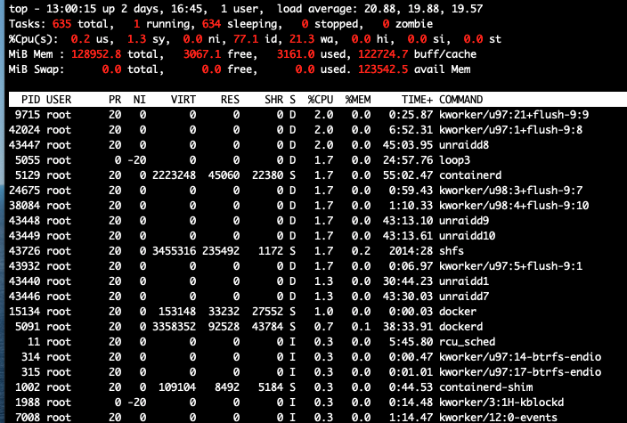

Multiple times I copied a 50GB file from a Win10 PC to my Unraid server over gigabit ethernet:
Cache pool during transfer:
Top during transfer:
So, during the transfer I was at about 2 load average, highest I saw was ~3.  I still need to figure out what's going on with the VMs, so I couldn't test with those.  But during the transfer I used several docker containers and didn't notice any performance impacts, including:

Everything appears to be working for me with 2 Samsung SSDs in my cache pool while copying large files.  Should my test have reproduced the problem others are seeing?  Anything else I can/should try?
Best Regards,
Jimmy
Edited by JimmyJoe

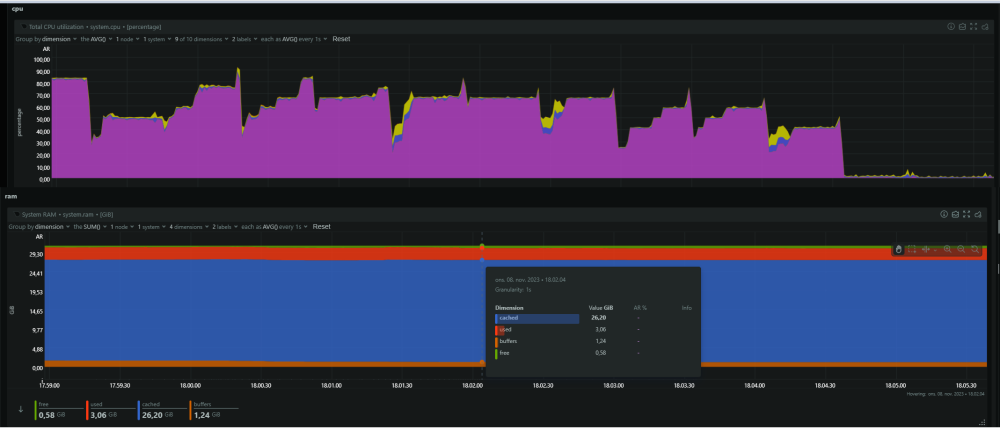

1433790756_Screenshot2020-03-3113_00_50.thumb.png.29ff3de80e7ee1cd3d457fa5cf6a96ee.png777445060_Screenshot2020-03-3113_00_23.png.6441e0b85f8be0db258cef34db2cb1c3.png
