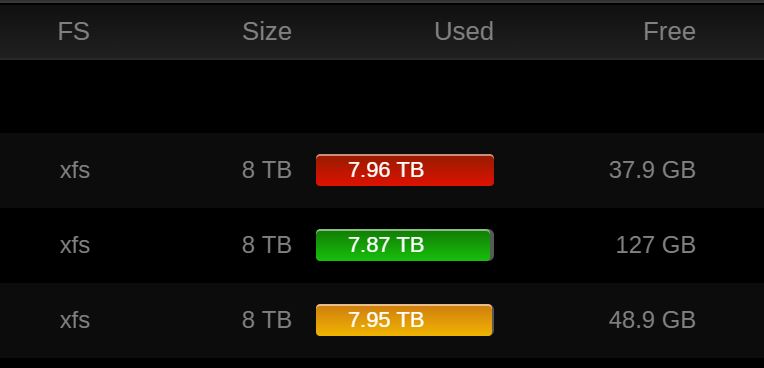

November 21, 20179 yr On 9/9/2017 at 2:14 PM, c3 said: I :+1: your request for getting the setting to allow decimals Thanks, I did some research on this. Ok first the problem... First I attached a picture below to illustrate the problem. Warning is set to 99%, Critical 100% using a 8TB drive as an example. 1% seems to be equal to roughly 40GB in size based on how unRAID is calculating it. The GUI then recieves this 'critical' state and shows red. 40GB doesn't seem like that big of a deal as a single drive, but when I multiply this across all my drives, potentially the unRAID max drive limit (28? 30? I forget) Let's just use 28 for the math... 28 * 40GB = 1.1TB of free space remaining, yet I'd be in critical state. That sounds like a lot, but if I had 28 drives at 8TB in size, that means I'd have 224TB of total space. Am I really going to care about only having 223TB out of 224TB due to this loss? I think the decimal place is still a good idea. It's curious that it's not a setting in the /config/disk.cfg, how does this work @limetech ?
