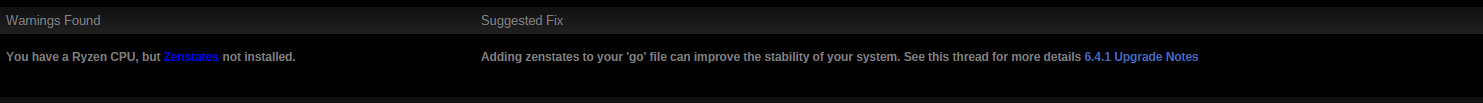

Hello,
why im getting this message? ive checked this topic and its mention to add zenstates do disable - from which reason? my system is stable, thanks
You're getting the message because the upgrade notes recommend to add that line to all Ryzen systems.  Whether or not you need to do so or not, I cannot answer.
@killeriq, if you don't add it, write yourself a BIG note and post on your server that you didn't do it.  That way if you do get a problem in the future, you will have a reminder of the first thing to try!
