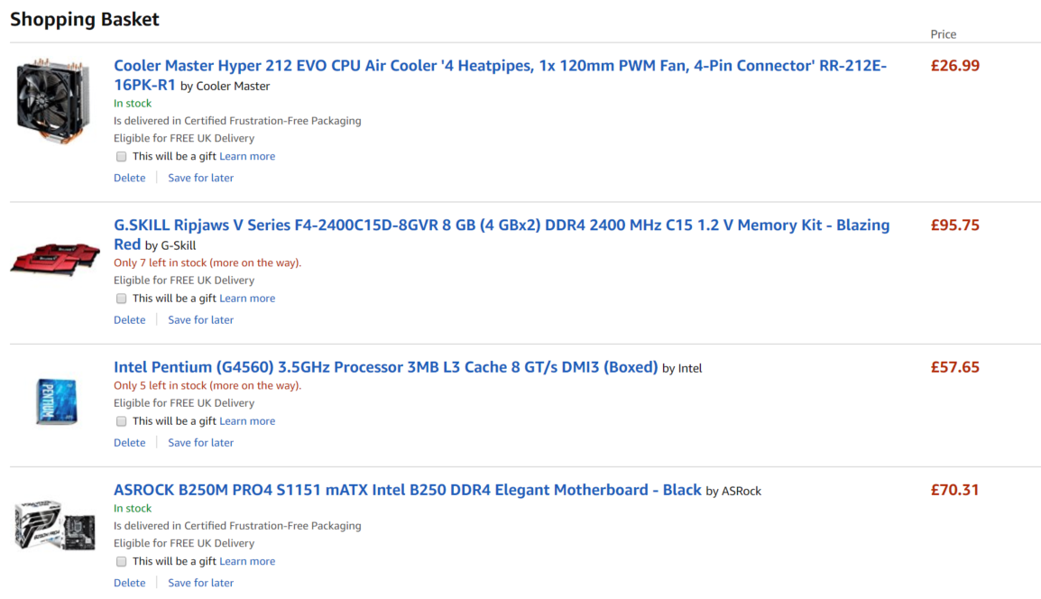

I'm new here and just about to start my first foray into an Unraid experience - i'd appreciate your feedback on my proposed build.
I've had a WHS 2011 build for a long time which i've only really used as a file server for backups and supporting a couple of Kodi boxes.
Just recently it kicked the bucket, and I was about to switch to unraid when the mobo also died. As such i'm more or less starting form scratch.
So far i've bought a new case and 2*4TB WD Reds, I also have a leftover 120gb SSD which i'm intending on using as a cache drive. I have about 8*2TB disks which i'd like to utilise until they give up, essentially. At which point i'll replace each one with a better drive.
The build I propose is as follows:
Does anything on there look unreasonable? I don't have any high demands of the server, mainly a fileserver with Plex running in a container (moving away from Kodi), I might add sickbeard etc at a later date, but ultimately i'm just looking for file and media server to begin with. I still have my main workhorse PC for the bulk of stuff. I'll potentially want to run a little webserver from it at some point as well, but i don't want that to influence the build.

Any observations on the build itself, or does it seem reasonable?
The build looks good for the use cases you mention. But can't help but mention that users are looking for mores power in their servers for VM and transcoding. You might look at a beefier CPU (this one is 2 cores / 4900 passmark) if you see a good chance of wanting to do more with the sever. 4 cores, with passmark closer to 9k or 10k would be more powerful and open up additional options.

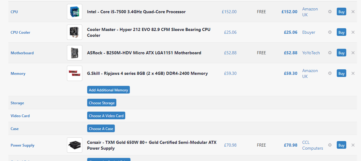

Hi everyone,
I've had a few days to dwell on all the responses and to not knee jerk into buying a build, so reconfigured to come up with the following:
https://uk.pcpartpicker.com/list/hzJnTB
Does this look like a better build? My decision making has mainly factored around reducing the cost on the mobo and ram given those things don't seem quite as important in an unraid world. The motherboard looks sufficient to me, and the ram, whilst a little older and only 8gb, I could add another two sticks to, or even replace if it begins to struggle.
Any thoughts? (I really can't stretch to an i7, sadly).
Hi -
That would make a very capable unRAID server, capable of basic NAS duties plus several Dockers and some Plex transcoding.
The CPU you've selected appears to include a stock cooler, so evaluate whether you need the Hyper 212 EVO.
