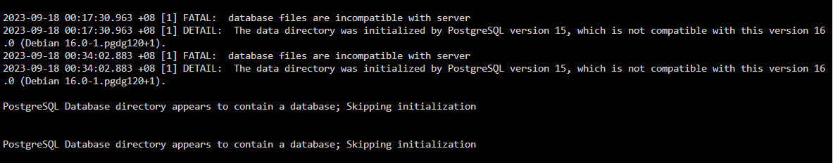

I'm using the tag :latest and I upgrade to version 16 from version 15.4. After upgrading, I got this error below:
How can I fix this? I temporarily go back to version 15.4.

Upgrading major versions isn't trivial with postgres and may break app compatibility too, so don't upgrade major version unless you have an absolute need, you're sure anything that accesses the PG server is compatible, and you can run manual DB upgrades...
https://www.postgresql.org/docs/current/upgrading.html

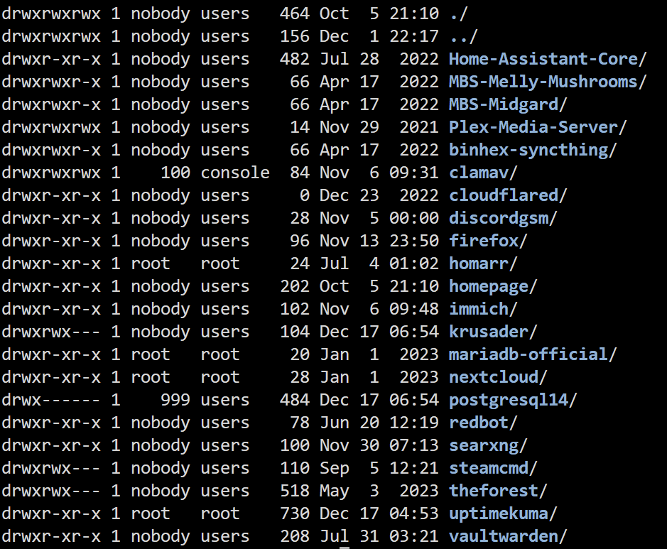

Looks like I found some other issue that the postgresql appdata CANNOT run from a user share even if it is set to only use a specific drive. Changed the mount point from /mnt/user/appdata/postgresql to /mnt/vmstorage/appdata/postgresql and it booted right up. Something about how unraid handles the file system and postgresql docker image not playing nice. Not sure why it ran for months without issue and then nothing but issues, but oh well.
Wow thanks, not sure I would have figured this out. I had it installed and working initially and somewhere in the process I switched to location to /mnt/user/share to properly use the FUSE system and it stopped working but I never thought that could be it.

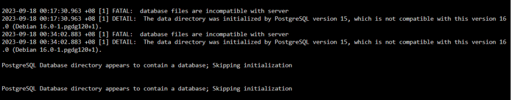

I HAVE THE SAME ISSUE!!!
PostgreSQL has a process, that you must follow for major version upgrades.

I think the last update overwrote file perms, but not sure. this is how it looks for me in my appdata folder.

Had next cloud runing for a couple of weeks fine with postgres. Then I wanted to add my first user.  Try to log in and next cloud wont respond and then this error message in postgres,   Only thing I can think of if there might of been an update from 15.4 to 15.5.  Not sure, as last time I had to delete the lot an start over.  and I gave up on nextcloud.  Help please!
That's normal PostgreSQL log at default level (LOG: indicates informative message). What's the exact error you are seeing?
User `postgres` is configured with ID 999 in the container. The docker entrypoint script configures the postgres data directories to be owned by that user, if container is started as root (but postgres is run as postgres user).
https://github.com/docker-library/postgres/blob/master/15/bookworm/docker-entrypoint.sh#L59
