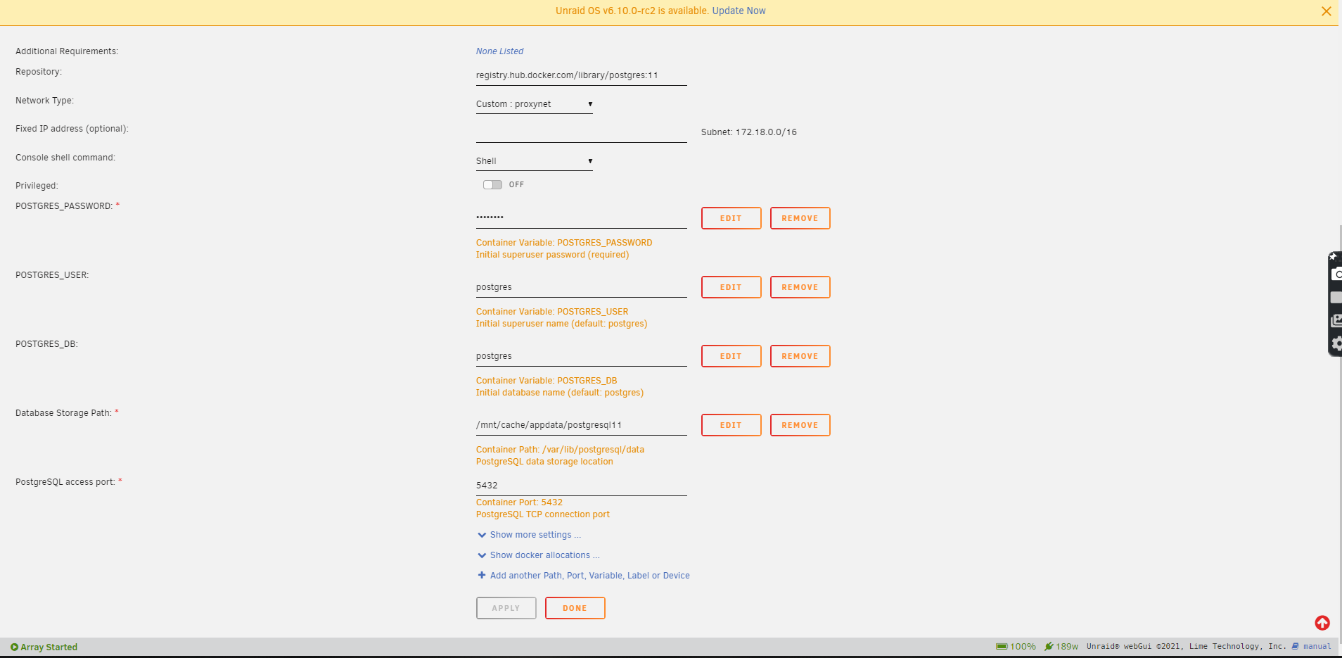

8 hours ago, Eddyall said:
Hello, recently made the error of deleting my Postgres11 docker instead of the pgAdmin 4 docker to which I lost the password for, I got the two dockers working again except I don't have my data it seems. I had two database for Szurubooru, one might be lost (lame but oh well) but the other shouldn't have been affected by me fumbling around with reinstalling the postgres docker. Post above for avlec were the solution basicly. However I'm not too sure about how to link/add the second database so the postgres docker can see it. Any simple way to add it back from pgAdmin? Or even not so simple ways
Edit: Suggestion on how to set up auto backup/snapshot for the docker image so I can more easily fix that kind of screw up in the future also welcome.
Howdy. Just deleting the Docker won't wipe your data, unless you specifically also delete the appdata folder (whether it is on the array or cache drive). So if the appdata is still there and you recreate the container (has to be the same major version of PostgreSQL), all the databases and the data should still be there. As for recovery, standard data recovery applies, but it is much harder to do with databases, since it is not just one file. And if part of it is missing, basically all is gone.
You can add additional databases when you log in as superuser `postgres` and run `CREATE DATABASE <name>;`. Security-wise I'd also recommend to have different users with the necessary permissions (e.g. one user can only access one database etc).
For auto-backups, you can run a cron job, that runs `pg_dump` or `pg_dumpall`. Alternatively you could use pgBackRest, but there is no template for it at this moment, it needs additional configuration and is more complicated.

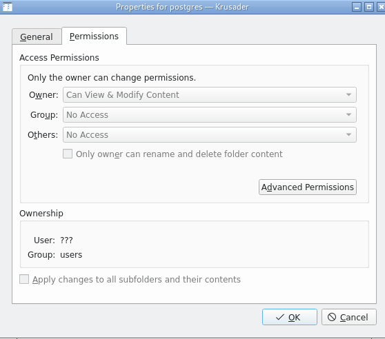

On 1/23/2021 at 6:17 PM, hrv231 said:
Hello,
I'm running now this docker and I also can't access the folder.
I even created another folder and pointed to it, and after starting the docker, the folder gets inaccessible.
Hi, I too have just stumbled across this permission issue. When the docker container is restarted, the 'postgres' app data folder loses the correct permissions. I'm able to correct this by running chmod -R u-x,go-rwx,go+u,ugo+X '/mnt/user/appdata/postgres' then chown -R nobody:users '/mnt/user/appdata/postgres' but after I restart the container, the permissions are gone. Any help would be appreciated as this was not an issue before.

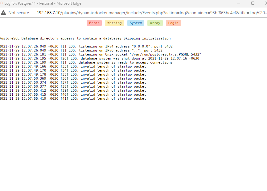

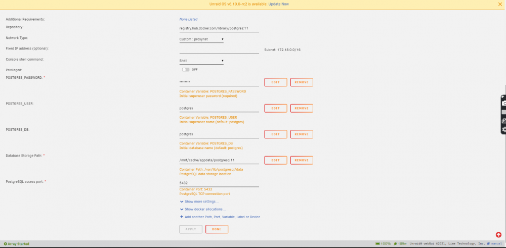

Hello , I install postgres 11 and unable to login suing ip address.
when i check the log, there is "invalid length of startup packet" . I tried different version, all of them give me same error.. may I know how should i preceed.
below is my setup for installation.
What version of psql are you using to connect to it? What error is psql giving? Server logs do not give very much information what the error is.

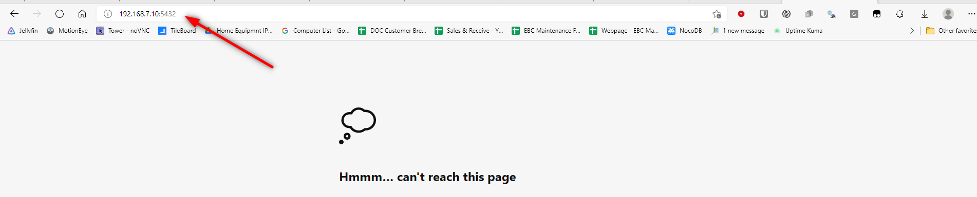

Hello, are you referring to how i connect it?
Port 5432 is not WebUI, it is PostgreSQL TCP port. This container only runs the database engine itself.
If you want a webUI, you need to find and deploy some other tool.
now i understand...thank you for your guide..
