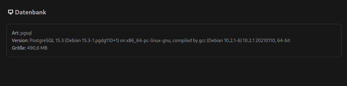

Hi jj9987,
I've used the Dump all data from the old version and imported it into the new V15 docker - the same way CryPt00n explained it.
According to the logs all connections seem to work. Still can't login in the web interface.
Could it be, that the password encryption changed between V14 and V15?
Edit: I've checked the tables in adminer and unfortunately they are there but empty - somehow the data is not imported properly with the command
psql -U nextcloud -d nextcloud < /var/lib/postgresql/data/bak.sql
if you wonder, my database is named only nextcloud
Edited by gilladur
I've dived a bit deeper in the dump_all command could it be that the option -s is incorrect?
# pg_dump -U nextcloud -s > /var/lib/postgresql/data/bak.sql
according to the postgres documentation:
-s
--schema-only
Dump only the object definitions (schema), not data.
This would explain why no data is in the tables after import and therefore I can't login with my login data or?
Edit: dumping the Database without -s did the trick - Nextcloud is now running fine under V15
pg_dumpall -U nextcloud > /var/lib/postgresql/data/bak14.sql

Hello, I am getting this error below:
WARNING:  database "example" has a collation version mismatch
DETAIL:  The database was created using collation version 2.31, but the operating system provides version 2.36.
HINT:  Rebuild all objects in this database that use the default collation and run ALTER DATABASE example REFRESH COLLATION VERSION, or build PostgreSQL with the right library version.
psql (15.3 (Debian 15.3-1.pgdg120+1))
Type "help" for help.
Can anyone help me please? I have search google but I can't understand. Below are some info that might help:
Unraid version: 16.12.0
PostgreSQL version: 15.3
Thanks in advance. 😉
Login to Postgres15 using adminer / pgadmin4 / psql and execute on each existing database:
ALTER DATABASE <dbname> REFRESH COLLATION VERSION;
