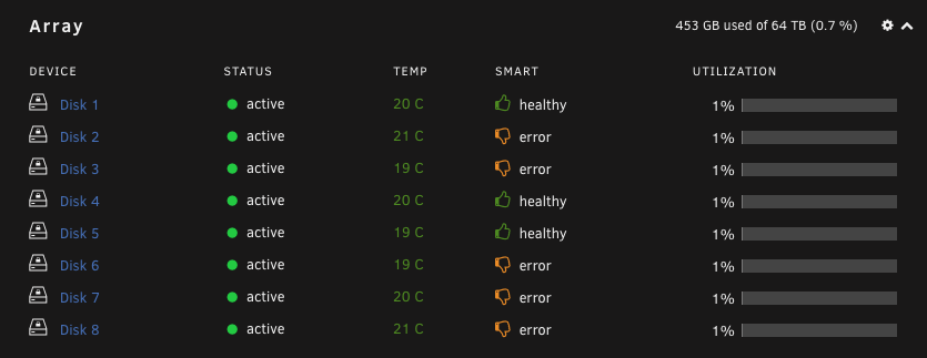

I have 5 of 8 8TB WD Red Drives that have a Cycle Count of 1 with this same error..  could this error correct itself in Unraid?  or should I replace these Disks?
CRC errors are a connection problem, just acknowledge them and as long as it doesn't keep increasing your fine, if it does start by replacing the SATA cables on the affected disks.
I purchased 8 - 8TB WD Red Drives the other night for my unRAID server I built.. I put them all in a booted.. 5 of the 8 drives showed those errors with the error count of 1. that's all.. I tried to zero the drives.   I moved them around and it didn't matter which bay they were placed in they always had the error..   I even placed them in the bays that the good ones were installed into..   I would just hate to waste money on my sata cables that go from my RAID card just to find out it doesn't work..  the count doesn't seem to be changing..   when I check the smart info in Crystaldiskinfo and other tools.. it all comes out perfect?  is there anyway in unRAID to ignore the count if it stays the same and just mark the disk as healthy?
Edited by ryanleeis
The CRC errors are permanently recorded in SMART. As long as you don’t get any more it should be ok.
As I recall, open the Dashboard tab.  Then click on the drive with the problem.  You should be able to tell it to ignore the error.   This means it will not report the drive as having a CRC error unless the count increases.
Thanks I can't seem to find the option to do that.. is there an admin setting or something ?  this would be great if it would show healthy then show error again if it increases..
Thanks..
In the section in the lower right corner of the Dashboard it shows all of your disks, with a column labeled SMART which shows the health of each disk with a thumbs up or thumbs down icon. Click on the thumbs down icon and you get a popup that lets you Acknowledge the current count. It won't warn you again unless it increases.

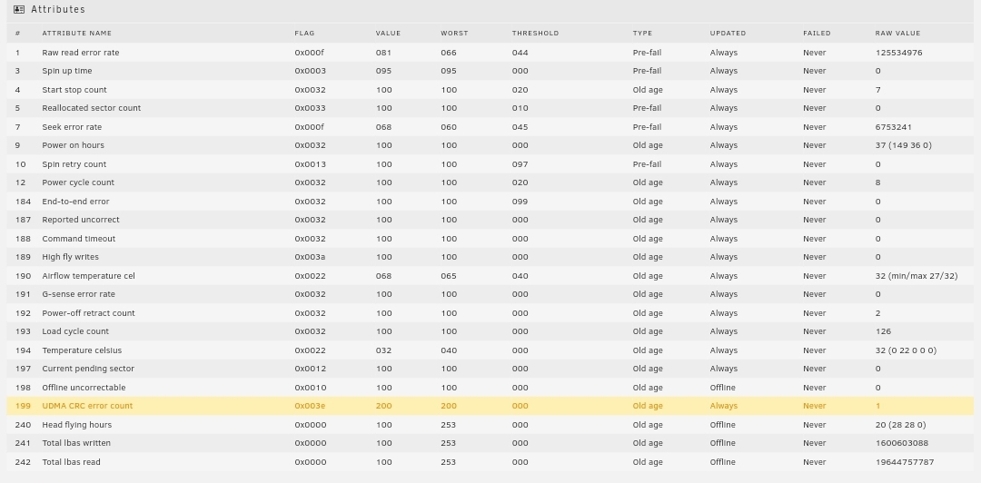

Hello,
I just got a new setup using 2x4TB Seagate Ironwolf drives. One of the drive is having this flag and udma crc count is 1.
I understand crc can be ignored, once I acknowledge the status becomes healthy. But issue is, on each reboot the alert pops back again and I need to re-acknowledge it.
Please let me know if this is intended behaviour of unraid? Or am I missing some other permanent way of acknowledgement.
It's just been 2 days I got the drives and have a replacement policy for 15 days, would it be good to get the drive replaced with a new one? Just don't want to carry smart error counts from beginning.
Thanks in advance :)
Edited by SaranG
You are not super clear about the number of errors.  Does this drive have only one error?  Or are you getting a new error on each startup?
You do know that on the Dashboard, you can click on the 'thumb-down' icon and accept/acknowledge the error and you will never hear about crc errors on that drive UNLESS more crc errors occur.  (As an aside, I have a drive that has 72,300 crc errors on it.  It has been a couple of years since the last one occurred.  Remember that crc errors are not actual drive errors in 99.99% of the cases.  They are data transmission errors.  Most of the time they are a cable issue.  (In my case, I had a cheap china-made two-port SATA card that was flakey.)  However, about half of my drives have one or more crc errors.  If you are getting more than one a month on a drive, you should be investigating to find the reason.
Edited by Frank1940
Hey there @Frank1940
Thank you for quick reply.
Attaching the current screenshot. I am considering RAW value which remains as 1. Should I bee seeing count on each reboot?
I think if it is the count, I will do couple of reboots and in case it is varying will reseat the drive and do cabling. Cables are brand new but I did tie both sata cables together. I read somewhere it should not be done, so I'll get back again checking these things later on.
Thanks again, have a good day!
CRC counts never reset to 0 - they can only stay stable or increase.

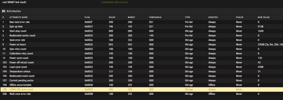

I too have been experiencing this issue lately. I see that possible root cause (from different posts in the forums) would be cable, the SAS card itself or the hard drive....
If the Card was the issue would we not see this error randomly on different drives or even or more than one drive?  Cable I can understand because of vibration and some reseating may need to be done.  If it is the quality of the cable the issue, what does the forum recommend for quality SAS cables ?
Thanks.
lsi 9211-8i  is the card I am presently using.
