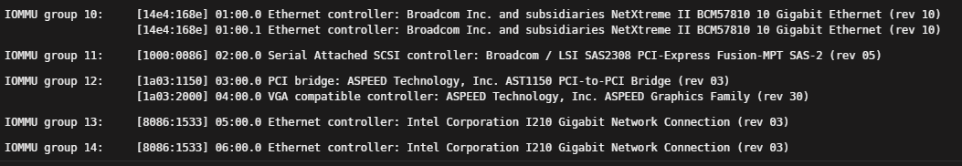

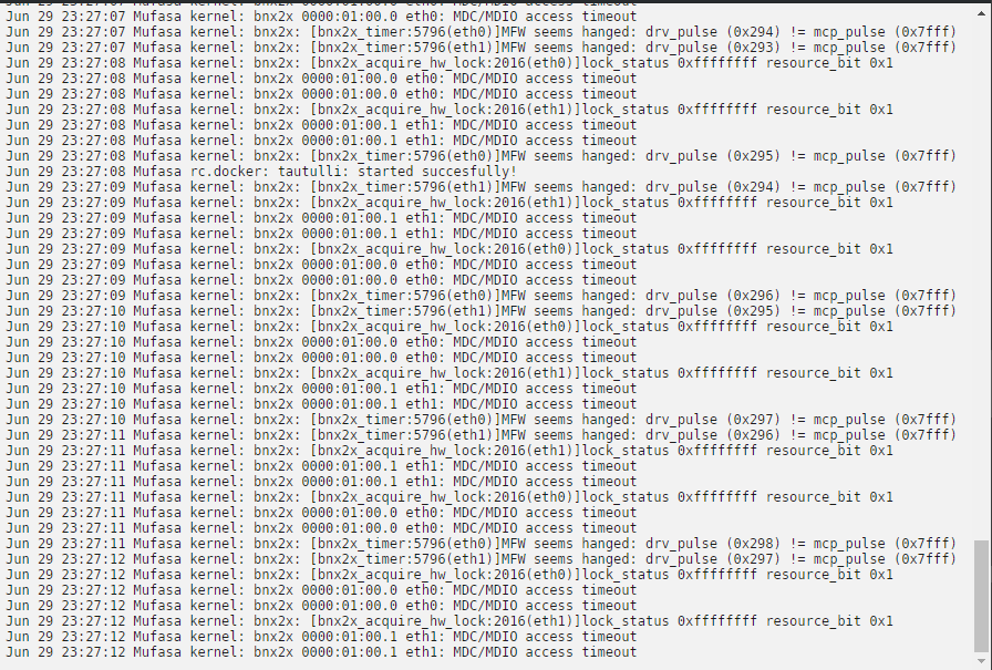

June 29, 20197 yr Hi all, Resurrecting this post from almost a year ago 😊. I just purchased a Dell Broadcom 57810 10GB duel nic and in the same situation as above. Below you can see my NetXtreme II BCM57810 in IOMMU Group 10 and my onboard duel 1GB nic's in group 13 & 14. So UNraid can see the new card. Problem is they just keep showing up as interface down Eth0 & 1 is set to the new 10GB card Eth 2 & 3 is set to the onboard 1GB card My log is currently being flooded with this. BNX2x is my 1 10GB port Attached is my diagnostics please help 😜 mufasa-diagnostics-20190629-2306.zip
