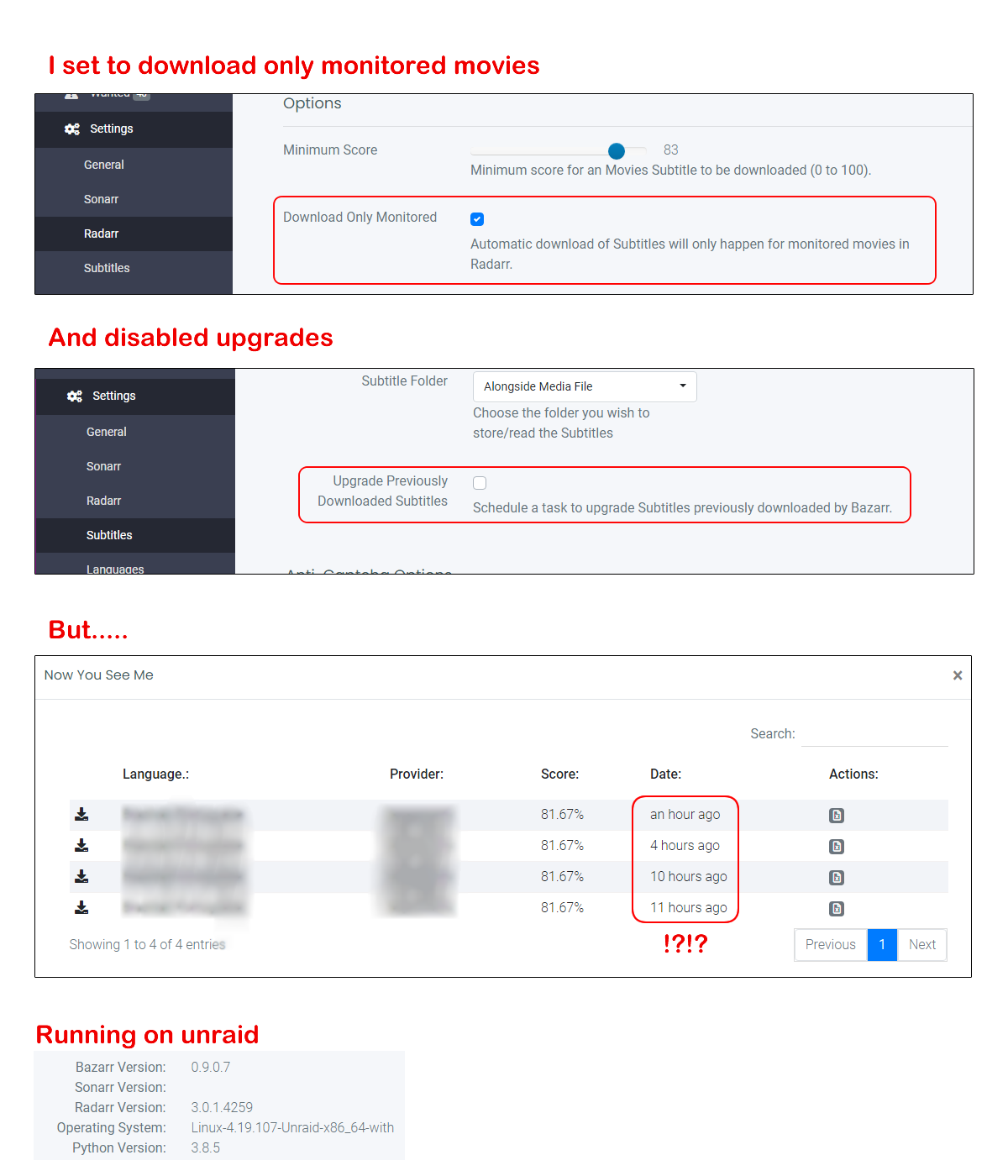

Is anyone else having this problem? Apparently bazarr is updating subs it shouldn't
I saw others report similar issues on /r/bazarr but that sub seems to be dead
fix: Disable single language in settings-->languages

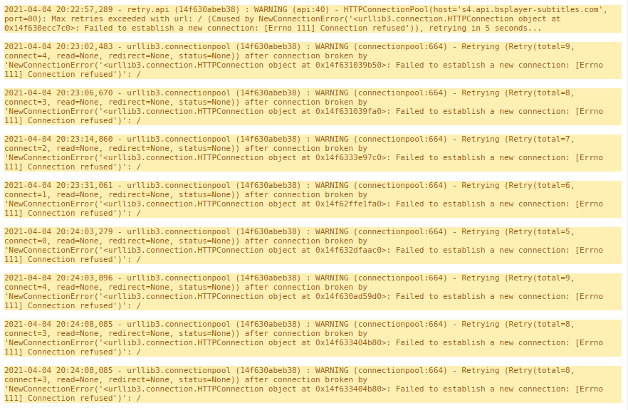

UPDATE: I have figured out how to get Bazarr to connect to the TV content directories(tv-show folder), but not the seasons or episodes. anyone solved this one before?
Hello guys, Bazarr used to work perfectly for me, but I recently noticed it was very slow at downloading subtitles. On closer inspection I see the following output in the log. Can someone point me in the right direction on how to fix or debug?
I've looked through the forum and online in general, but haven't found anyone with the same issue.
Thanks!
  • 5 weeks later...
Thanks!
I have this exact same issue and haven't been able to find a solution.  Let me know if you come up with anything!

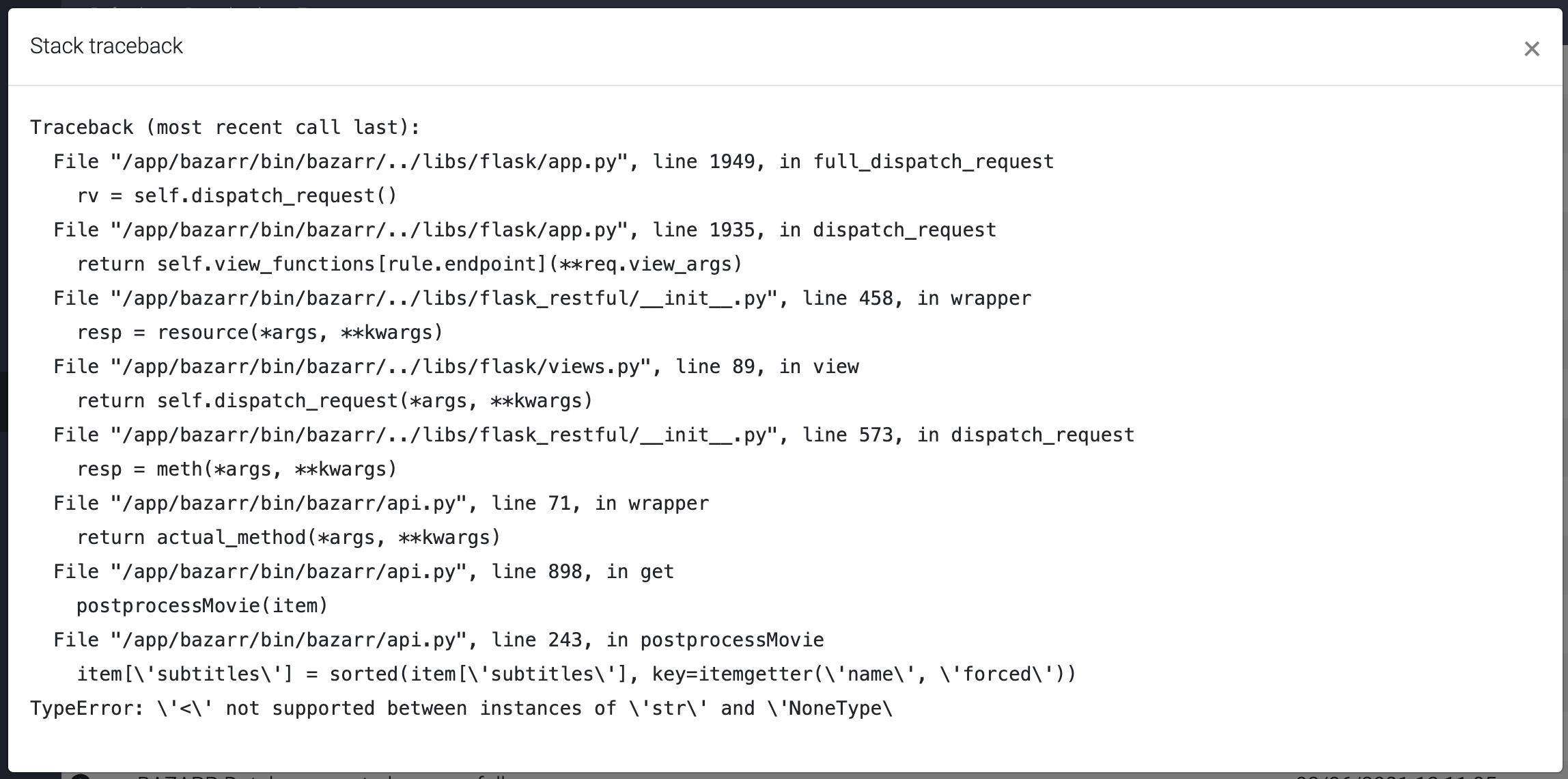

Hi all,
I've also been having problems with bazarr. Specially with the integration with radarr (as with sonarr is working perfectly). When I go to the movies tab i get a 500 error and in the l
ogs i get an api error "Exception on /api/movies [GET]". The detail of that error is below. I am using linuxserver images for everything rr (radarr, bazarr, sonarr and lidarr) and all of them are working just fine.
1252781445_ScreenShot2021-06-03at13_52_26.thumb.png.cba7255dfadb78c0d70645dd86b2a8b0.png
Edit: Also, when I search for a movie in the search box it works, and then after finding it the movie tab shows all movies, but when I want to mass edit all of them and add a profile it doesnt work and it crashes.
Any thoughts?
Thanks!
Edited by cookiemonsters
Add more details

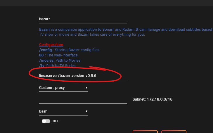

Anyone else not able to get to the web interface since the recent updates?
Had to go back to version-v0.9.6 in order to get things working.
Not working for me either right now
Hey how did you revert the docker to a older version?
0.9.7 from both Linuxserver and hotio launch the GUI for me just fine.
