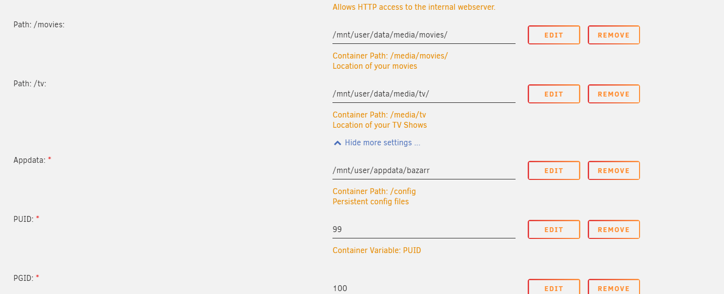

Hello,
I've got a "path problem" error in Bazarr (linux version)
I've using the regular trash guide folder structure
https://trash-guides.info/Hardlinks/How-to-setup-for/Unraid/
mnt/user/data
/torrent
  /tv
  /movies
/media
 / tv
  /movies
Works fine with hardlinking with sonarr and radarr
But now, i've got "path error" with bazar.
attacehd, my bazarr path configuration in docker, and my sonarr path configuration
Edited by Maitresinh

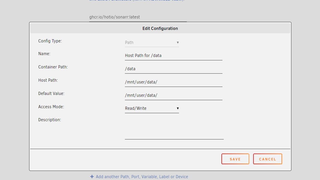

your sonarr has /data mapped to /mnt/user/data/, but bazarr has /media mapped to /mnt/user/data
both sides of the mapping must match, not just the host side.
you may have to delete the current mappings and remake them, as well as point bazarr to /data instead of /media inside the application. I'm not familiar with bazarr so I can't tell you specifically what to do.
thanks.

SEE HERE: https://forums.unraid.net/topic/196410-empty-share-folders-showing-on-cache-drive/#comment-1600996
I got this working, but I would really suggest that they add a permanent /tmp mapping to the template to /mnt/cache/appdata/bazarr/tmp/ or similar. otherwise if it gets stuck it will stuff your docker.img.
I'd also suggest doing the appdata link to /mnt/cache/appdata/bazarr/ since the sqlite database loves to lock up when running both sonarr and radarr at the same time for the first time.
