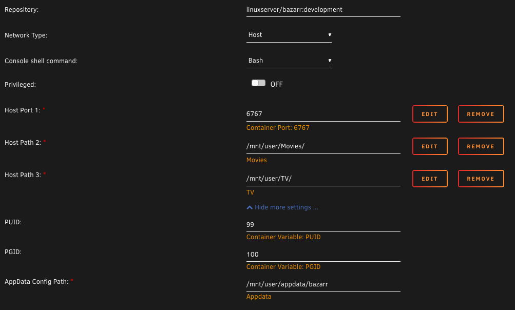

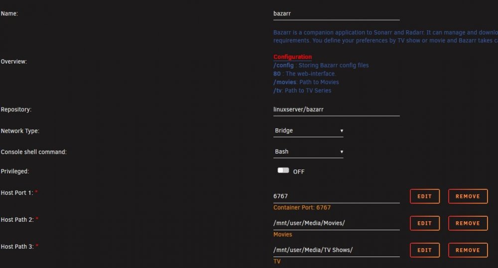

BTW the default template's Network Type isn't set and Bazarr won't start up. You need to manually set the "Network Type". Mine's at "Host" because I was trying out different things to troubleshoot, since it's working I haven't changed it.
This is my docker config, I'm using the development branch.
990293963_Screenshot2018-12-2614_25_04.thumb.png.5b46d30dd7d1a0112f675a94840bff7f.png

15 hours ago, vurt said:
What errors are you getting?

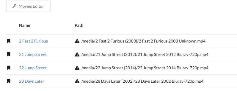

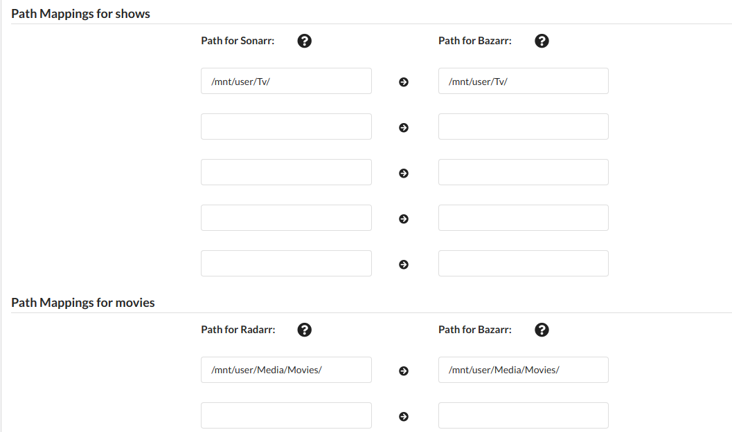

I am getting a path error in bazarr.  Movies path works fine, TV does not. Not sure why, this is my setup.
I have no path mappings set up in bazarr.
I'm not sure why Bazarr thinks your tv shows are stored at /tv/tv shows/. What happens if you tried to add the path mapping for TV within Bazarr? You should get on Bazarr's Discord, that's what I did for help.

Your paths are wrong. The easiest way to fix this is A) Find the correct paths and B) Delete the Bazaar container & it's appdata folder and start again (I discovered that in some cases, changing to the correct path doesn't always work if it's already logged the wrong one and it was easy to just start over).
Step 1) In the Bazarr container note Host Path 2 and 3. You'll link 2 to wherever your movies are, like /mnt/media/movies and 3 to tv, like /mnt/media/tv. Note these are *not the paths you use in the applications!* Like all containers, this just maps to an internal container path. *That's* what you use.
For the Unraid Bazarr container Movies are mapped to /movies and TV mapped to /tv. Note the case! It is case-sensitive. Inside the container itself that is where Bazarr sees the content. You can easily test this by opening up a console shell for the container and cd'ing to /movies and /tv - if you mapped this correctly you'll see a list of your respective files in each.
Step 2) You need to use the same *container* path for Sonarr/Radarr - the ones those containers are using. For example, Binhex-Sonarr/Radarr maps your directories to /media for those containers. So /mnt/media/movies (if that is your actual Unraid path) is mapped to /media inside the Radarr container, and so on.
Step 3) Use the respective container path mappings in Bazarr. In the above example, you'd use /media for both the Sonarr and Radarr path (left side) and /movies for Radarr /tv for Sonarr for the Bazarr mapping (right side).
Obviously you need to use the actual paths you are using. Quickest sanity check is just to open a console shell for all 3 containers and cd/ls each container path. That will insure you are using the right ones.
This probably seems obvious but I know sometimes container paths, especially when using containers from different sources, can get confusing, and the Bazarr instructions are somewhat unclear at the moment.
Last tip: After you get it working and Bazarr correctly scans all your shows/movies (it can take a bit) you can mass-edit the list and choose the languages, or language, you want to apply to them. Then do a sync (or wait for it to kick off on it's own, it's scheduled) and it'll be able to show you what you have and what's missing.

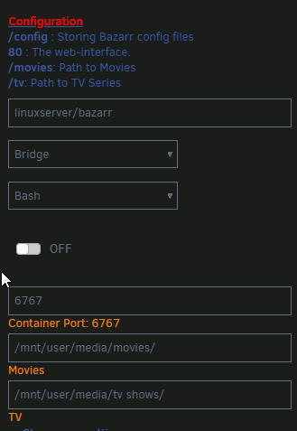

In the initial setup of the Bazarr container, you chose the path for where Radarr/Sonarr are currently mapped to, in my case:
This will set the internal mapping of the subtitle paths to /movies and /tv (NOTE THE cAsE. IT IS DIFFERENT THAN THE DOCKER TEMPLATE MAKES IT APPEAR TO BE DURING INITIAL SETUP.)
Actually maps like this. (Check the configuration page for those Host Paths)

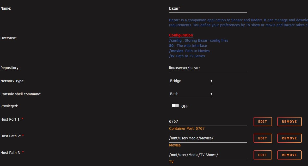

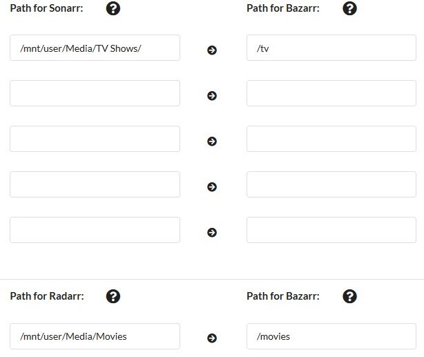

Hey guys. I'm trying to get Bazarr all set up but I'm pretty sure I FUBAR'd something. In the Bazarr webui it says that all of my paths are invalid for every file I have. It also will not find any subtitles for any of the content I have. I have made sure to set the Sonarr/Radarr paths and input my opensubtitles account info. You can see what is set up in my below screenshots.

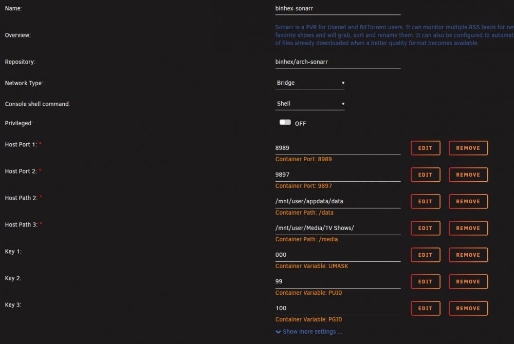

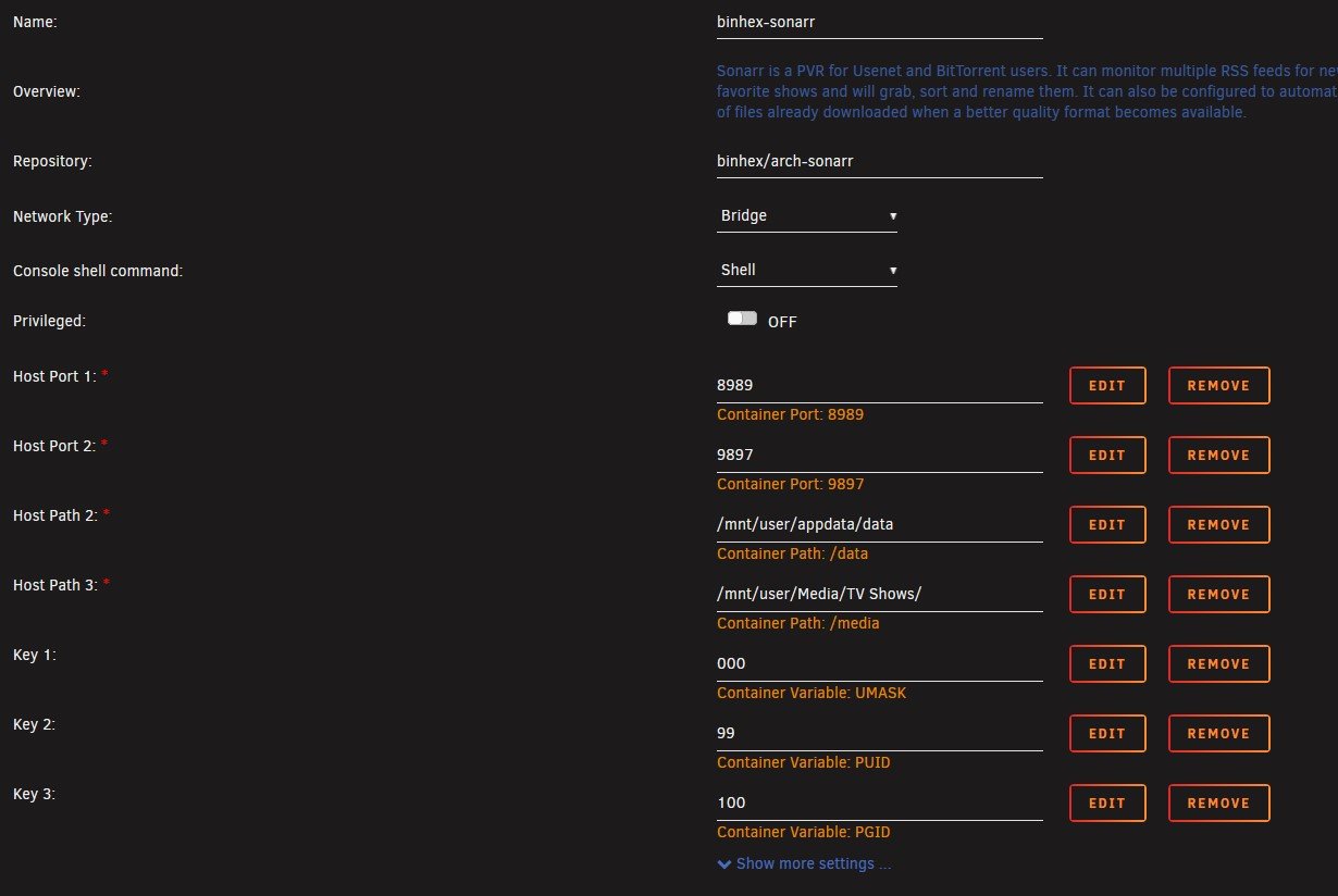

The path for Sonarr is wrong, it's probably also going to be /tv
It needs to be the path that the Sonarr container is using container side not host (Unraid) side.

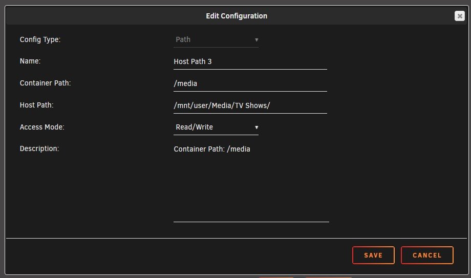

So I should replace it with container path as seen here?
EDIT: I changed it and it worked, so it at least sees the files now, but for whatever reason I can't find any subtitles for anything. Is there a way I can fix that too?

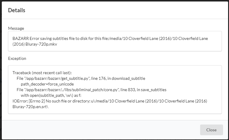

I fixed my problem posted above, but now I seem to be having the same problem/confusion that lots of others are in regards to paths for Bazarr and Sonarr/Radarr. No matter what I put in those path, it shows up as /media/ and "This path does not seem to be valid"
It sees all my TV shows and Movies and lists them just fine. But still shows that error.
If I try to manually force download the subtitles I get the attached error message in my log
Any help would be appreciated.

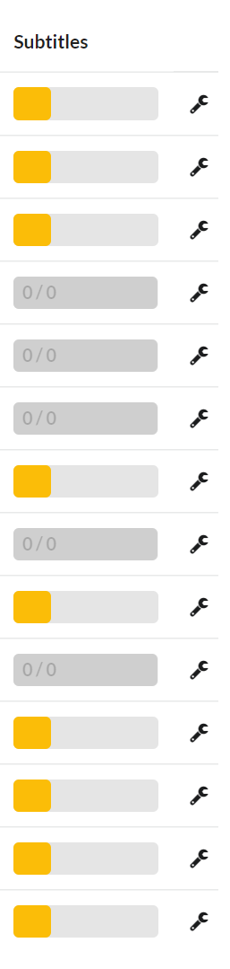

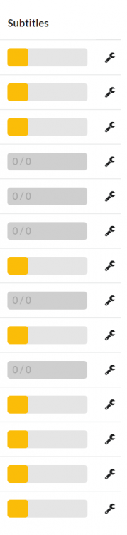

Hello everyone, I'm not sure why, but inside of Bazarr I never see anything that reflects the current count of subtitles. My paths work because I can download and subtitles and they save as expected.
Attached is what I see. Has anyone ran into this?
I have a problem with the paths. as you can see from the images here
https://imgur.com/a/zDWuKnZ
One of my paths has a space in the folder name and it fails when searching for the file (the space disappears)
I've tried several combinations, like
/movies/MOVIES\ ITA/
/movies/'MOVIES\ ITA'/
/movies/MOVIES ITA
/movies/'MOVIES ITA'
but nothing. The other path mappings works fine..
Can anybody please suggest me something?
/movies/MOVIES ITA
Don't use the container, but the first should work.  2 & 4 are definately wrong
If you're going to quote, it would be '/movies/MOVIES ITA/'
