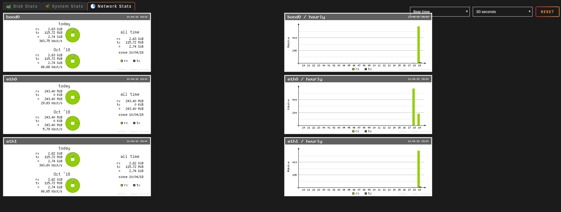

ok, got it working what I did was:
changed PIDFILE=/var/run/vnstat/vnstat.pid
and in the start line added -p $PIDFILE
rest was untouched
and this is what I get
i have to Shift Reload Page to get the graphs to update, leaving to another menu and coming back, it does not update
