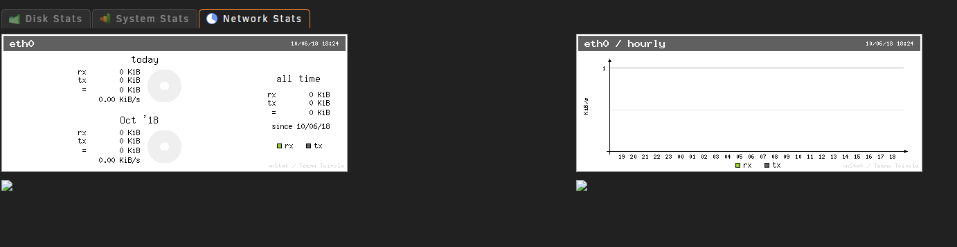

It's alive. Does not appear to be updating the data but the plugin is now running.
It will give it some time, also edit the settings to select your devices.
Spot on working perfectly now.

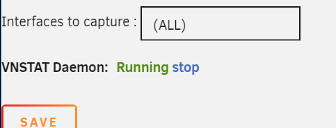

@dorganI just uninstalled, did not restart server and installed the new version. It's not working for me yet. I have to enable the vnstat again. I went to the terminal and it looks like there's a new one? I Don't know
[mention=78375]dorgan[/mention]I just uninstalled, did not restart server and installed the new version. It's not working for me yet. I have to enable the vnstat again. I went to the terminal and it looks like there's a new one? I Don't know
Try the manual copy, let me know if that works. Very odd
mmmm, I'm tech savvy, but I'm not unraid savvy if you can tell me the command I'll gladly appreciate it.
cp /usr/local/emhttp/plugins/networkstats/vnstat.conf /etc/vnstat.conf
That just did it. You are awesome
It's running, now I gotta see if it really works.

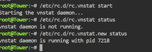

I have the 9/29/2018 version running and then did the 2018.10.06c update. Not the vnstat is no longer running.
I did go to the plugin settings and tried to click "Start". No luck.
Edited by Wayne66
Forgot to mention I tried to start vnstat service
