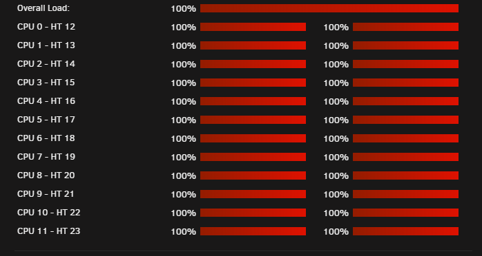

  24. Im having constant issues with the docker bringing my server to a crawl. Im migrating from qbittorent and it seems like everything I do in rtorrent maxes out my CPU utilization on my server and locks up the server. I've had to force reboot twice already. Simple things like deleting dead torrents that have been removed from trackers or force rechecking files so that I can get everything migrated is causing the server to be at 100% CPU most of the time. Ive never had this problem before installing this docker. In order to keep this from completely killing my server, I run operations on 5 torrents at a time and even still, I have issues with that. Does anyone know what may be causing this? I'm going to have to disable this docker until I find out why this is happening.
