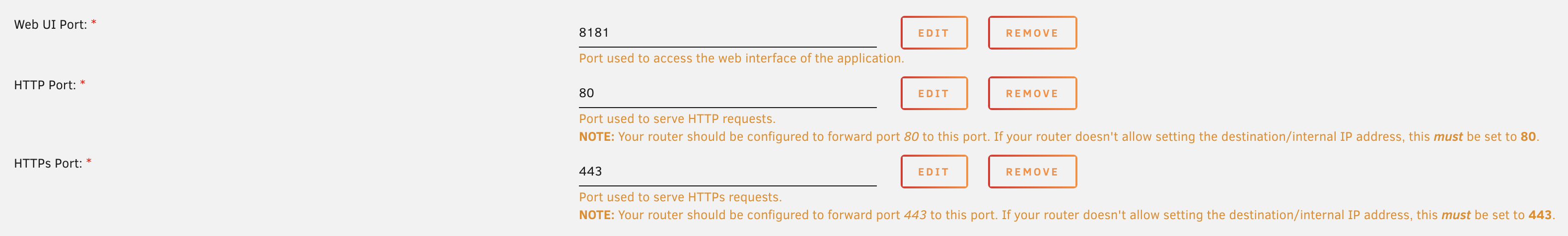

I'm trying to set this up for the first time, and I run all of my Docker containers in Unraid with the 'Custom' network setting selected so that I can map an individual IP to the container in my network.
I also tried to set the Web UI Port, HTTP Port and HTTPS Port options in the Unraid Docker app config to the standard ports (8181, 80 and 443 - attached in the picture below) which appear to be setting environmental variables in the docker command, but it seems the container starts and defaults to the standard ports of 8181, 8080 and 4443 and ignores the environmental variables set to change the application ports in the container.
Has this feature been changed? I can't seem to get it to work :(
Thanks.
If you want to change the ports, you need to use the "Bridge" network mode.  The port mapping between the host and the container only works/applies to this network mode.
