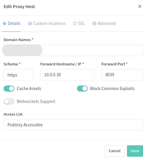

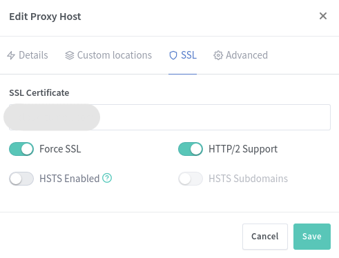

Hi all,
I'm having trouble getting Nextcloud setup with NPM, all I get is a 502 Bad Gateway. My Nextcloud config has:
'trusted_domains' =>
  array (
    0 => '10.0.0.30:4039',
    1 => 'cloud.domain.com',
  'trusted_proxies' => ['letsencrypt'],
  'overwrite.cli.url' => 'https://cloud.domain.com/',
  'overwritehost' => 'cloud.domain.com',
  'overwriteprotocol' => 'https',
and my NPM and Dockers are set out in the images. I've also tried with both dockers just set in the standard bridge network, but no dice. Any help would be greatly appreciated!
NPM details. Custom Locations is blank.
NPM SSL. Advanced is blank.
Edited by awilderaid
What's with the trusted_proxies line?
Saw it posted somewhere while I was trying to find a fix for this. Just looked into it now, no idea what the 'letsencrypt' setting is supposed to be as it takes IP addresses. That's now fixed to read:
  array (
    0 => '10.0.0.30',
    1 => '127.0.0.1',
    2 => '192.168.255.10',
But no dice. Removing it completely also doesn't work.
Maybe try reverting the config to a default one. I haven't had much experience with setting up alternate networks but it seems the 502 Bad Gateway is connected to nginx proxy manager being unable to route to the docker you want - as per the post directly above yours.
I'd start with a fresh config if I were you, and make sure to clean up the appdata so you don't just get the old config back.
I can't see anything in your settings that would explain it. Maybe someone else can spot it though, as I'm far from an expert.
