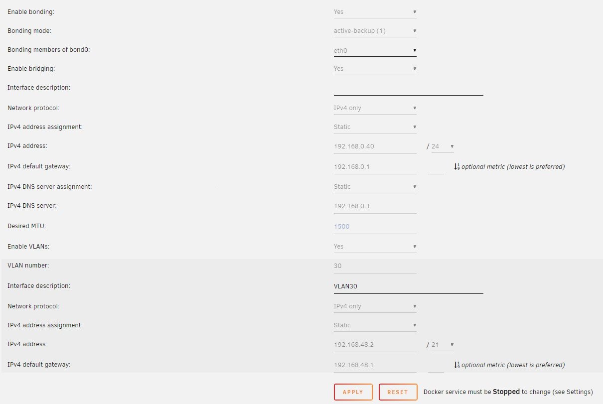

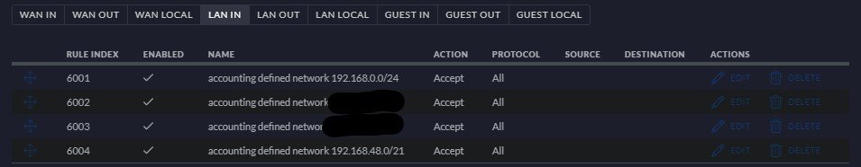

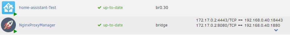

Installed this plugin for my Unraid 6 Server and love the UI and the simplicity.
However when Im trying to add webservers from a different VLAN I cant access them trough nginx
getting this in the "error" logfile:
[error] 1971#1971: *2095 connect() failed (113: Host is unreachable) while connecting to upstream
and 502 Bad Gateway, when trying to connect to the webserver in Chrome.

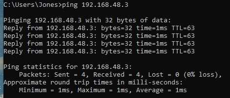

Running Unifi with "Corporate network" on both VLANs so the firewall sould route traffic trough
I can access 192.168.48.3:8123 fine when in using a pc on 192.168.0.0 network.
Is this a NGINX config error or a firewall error?

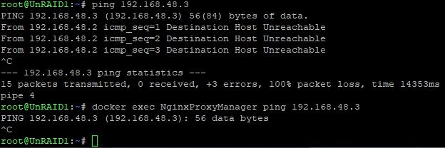

From unRAID, are you able to ping 192.168.48.3?  And from the container (docker exec NginxProxyManager ping 192.168.48.3)?
No I could not

On 2/21/2019 at 12:52 PM, zJonesz said:
No I could not
That's your issue.  Looks like unRAID doesn't have the proper route to reach your network.  You may want to seek for help about this in a  more appropriate thread on the forum.
