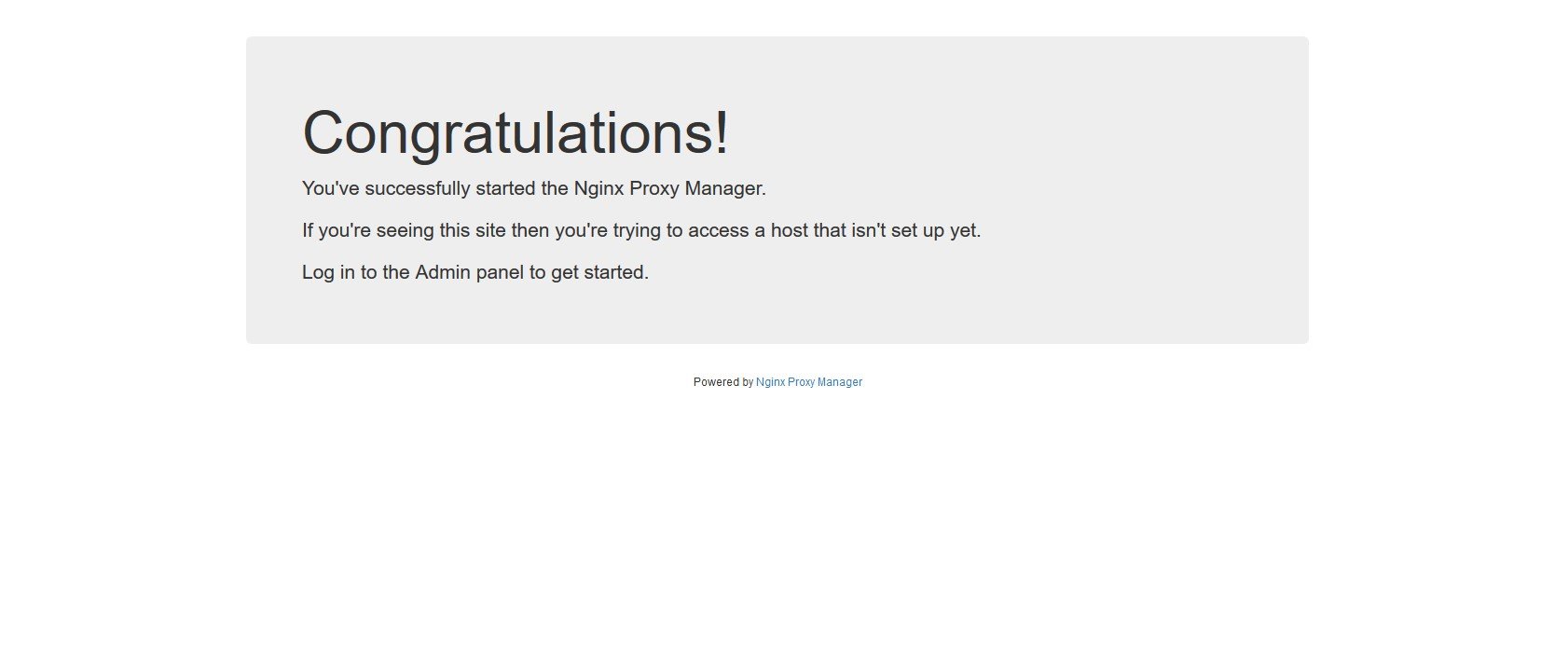

I'm definitely missing something here...
So, I've installed NPM using the CA option in Unraid, and then I copied the config.json into /mnt/user/appdata/NginxProxyManager. After that, I went to DuckDNS and set up a new subdomain (e.g. "phishfiSonarr"), then in NPM I added phishfiSonarr.duckdns.org and pointed it to local.unraid.ip.address (unraid's IP address on my internal network, port 8989 (Sonarr default). I went without an access list or SSL setting just to get it working first, but nothing's showing up (when I click/browse to phishfiSonarr.duckdns.org, it times out).
Please let me know what I'm missing. Based on all the other comments, it's clear I must be missing something easy here, but I read through the readme, all the comments, and the issues on Github and I'm stuck.
Thanks!
Why this?
Did you verify that the DNS name resolves to the correct IP (should be your internet/public IP)?
Are you using default container settings?
Are you sure that ports 80 and 443 are properly forwarded to the container?
1 minute ago, Djoss said:
Why this?
Reading through the readme, I thought it said the container would not work without setting up your own config file. After getting the "internal error" from attempting to create an SSL cert, I assumed that was a potential cause.
I did. When I browsed to the DDNS link, it shows the "Congratulations" site indicating Nginx is working and accessible.328127773_Annotation2019-01-07192558.thumb.jpg.3e07bbaf4e10320875c5926c43e6b441.jpg
I see this congrats page, even though I have NPM set to direct this DuckDNS subdomain to one of my Docker apps (Ombi, this time, if that makes a difference).
I am. For the sake of simplifying this whole thing, I've gone with ports 80 and 443 directly, and I've ordered my router to point those ports to my unraid server.
See above (yes).
Thanks for your help!
See above (yes).
It seems to have a mismatch between the configured DNS name of the proxy host and your DuckDNS domain.  The congrats page is shown when you reach NPM through an unconfigured IP/DNS name.
Are you testing from your local network?
