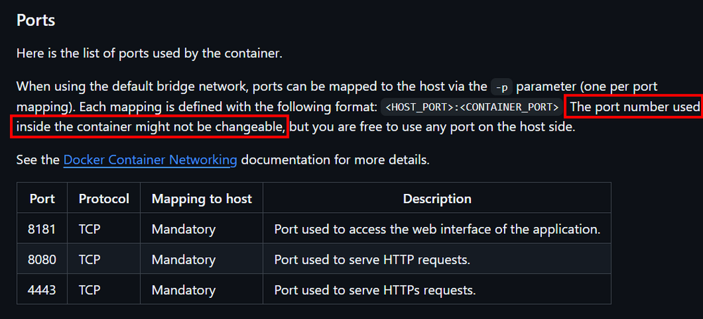

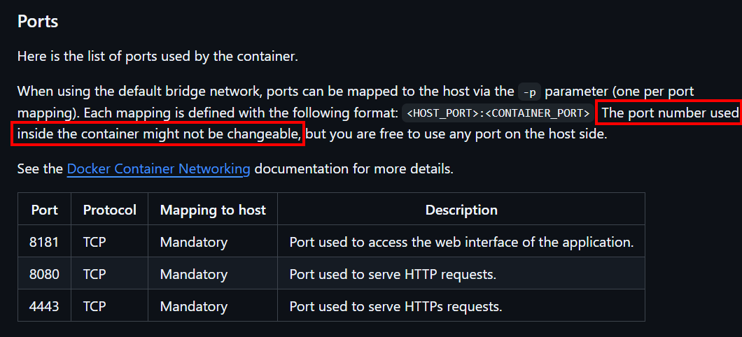

How can i change the internal container ports to 80 and 443 instead of 8080 and 4443 ? I use this container inside a tailscale container and need the ports to be that way since i do not forward
looks like this docker is not designed to change it
I do have a fork that only changes the ports to 80/443 that I have been using for quite some time. (And I think also a couple of other people). Let me update it real quick with all the latest changes as I have not done that in quite some time :)
Use this one instead

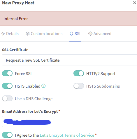

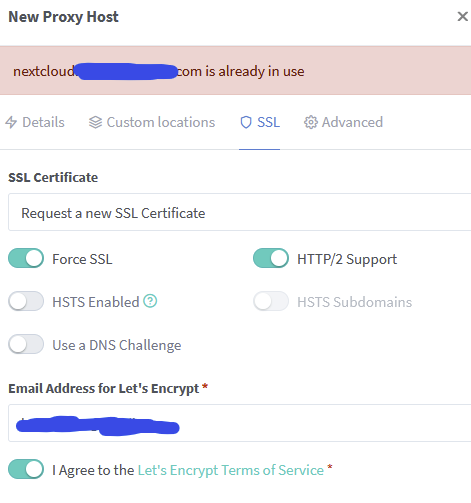

I have been using SWAG for some time but would like to transition to NGINX PM for various reasons (really ease of use).  When I installed and went to set up the proxy, I got the error that the domain was already in use.  I tried revoking my certificates via SWAG/Cert Bot however, I still wasn't to fix the issue.  Do you have or are you aware of the steps on how to migrate (certificates) from SWAG to NGINX PM?  Particularly, I am using SWAG for Nextcloud.
You can technically migrate certificates. But: you don't need to, if everything is set up you just get new certificates from letsencrypt.
What exactly is the problem? And how is it set up?
So when I try to obtain new SSL, I get this.  Not that I do have HSTS enabled via cloudflare.
However, when I uncheck the box, it seems to work but I get this:
It seems to not want to issue a new cert because one is already issued.  I actually tried to revoke (and delete) my cert in SWAG but that didnt seem to work either
Can you chech the certificate view in NPM? Perhaps it did made one and you can just use it. Or chech the drop down where it says 'request new'
