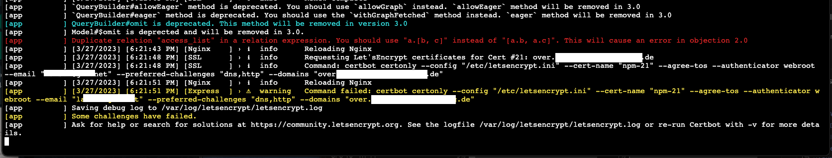

Hi
after reinstalling npm, I got 10 out of 12 redirections to my containers running properly. I´m stuck with those two and I don´t understand why.
Any idea whats the problem here?
Links are available outside my network, I get a "deceptive site ahead" or "NET::ERR_CERT_AUTHORITY_INVALID" message
NPM_log_cleanedup.txt
Edited by antagon

On 3/27/2023 at 6:27 PM, antagon said:
Hi
The log file lists it already:
        "detail": "DNS problem: NXDOMAIN looking up A for dom.main-name.com - check that a DNS record exists for this domain; DNS problem: NXDOMAIN looking up AAAA for dom.main-name.com - check that a DNS record exists for this domain",
Please confirm that your DNS is correctly set-up.

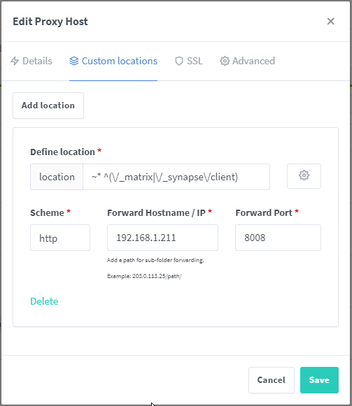

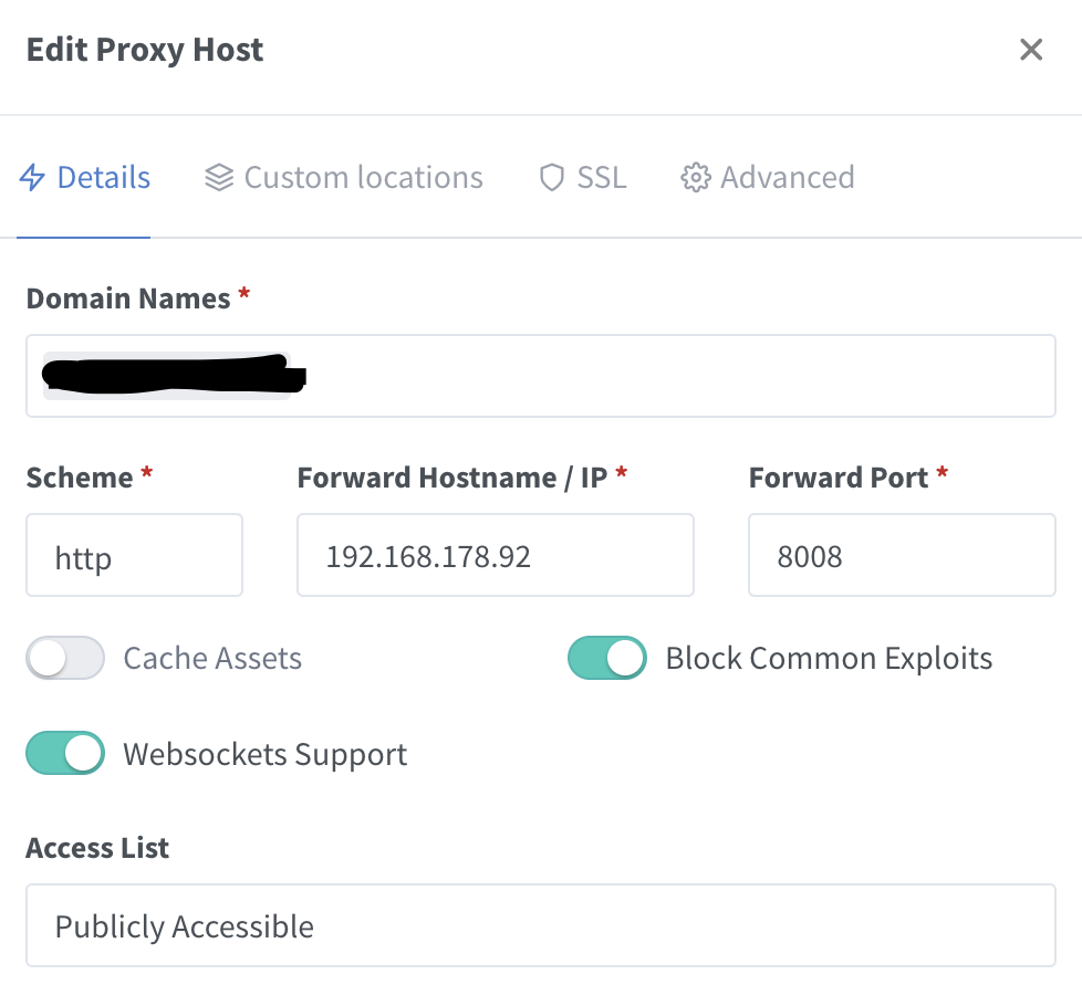

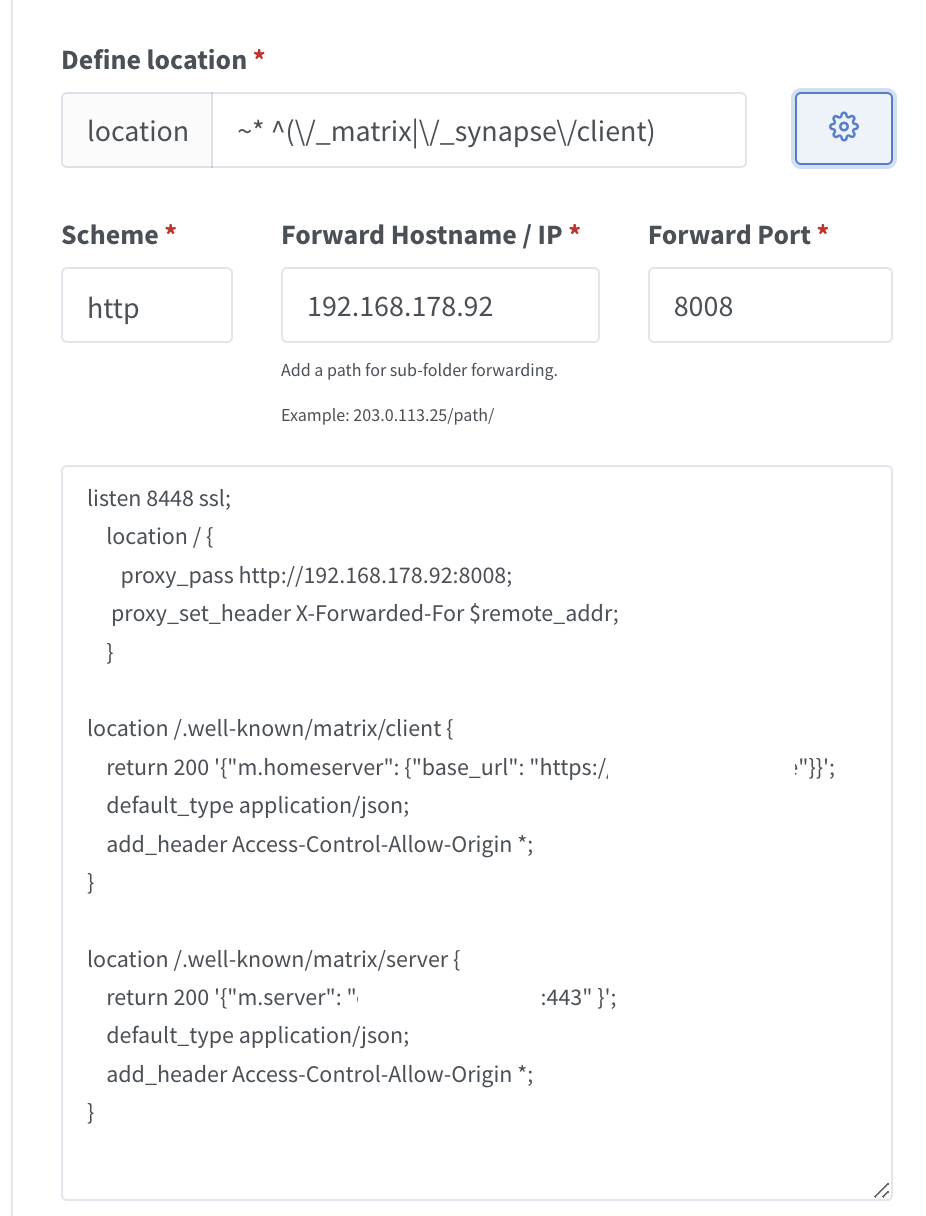

14 hours ago, masterdot said:
Did you get it running? I do have the same problem with my setup :(
custom locations
listen 8448 ssl;
    location / {
       proxy_pass http://192.168.1.211:8008;
     proxy_set_header X-Forwarded-For $remote_addr;
location /.well-known/matrix/client {
    return 200 '{"m.homeserver": {"base_url": "https://matrix.domain.com"}}';
    default_type application/json;
    add_header Access-Control-Allow-Origin *;
location /.well-known/matrix/server {
    return 200 '{"m.server": "matrix.domain.com:443" }';
1509137800_Bildschirmfoto2023-05-04um19_56_32.thumb.png.13f2b1868d5dc14478be78d29d944258.png1775379775_Bildschirmfoto2023-05-04um19_56_25.png.e1f5f4cf1d7dec9f34d8e5bdcf525399.png1799664971_Bildschirmfoto2023-05-04um19_56_13.thumb.png.99c192b80d08c3e3714b728b0db70ad0.png794975970_Bildschirmfoto2023-05-04um19_55_53.thumb.png.7795802741f3c06340ebd3e9d4d14099.pngHmm... I did transfer it, but now the proxy manager is showing up the domain as offline. Seems to be a problem with my changes...

[app         ] [6/1/2023] [11:16:59 PM] [Migrate  ] › ℹ  info      [stream_domain] Migrating Up...
[app         ] [6/1/2023] [11:16:59 PM] [Setup    ] › ℹ  info      Creating a new JWT key pair...
[supervisor  ] all services started.
[app         ] [6/1/2023] [11:17:01 PM] [Setup    ] › ℹ  info      Wrote JWT key pair to config file: /opt/nginx-proxy-manager/config/production.json
[app         ] [6/1/2023] [11:17:01 PM] [Setup    ] › ℹ  info      Creating a new user: [email protected] with password: changeme
[app         ] [6/1/2023] [11:17:02 PM] [Setup    ] › ℹ  info      Initial admin setup completed
[app         ] [6/1/2023] [11:17:02 PM] [Setup    ] › ℹ  info      Default settings added
[app         ] [6/1/2023] [11:17:02 PM] [Setup    ] › ℹ  info      Logrotate Timer initialized
[app         ] [6/1/2023] [11:17:02 PM] [Setup    ] › ℹ  info      Logrotate completed.
[app         ] [6/1/2023] [11:17:02 PM] [IP Ranges] › ℹ  info      Fetching IP Ranges from online services...
[app         ] [6/1/2023] [11:17:02 PM] [IP Ranges] › ℹ  info      Fetching https://ip-ranges.amazonaws.com/ip-ranges.json
[app         ] [6/1/2023] [11:17:02 PM] [IP Ranges] › ℹ  info      Fetching https://www.cloudflare.com/ips-v4
[app         ] [6/1/2023] [11:17:02 PM] [IP Ranges] › ℹ  info      Fetching https://www.cloudflare.com/ips-v6
[app         ] [6/1/2023] [11:17:02 PM] [SSL      ] › ℹ  info      Let's Encrypt Renewal Timer initialized
[app         ] [6/1/2023] [11:17:02 PM] [SSL      ] › ℹ  info      Renewing SSL certs close to expiry...
[app         ] [6/1/2023] [11:17:02 PM] [IP Ranges] › ℹ  info      IP Ranges Renewal Timer initialized
[app         ] [6/1/2023] [11:17:02 PM] [Global   ] › ℹ  info      Backend PID 417 listening on port 3000 ...
[app         ] [6/1/2023] [11:17:02 PM] [Nginx    ] › ℹ  info      Reloading Nginx
[app         ] [6/1/2023] [11:17:02 PM] [SSL      ] › ℹ  info      Renew Complete
[app         ] [6/1/2023] [11:18:01 PM] [SSL      ] › ℹ  info      Testing http challenge for *.xtu.icu
[app         ] Uncaught SyntaxError: Unexpected end of JSON input
[app         ] FROM
[supervisor  ] service 'app' exited (got signal SIGILL).
[supervisor  ] service 'app' exited, shutting down...
[supervisor  ] stopping service 'nginx'...
[supervisor  ] service 'nginx' exited (with status 0).
[finish      ] executing container finish scripts...
[finish      ] all container finish scripts executed.
** Press ANY KEY to close this window **
Obviously this is not supposed to happen...
Actually it seems to kill itself any time it does an HTTP challenge:
[app         ] Duplicate relation "access_list" in a relation expression. You should use "a.[b, c]" instead of "[a.b, a.c]". This will cause an error in objection 2.0
[app         ] [6/1/2023] [11:22:03 PM] [Nginx    ] › ⬤  debug     Deleting file: /data/nginx/proxy_host/1.conf
[app         ] [6/1/2023] [11:22:03 PM] [Nginx    ] › ⬤  debug     Could not delete file: {
[app         ]   "errno": -2,
[app         ]   "syscall": "unlink",
[app         ]   "code": "ENOENT",
[app         ]   "path": "/data/nginx/proxy_host/1.conf"
[app         ] }
[app         ]   "errno": -2,
[app         ] }
[app         ] [6/1/2023] [11:22:03 PM] [Nginx    ] › ⬤  debug     Deleting file: /data/nginx/proxy_host/1.conf.err
[app         ]   "errno": -2,
[app         ]   "path": "/data/nginx/proxy_host/1.conf.err"
[app         ] }
[app         ] [6/1/2023] [11:22:03 PM] [Nginx    ] › ℹ  info      Reloading Nginx
[app         ] [6/1/2023] [11:24:14 PM] [SSL      ] › ℹ  info      Testing http challenge for xtu.icu
[app         ] FROM
You can try to run certbot manually to get some more debugging info.

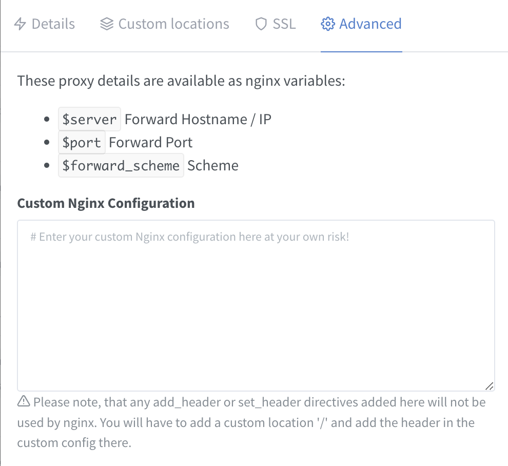

In the event this helps anyone else...
I placed FileBrowser behind NGM. My test file is 73GB. I was able to upload this file in FileBrowser without NGM but it would fail with NGM.
I noticed docker throwing a space warning. NGM was buffering the upload within the docker container.
I am now able to successfully upload my test file after adding the following Custom Nginx Configuration. Some settings might not be needed but it works and at least is a starting point.
proxy_request_buffering off;
proxy_buffering off;
proxy_set_header Host $host;
proxy_set_header X-Forwarded-Proto $scheme;
proxy_set_header X-Real-IP $remote_addr;
proxy_set_header X-Forwarded-For $proxy_add_x_forwarded_for;
proxy_max_temp_file_size 0;
client_max_body_size 0;
Did you add these to custom location or to the actual proxy files for that host?
