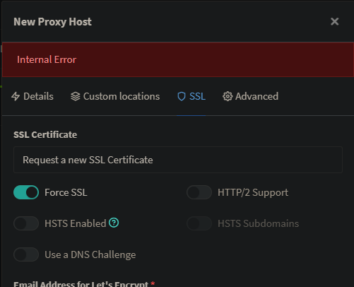

Hi, So I've been trying to force SSL on my subdomain for a proxy. I have changed my subdomain atleast 10 times. Uninstalled, reinstalled. The works. I even went as far as to completely remodeling my server lol. But for some reason itll still Shoot the same error "Internal Error" Its been driving me nuts. At the time of posting this I'll be going to bed so if any logs are needed feel free to lmk and I'll get around to it tomorrow.
Well without logs your guess is as good as mine. There is "somekind" of error!
As I now am awake and have time to upload logs attached will be said logs.

So the error is clear:
Hint: The Certificate Authority failed to download the temporary challenge files created by Certbot. Ensure that the listed domains serve their content from the provided --webroot-path/-w and that files created there can be downloaded from the internet.
You have to make sure that port 80 (with no SSL) can be reached from the outside. Please confirm that that is the case.

15 hours ago, OhShiro said:
Under the assumption that you mean that port 80 would need to be forwarded I went ahead and did that. I also forwarded 1337 as thats the port I enter when making the profile. After making these changes nothing has changed. Same error message. If I misunderstood feel free to correct me. As a note, I'm still new to all this and have no prior knowledge on what I'm doing. I'm simply following guides and learning on the way.
The flow is like this:
- you request a certificate for domain.com (by asking letsencrypt (LC) to do that)
- LC gives you a code (that is put in the .well-known dir)
- LC does a DNS request for your domain.com to get the IP
- LC connects to that domain/IP on port 80 (because: you don't have a certificate yet, so port 80 must be HTTP not HTTPS)
- LC verifies that you "own" the domain by reading the code from the .well-known dir
- LC supplies you with a certificate
In this case the error is that is cannot verify the code, why I don't know it could be any of the previous steps. But: usually your NPM cannot be accessed over unsecured HTTP port 80.

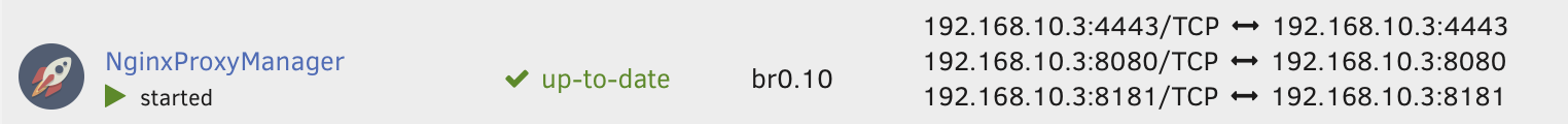

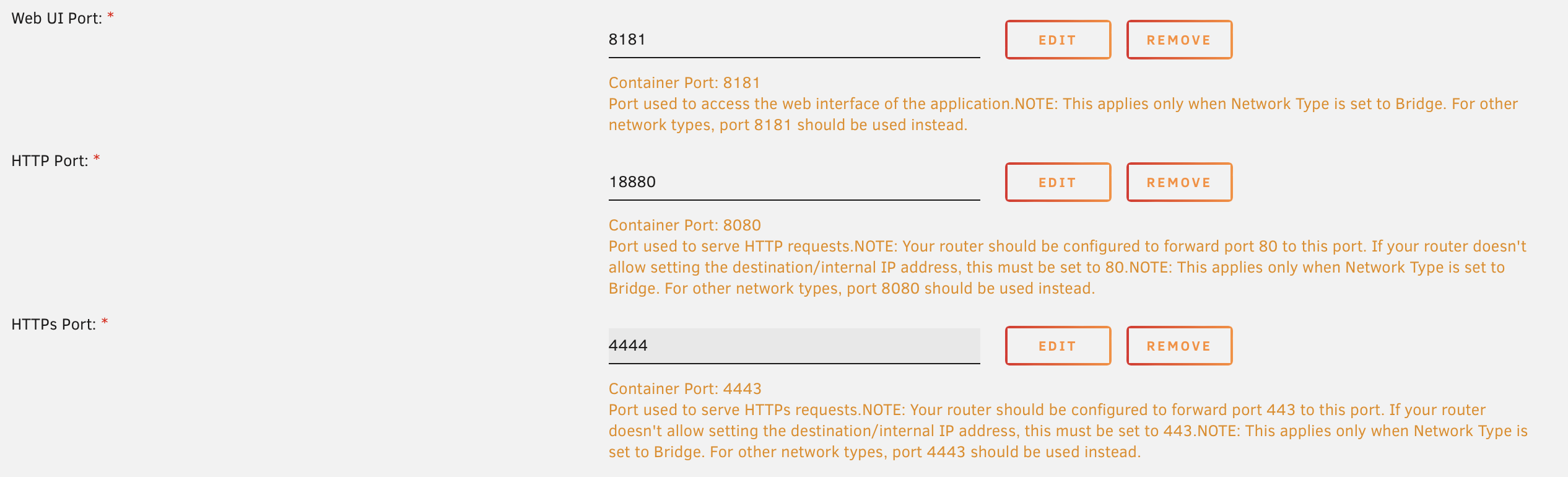

Hi Folks,
Seems I found a bug with the template.
I configured a custom port for the docker container, although it seems regardless what I configure the base 4443 and 8080 ports are used.
To repro:
  1. Install NginxProxyManager
  2. Change container ports from 8080 and 4443 to something else1331504422_Customports.thumb.png.45baa14808dc7db42f3a703081c81ee9.png
  3. Once applied, check the port mapping on the docker page1014422328_Stilldefaultsareused.thumb.png.30c7277e2abaa08f74aba206bcb8aeb0.png
It's a bit confusing for me why both sides of the port mapping has the container's IP, but my understanding is that the left port is the one that I use to access to the container while the right one is used inside the container.
Anyhow regardless what I configured in the template alway the default ports were in use and not the ones I configured.
I'm not familiar how templates are made / maintained, but I hope my explanation was good enough :)
as you seem to use custom:br0 (or host mode), so your docker has a LAN IP port mappings are obsolete ... then always the normal ports are used, only in bridge mode (shared ip from unraid host) the mappings are active.
Hi @alturismo,
Thanks for your quick reply. I was not aware of that. Thanks a lot for explaining, I learnt something new today :)
As a side note it would be more straight forward to disable the concerned port field if a non bridge mode is used. Although I appreciate that it would be a feature request and it's not related to a single container.
