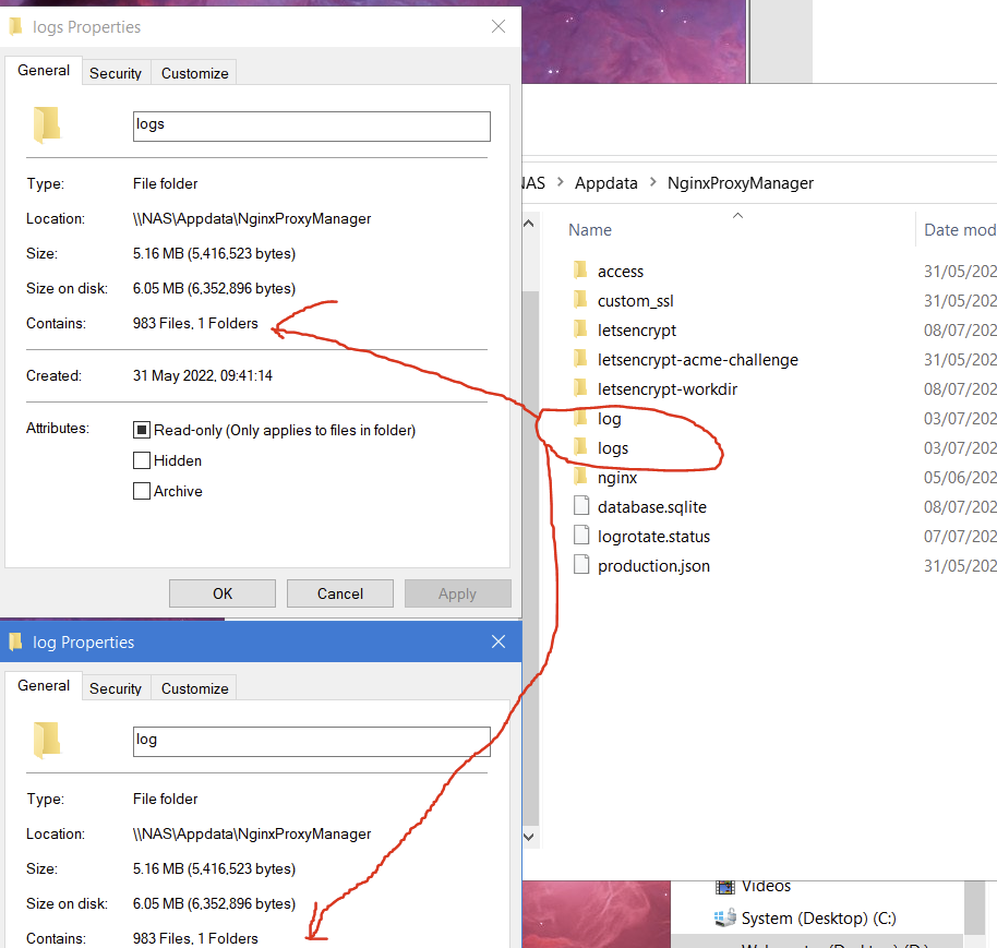

I a m intrecidble confused by the NginxProxyManager, can someone please tell my the container is writing logs to 2 paths with identical data?
In /mnt/cache/Appdata/NginxProxyManager i have 2 folders:
/Log
/Logs
Both contains 983 files, and 1 folder, both seems to be log files with identical data, whats the point of having 2 paths with the exact same data? Why is this happening?
/Log
/Logs
Yes but no :)
The `logs`  directory is a symlink to `/log`. So really just a "shortcut" to an other directory. This is a Linux thingy and it looks like it is duplicated but I can guarantee you that is is not.
If you go to your Unraid terminal to that directory and do `ls -alh`  you can see that it is simply liked and not a 'real' directory.
root@Tower:/mnt/user/appdata/NginxProxyManager# ls -alh
drwxrwxrwx 1 nobody users 3.7K Jul  3 16:10 log/
lrwxrwxrwx 1 root   root     3 Jul  4 13:17 logs -> log/
edit:
Oh and to why: I don't know, perhaps it is kept for backwards compatibility or something?

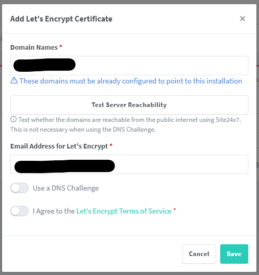

At the risk of sounding completely ignorant, I'm having trouble establishing a Let's Encrypt certificate.  I can create custom ones easily enough, but would like to have auto-renewing certs to simplify the process.  When entering my domain into the "Add Let's Encrypt Certificate" box, select "I agree to the...", and click Save, the following error shows up.  Any pointers on what I may be doing wrong.  I'm using Cloudflare to manage all DNS.
image.png.01e327eea72f8f25209cc865a1ab5a27.png image.png.cbfcb8b72ab12cc19dc1576864b1a711.png
So, does your domain point to the IP NPM is running on? Both 443 and 80?
Yes, both 443 and 80 are open.  I'm using Cloudflare to point to my public IP.  I can access all other sites using NPM using the custom cert.  I just cannot create a Let's Encrypt cert.  I'm confident it's one setting I've got off...just don't know which one that "one" is.
Edited by BigMal
updated open ports
I don't use CF. Perhaps it caches the url it uses to verify? Afaik the '.well-known' directory.
Perhaps try it without CF first?

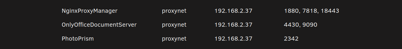

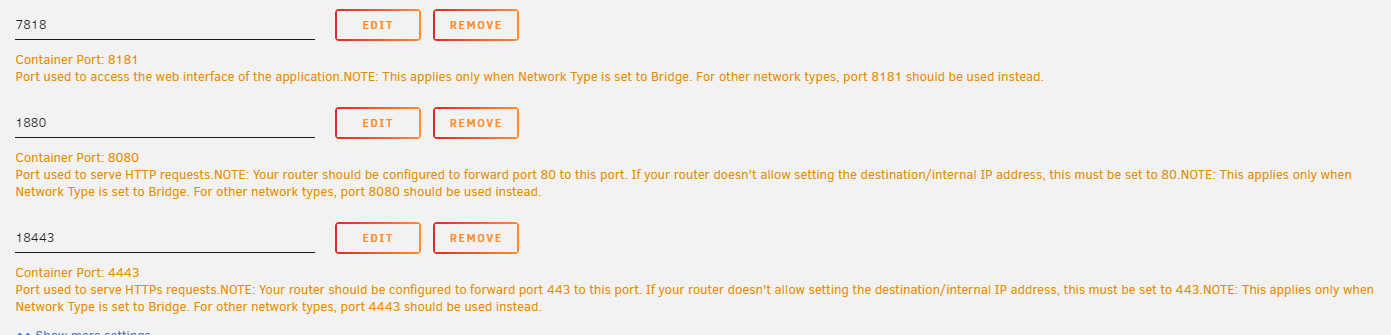

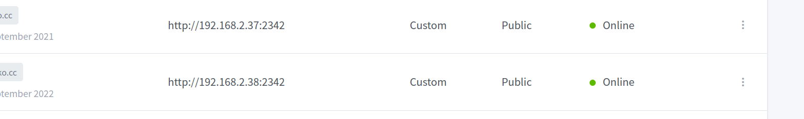

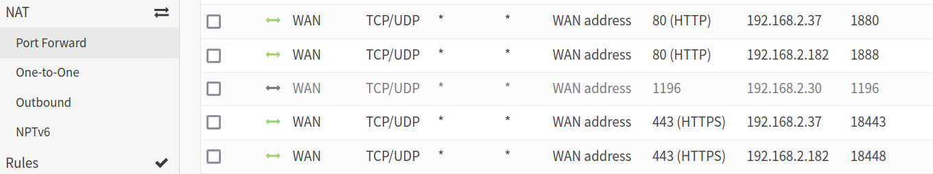

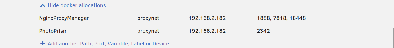

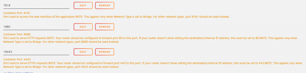

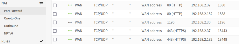

Hi,i have 2 Unraid servers and trying to install on both Npm on one of them everything works perfect but on second it works only if first one is turned off.
I change and forward ports on the second Unraid box but still get some problems and cant access the dockers.
I use OpnSense firewall .
Should i put from my modem second router so i have every unraid on different router or i dont know.
I use Godaddy thru Cloudflare.
Thank you.
Thank you.

You can't forward the same port to two different IP's on your LAN. I'm surprised your router allowed you to even enter this config.
Just do all the NPM forwarding on box1 to all the services that are on box2 with the appropriate IP's/ports.
So what I read from this is you are double NAT'ed. That's a nightmare. There should be a way you can configure your providers modem/router to operate in bridge mode. That essentially disables the built in router and allows your PFSense to act as the primary (and only) firewall/router. This should simplify managing the system and clear up a lot of port forward/conflict issues.
Thank you for the fast answer i was trying from yesterday to understand how it works.I will never try this way.Thank you again very much.
So i delete the Npm on Box 2 and delete the second forward ports on the router and now works.
So now the box 1 then should do all job then.
If Box 1 is turned off how i can setup things to work.
I need to install Npm on box 2 also with same settings but keep it OFF and if box 1 is off need to turn on Npm on box 2 because 2 Pnm cant work same time yes.
