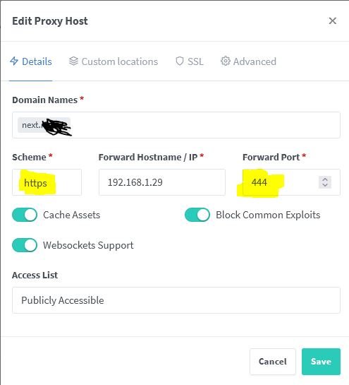

Try this.  Note that my container port is 444, not the default 443.

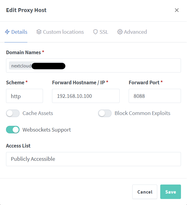

On 9/26/2021 at 9:22 AM, ShadowNovo said:
Hey there,
I've got a Nextcloud docker configured to be accessible at nextcloud.mydomain.com
This works perfectly but when I just input "nextcloud.mydomain.com" into a browser it defaults to http, even though "https://nextcloud.mydomain.com" also works perfectly fine.
How can I get Nginx to use https as default?
Changing the "Scheme" to https results in the Docker not to be accessible anymore.
Sorry if this is a rookie question but I'm trying to get this to work for an eternity now and did't find anything elsewhere using the GUI.
Thanks and greetings
ShadowNovo

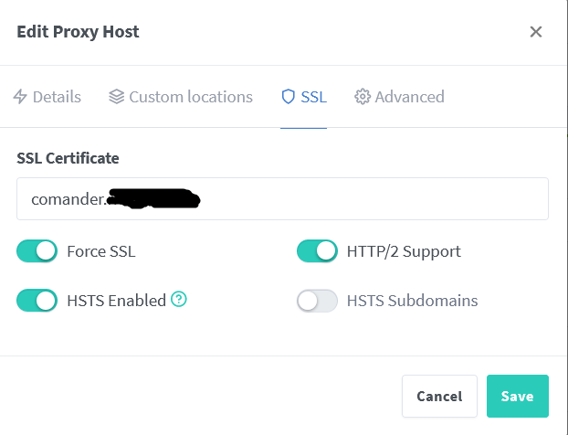

So if you look at these two pics you'll see the details tab, you need to set this to match whatever the service your trying to forward uses. so if when you open the web UI and you get to a http site you need to choose HTTP, if you open it up and it uses https you need to choose HTTPS.
It's under the SSL tab where you set up whether you want the page served to the client device as HTTP or HTTPS.
If you want HTTPS you'll need to set up a cert. I personally use the cloudflare API for a DNS challenge. I honestly don't exactly understand how all that stuff works with SSL and what not I mean yes I use it but it was a confusing worm hole for me to learn how to do it but that doesn't mean I understand how it works exactly...Feel free to send me a PM if you need help I can try to help you out the best I can. I am a noob myself but we'll make it happen.

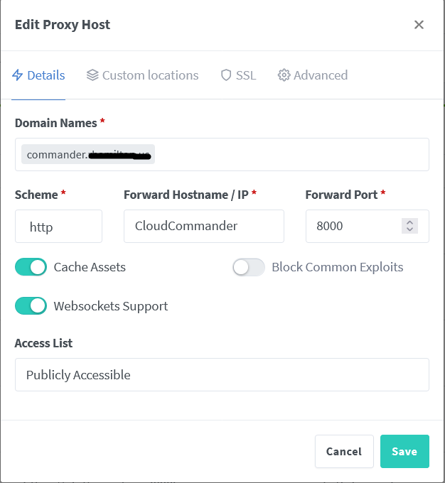

Hoping someone can help me. I have the docker up and running (bridge network) and it’s  forwarding to Unraid dockers just fine. I have 2 web apps running on separate Hyper V VM's - Hudu and HumHum. These two webapps work find when port forwarding go directly to them, however will not work when port forwarding goes to NPM. Both apps have letsencrypt SSL built in however I don't think that's the issue - it may however be another issue down the track.
I have tried;
Turning off forced SSL on NPM - HTTP2 error
With SSL turned on (NPM) - Redirection error.
Various 'custom location' configs - although I don't really know what I'm doing.
Various 'Advanced' configs - again, basically guesswork in the hope of noticing a helpful behavioral change.
Various changes to the 'default' file of Hudu
I spent weeks (or more) trying to set up a reverse proxy a year or so ago but ended up giving up so I really want to get this running. Would be great to be able to host more than one thing through a single WAN connection. I have the feeling that it's as trust issue and hoping it's a simple inclusion to each app, and not individual script each and every time.
Any help is greatly appreciated.
EDIT : Since posting this I've notice an embarrassing oversight - http vs https selection when creating Proxy Host. I now have some consistency at least - Bad Gateway on both Web Apps. Will continue trouble shooting but hope someone can swoop in and save the day with the missing piece of the puzzle.
EDIT: Thanks everyone for the help. I got it sorted. An embarrassing number of hours spent... I completely missed the HTTPS selection, and then just needed to set the port to 443 instead of 80.
I hope this helps someone else.
