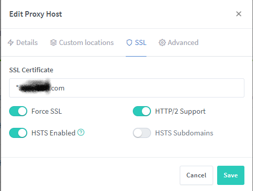

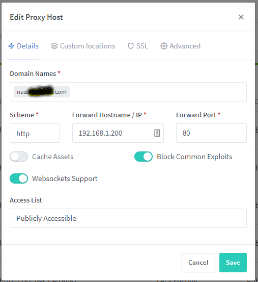

I just install NPM on my openwrt router, it works mostly fine, but I can't setup a working proxy hosts for my unraid server management page, I can setup other apps of this unraid sever just fine, like filebrowser and emby, all with Let's Encrypt ssl cert.
When setup unraid itself, I setup like this :
NPM1.png.f0312c4152df67ded00049c39dc3704a.pngNPM2.png.d288d24934405f57346c239f7e643b72.png
it won't recognize my ssl cert, it directly jump to nas.****.com/main, showing: NET::ERR_CERT_AUTHORITY_INVALID
If anyone knows the problem or solution, please help.
Thank you
And the certificate is indeed correct? With all the required intermediate certificates? Is it from letsencrypt or an other provider?
You can test your certificate with a site like ssllabs.com

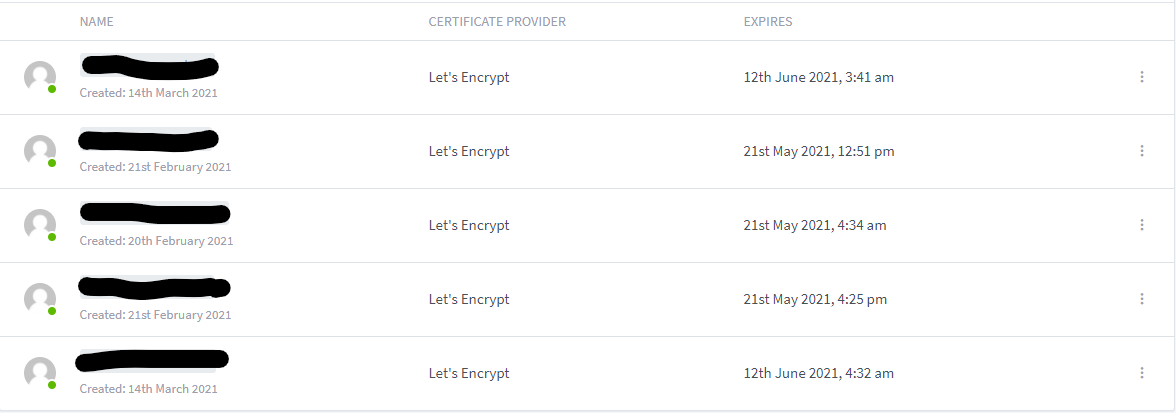

20 hours ago, mattie112 said:
Is there anything in the logs? If the certificates are "to new" it will not renew them.
[5/13/2021] [12:49:40 PM] [SSL ] › ℹ info Renewing SSL certs close to expiry...
[5/13/2021] [12:52:31 PM] [SSL ] › ✖ error Error: Command failed: /opt/certbot/bin/certbot renew --non-interactive --quiet --config "/etc/letsencrypt.ini" --preferred-challenges "dns,http" --disable-hook-validation
Challenge failed for domain xxxx.xxxx.com
Failed to renew certificate npm-2 with error: Some challenges have failed.
Failed to renew certificate npm-4 with error: Some challenges have failed.
Failed to renew certificate npm-5 with error: Some challenges have failed.
All renewals failed. The following certificates could not be renewed:
/etc/letsencrypt/live/npm-2/fullchain.pem (failure)
/etc/letsencrypt/live/npm-4/fullchain.pem (failure)
/etc/letsencrypt/live/npm-5/fullchain.pem (failure)
3 renew failure(s), 0 parse failure(s)
at ChildProcess.exithandler (child_process.js:308:12)
at ChildProcess.emit (events.js:314:20)
at maybeClose (internal/child_process.js:1022:16)
at Process.ChildProcess._handle.onexit (internal/child_process.js:287:5)
Edited by JT24
5 minutes ago, JT24 said:
Wait, the ones that are now saying 12 June said 12 May a couple of days ago.
Looks like they have auto updated, they just wait till the last minute to put it through.
I'll see what happens around 21 May.
Yes, I tested my certs with docker app running on this nas, all correct and working.
Just unraid itself won't go with NPM.

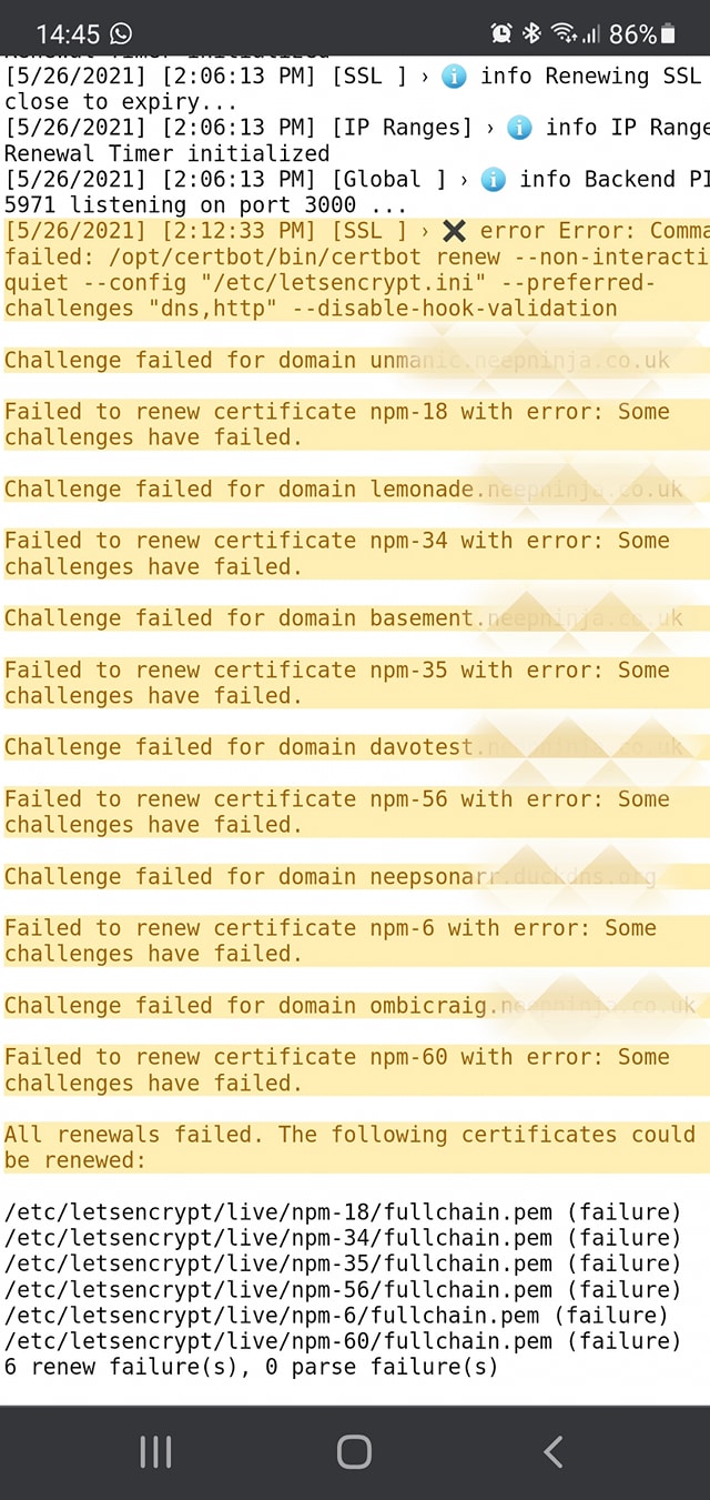

Hello, please can anyone help? I am running NPM on unraid 6.9.1 and using this container: jlesage/nginx-proxy-manager Everything has been running perfect until now. I haven't changed anyhting up until now and can't understand why none of my domains no longer work. I have posted a screenshot of the log with problems in yellow.. as these we expired or no longer used I removed tehm from NPN, and seen as they were giving me errors I removed them manually using certbot remove command but now I get errors in red (2nd screenshot)
Please help. This always happens after a few months and I have to remove the container and start again, a pain if you have over 20 hosts.
Thanks, Craig.

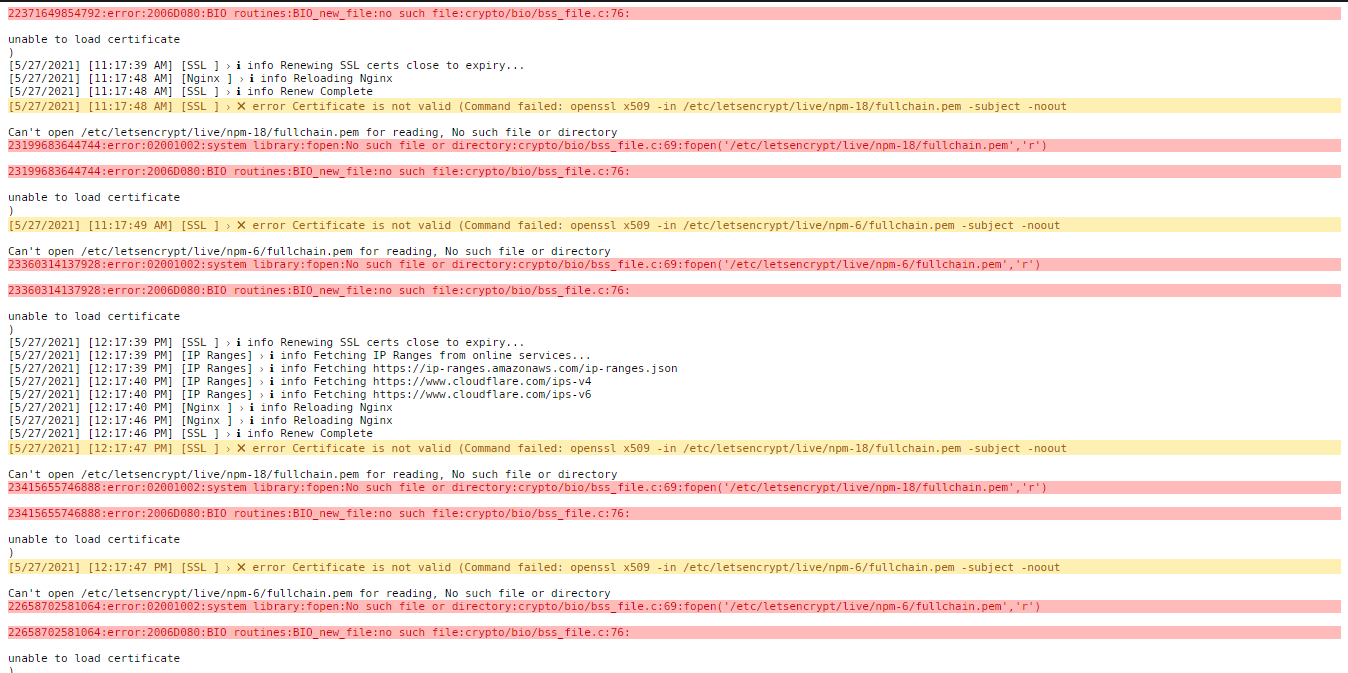

Nginx is erroring out with this repeated in logs:
nginx: [emerg] cannot load certificate "/etc/letsencrypt/live/npm-26/fullchain.pem": BIO_new_file() failed (SSL: error:02001002:system library:fopen:No such file or directory:fopen('/etc/letsencrypt/live/npm-26/fullchain.pem','r') error:2006D080:BIO routines:BIO_new_file:no such file)
I woke up to backup/restore v2 completed and no containers/vms exposed. Figured out it was nginx which shit the bed and didnt come back up after backup. Backup simply kills all containers then backs them up then starts again, therefore no changes to my config took place. I tried rolling back to v 1.16.0 with no luck.
There is no npm-26 anymore.. that was an old proxy host which is not used anymore.
Please let me know what I should do to get this up again :)
*EDIT* - I just went to the "live" folder and copied/pasted another proxy host folder and renamed as npm-26 and now it works. Seems like something is broken on the code side but this is a quick and dirty workaround.
Edited by hmoney007
