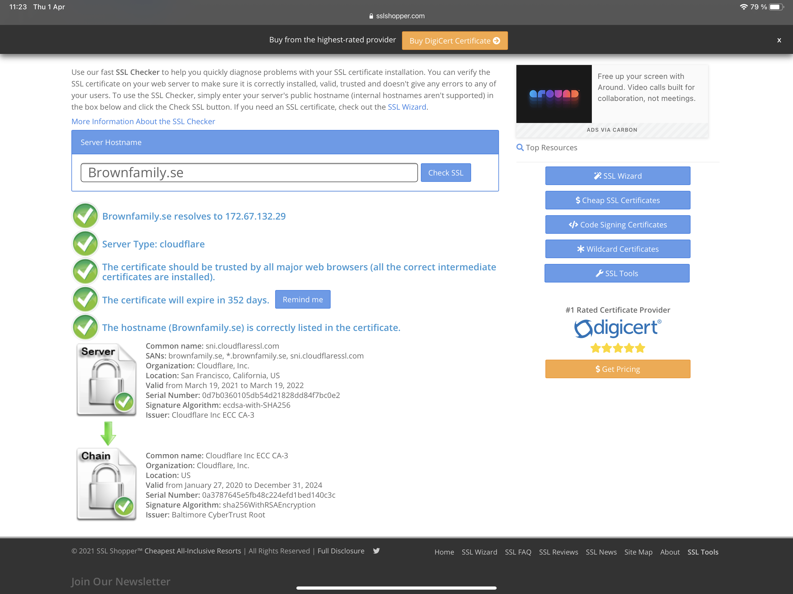

Duckdns works but my domain does not.
I want to use my domain. I have it set using ddns and the cloudflareDNS docker. The docker log shows that it is checking the ip and it hasn’t changed. But for whatever reason I can’t reach my server using the domain, sub domain or anything. Btw, I dam trying to setup nginx manager.
However if I use duckdns instead of my own domain and cloudflare is works immediately. I have been trying to get the domain to work for over a week.  The current error is -520 web server is returning an unknown error.
Would really like to use my domain and sub domains instead of duckdns.
Thanks in advance for your help.
This certificate looks good BUT it is not my origin’s certificate. Could it be this mismatch that is cause me trouble? Why isn’t it showing that certificate?
I just want to reach my server and services safely, securely, and quickly. Thanks for your help.

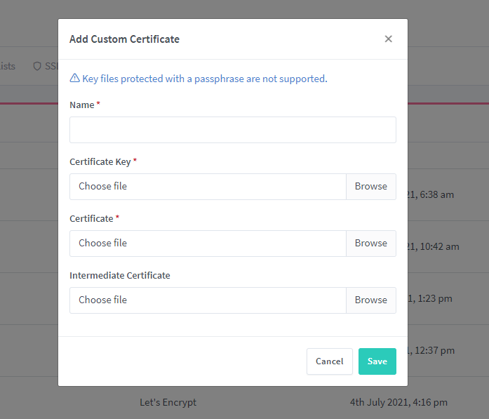

I have set up a DDNS A record and several CNAME records off the back of that on Cloudflare, inc root and www. I am able to ping them all just fine.  Is there anything else I should be looking at?
FWIW, I am able to add an origin certificate and use that for the hosts, but I would like to get the Let's Encrypt certificate working, in case I need it at some point in the future.
When I try to add the Let's Encrypt certificate, I get this error within the nginx proxy manager

Are there alternative cert solutions that will work with NginxProxyManager?
Letsencrypt is kind of a mess and almost always give me trouble when trying to get certs.
You can add your own certificates. Just buy them wherever you want and upload them in the UI:
Just don't forget you need to renew them manually.... We can also try to debug your Letsencrypt issues. I have 0 problems with letsencrypt as long as port 80 is open (it needs to do the challenges over http).
Edited by mattie112
