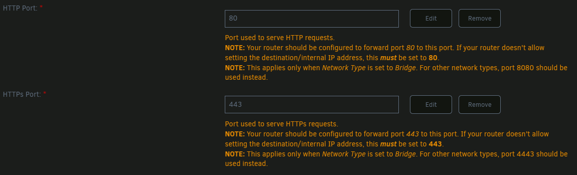

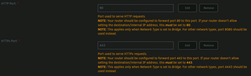

Oh, I wasnt aware that NPM doesnt support Ports 80/443 because I am able to set Its Ports in the Dockers Config:
I'm sorry what I said is not 100% correct. You can use 80/443 but then you MUST use "br0" as network. As your unraid already listens to 80 (and/or 443). By using "br0" your NPM get it's own IP.
You really only need my fork if you use IPv6 as you cannot simply forward a port there (and then the solution is to run NPM om 80/443). If you use IPv4 only then yes use br0 and have the config the way you have it.
Thanks for you explanation! I will try and see if it helps!
Although I do not fully understand, because I set Unraids Web UI to Port 180... Is there another reason it does not work with Port 80/443 on NPM in Bridge mode?
