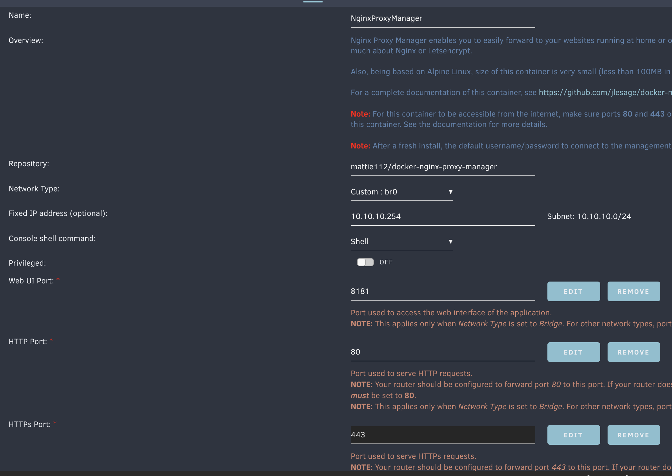

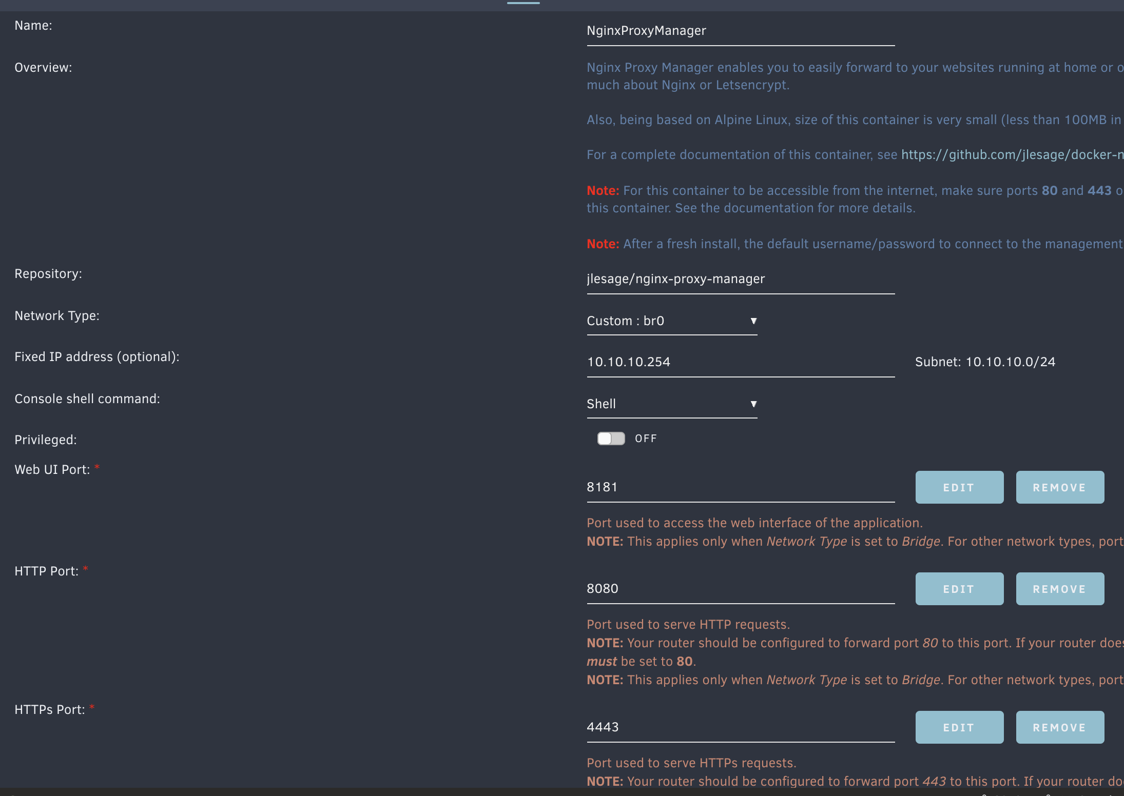

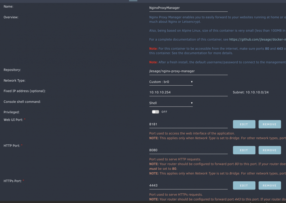

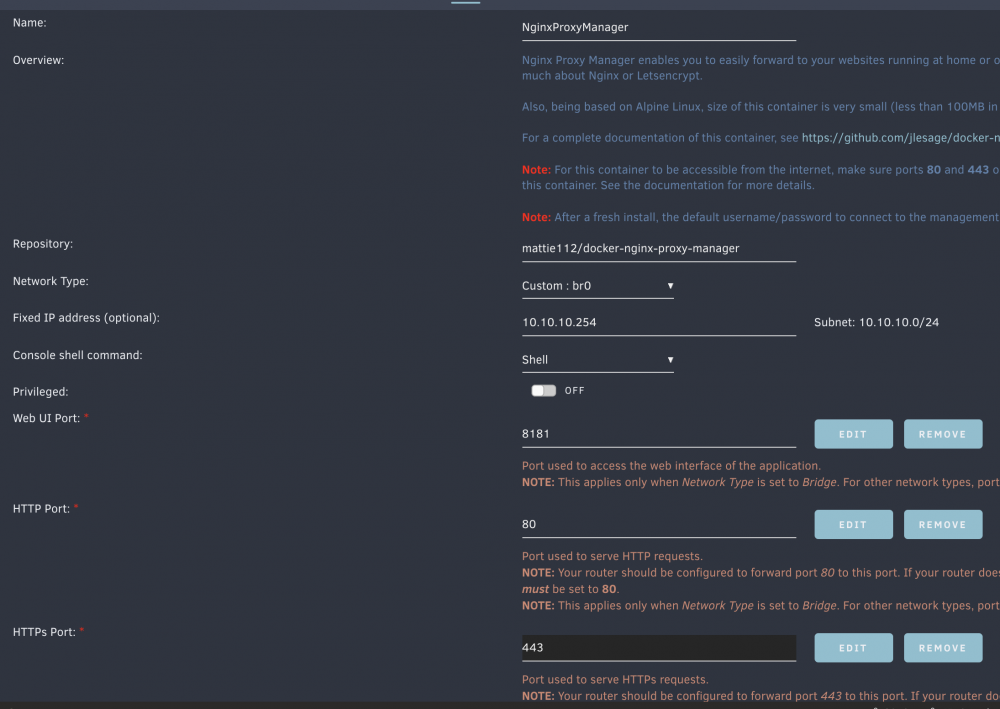

Hi again.
i didnt realize i could just use port 80/443 then host overrides on pfsense would work :)
But when i change the ports and the the docker to pull your image, it dosent work? see screenshots.
is there something more to do ?
thank you :)
Can you access 10.10.10.254:80 (and :443) internally? Or is your problem with external access? With my fork you do need to have it set to custom br0 with a fixed IP (like you have) so that should work. Or perhaps there is something in the log?
