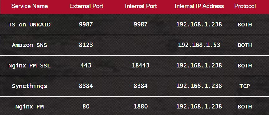

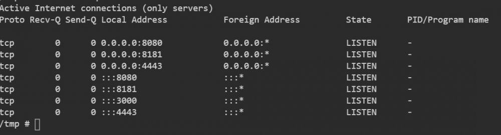

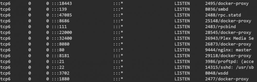

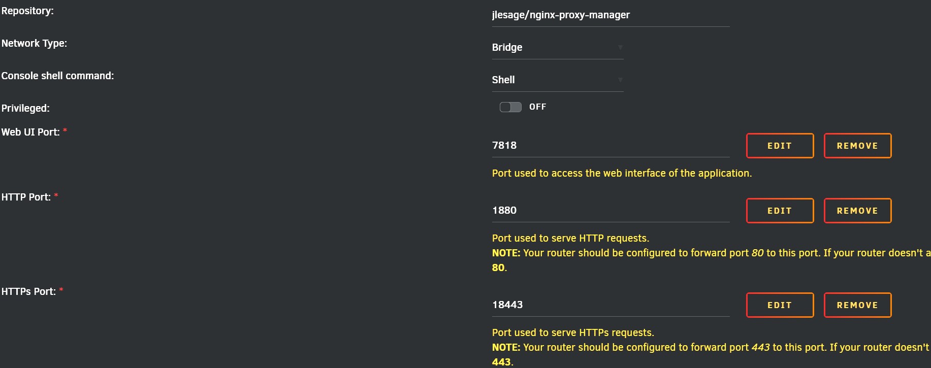

16 minutes ago, mattie112 said:
How is your setup? You have NPM to port 8080? And your router forwarded to unraid-ip:8080? Or do you have it in bridge mode?
What exactly do you want to check with nmap? To see if the correct port is open? You should be able to do `netstat -tulpn` on your Unraid. Or simply go (perferalby external) to http://your-external-ip you should see a "congratulations NPM" page, if not 80 is not forwarded/open and then letsencrypt won't work. Perhaps your provider blocks 80? But yeah if for any reason you only have 443 you can still manually add DNS certificates and those should work.
(or try out the letsencrypt DNS based verification but I have no experience with that so I have no idea how that works)
NPM container settings:
Router forwarding:

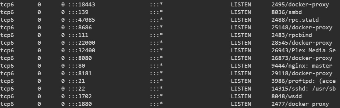

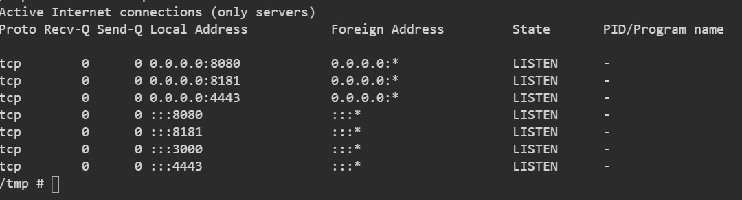

netstat from within NPM container:
netstat from Unraid:

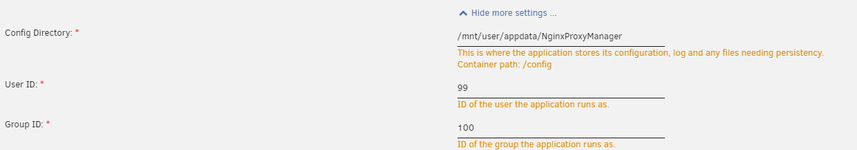

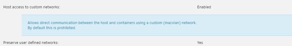

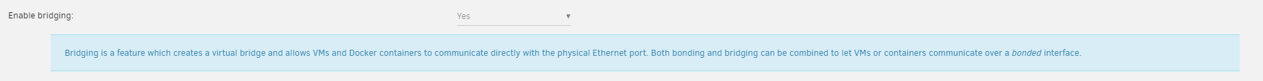

Do you have these settings?
In network:
In docker:
In network:
In docker:
Not the docker one.
Is it needed?
I think it was needed for when a bridge network is used. You can try it at least to see if it solves your problem? Than at least we know.
