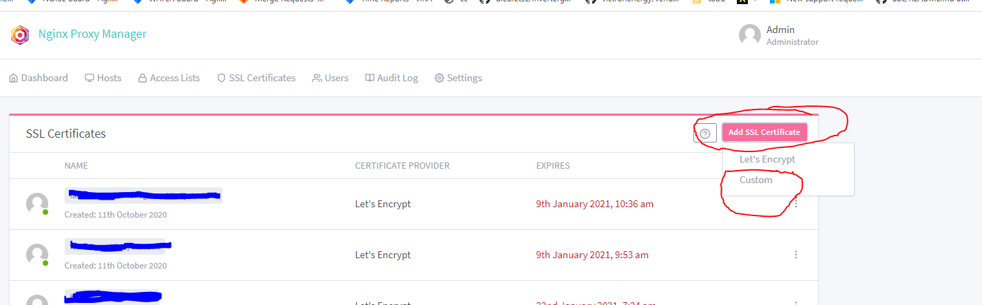

Why is there no option to add a custom ssl certificate? There is only option to either not use ssl at all or use builtin lets encrypt. Nginx Proxy Manager supposedly supports this.
You can add a custom SSL certificate. I use this feature for Cloudflare origin certificates all the time.
On the SSL page, choose 'add certificate', then choose 'custom'. You'll need to supply the required files. I assume you know how to do this if you're trying to use your own certificate.
@Foxglove when I click "Add SSL Certificate" I don't have an option to add custom, it just goes straight away to Let's Encrypt.
There should be a dropdown, perhaps try an other browser?
Lmao the "Add SSL Certificate" button on the center isn't the same as the one in the upper right corner. The one in the center which I was clicking was taking me straight to lets encrypt, only the one in the corner has the dropdown.
