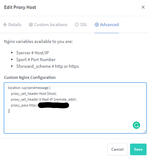

As it basically is just Nginx you can look into:
https://docs.nginx.com/nginx/admin-guide/web-server/reverse-proxy/
For example:
location /some/path/ {
    proxy_set_header Host $host;
    proxy_set_header X-Real-IP $remote_addr;
    proxy_pass http://localhost:8000;
I did not test it but I assume you can use this in the advanced config part

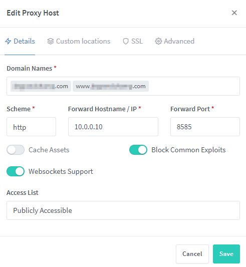

That is similar to what I have attempted. For the sake of sanity, I modified the path, address, and port and put it in. I can confirm that it is using the location under the advanced tab as I can break it. However, I am still only seeing the IP of the proxy when I connect to the webserver. If I connect to the webserver directly, I do see the IP of the host I am connecting from.

1. (My most important for now) is it possible to get mydomain.com/plex working as a custom location instead of a subdomain (This is for Organizr SSO with Plex, which requires a /plex location and NOT a subdomain.
2. What exactly is caching of assets doing.
3. When would you NOT want Websockets, blocking of common exploits, and HTTP/2 enabled?
4. HSTS Seems like overkill for a lot of services, am I wrong on this?
Thank you in advance!

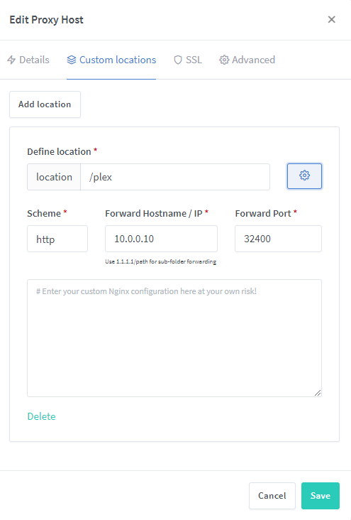

You can add your TLD example.com and under custom locations point it to /plex.
Ok so I have my TLD domain.com pointed to organizr, and then adding /plex like this doesn't work.
And then under custom locations, plex is on 32400 for me FYI
Then when I try to go to domain.com/plex I just get...

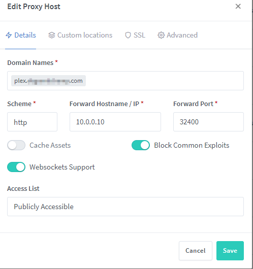

I would also *need* just domain.com/plex to work, I already have plex.domain.com but plex.domain.com/plex/ wouldn't work with Organizr's SSO authentication anyways from my understanding?
Also my local plex is HTTP via docker container, but once it's reverse proxied via NPM it would be at https://domain.com/plex, if it would work without the 401 error.
Also even if I try to setup plex.domain.com/plex I still get the same 401 error...
Main plex.domain.com entry
then the custom location
Still results in
It's hard to imagine I'm doing something that wrong since there's hardly any settings to speak of.

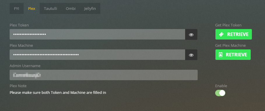

@CorneliousJD  I think I finally, through troubleshooting, figured out a fix that will work for your environment.
In you Organizr SSO Setup point it to the local IP/Docker IP of plex.   http://IP:32400/plex    I was digging in my sso settings and any local comm's go through these on my setup, only externally clickable links etc do not.

Plex SSO doesn't have that type of setup though.
The reason I'm trying to get this setup is because SSO for Tautulli and Ombi work just fine (they point to local dockerIP:port like you mentioned) but Plex does not, there's no option to do that.
Also see here: https://docs.organizr.app/books/setup-features/page/sso#bkmrk-plex
Specifically the part that mentions
Plex SSO doesn't work if Plex Reverse Proxy is a subdomain
To setup a /plex Reverse Proxy in Nginx, setup the location block
